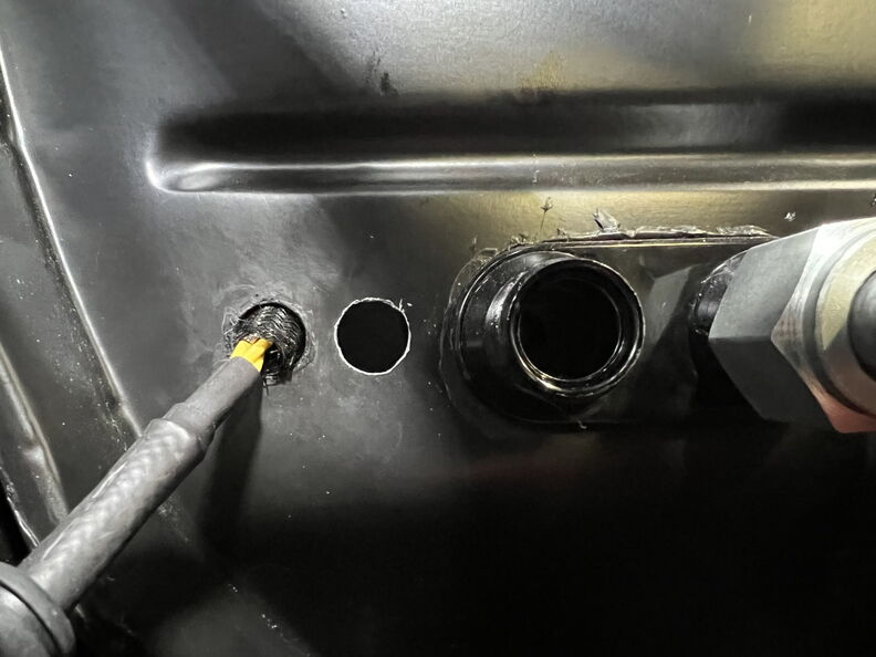

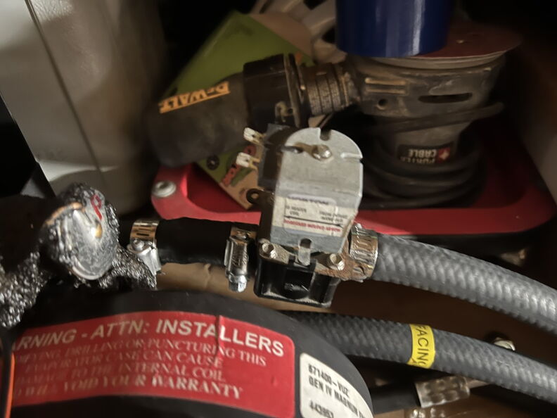

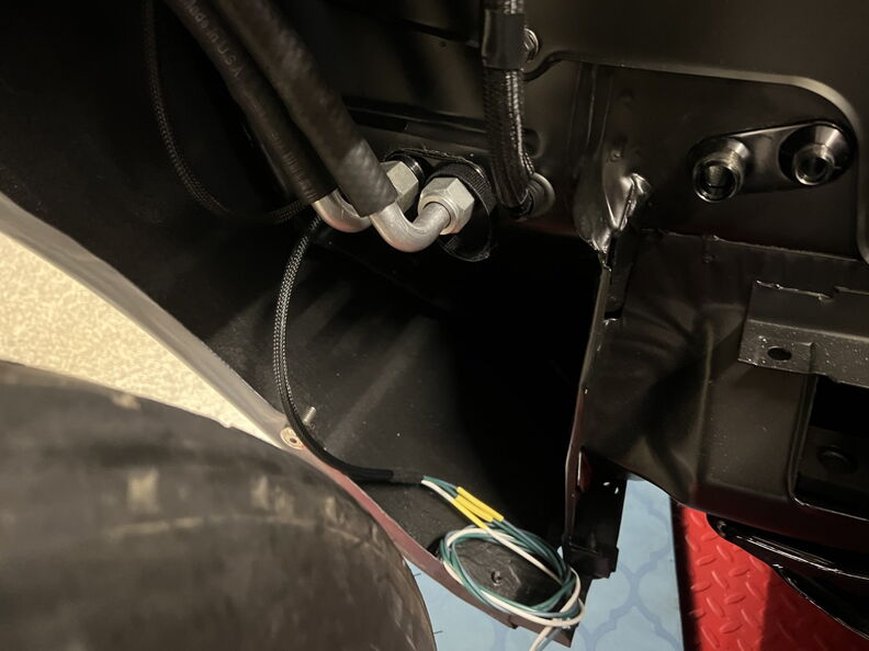

Final Install of the Vintage Air Valve Relocation ( 05-08-22 )

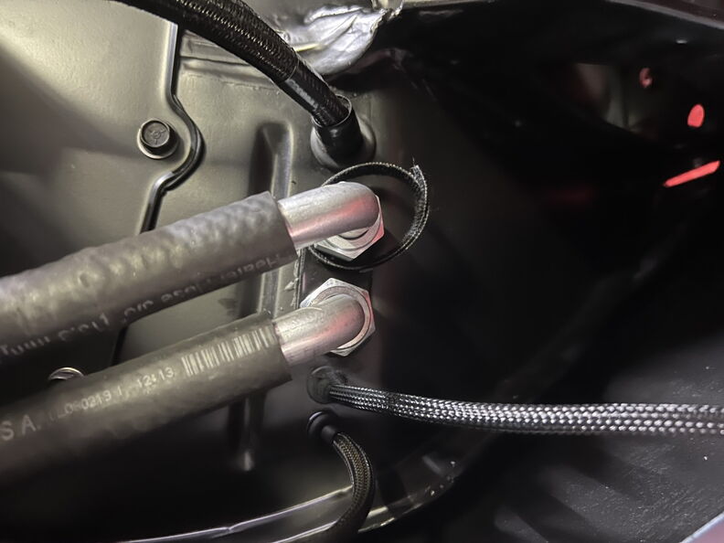

Next up is the installation of the Vintage Air unit and relocating the valve to the inner fender so it will be easier to service if needed.
So up to the garage attic I go and it's starting to empty.
http://garagescene.net/_data/i/uploa...a00e5db-me.jpg
This is the valve I will be relocating.
http://garagescene.net/_data/i/uploa...7a37799-me.jpg

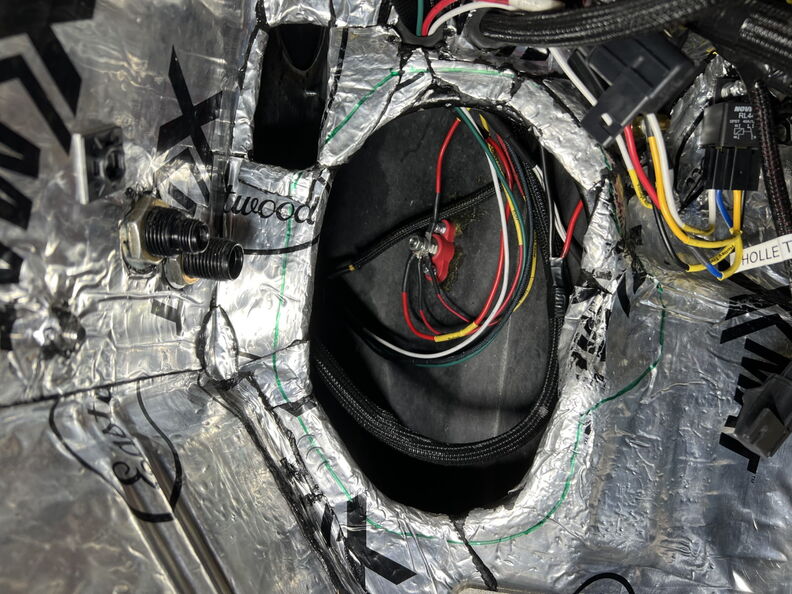

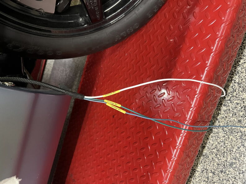

Since the valve was located in the interior I need to extend the wires out to the inner fender.
I need to enlarge the middle hole to 1/2" so somehow I was able to make a close to perfect circle with a dremel tool.
http://garagescene.net/_data/i/uploa...2170fce-me.jpg
My buddy Jimmy stopped by to check on the progress and show me the new exhaust he built.
http://garagescene.net/_data/i/uploa...f5d9d1f-me.jpg
Mocking things up.
http://garagescene.net/_data/i/uploa...22efa76-me.jpg
http://garagescene.net/_data/i/uploa...7b0c101-me.jpg
Making things pretty.
http://garagescene.net/_data/i/uploa...1fd0437-me.jpg
http://garagescene.net/_data/i/uploa...f4e06a6-me.jpg

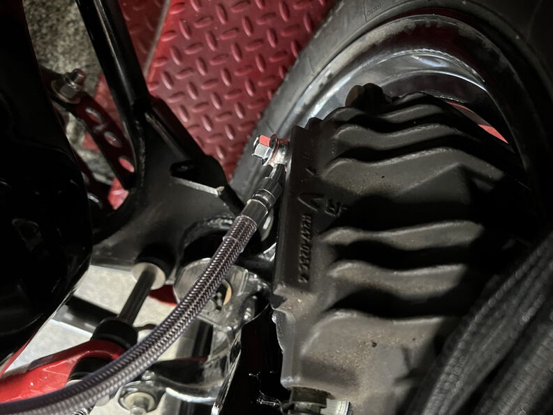

Kore3 Stainless Brake Lines ( 05-14-22 )
About a year ago Tobin from Kore3 Brakes sent me the new brake lines and I finally decided to install them.
http://garagescene.net/_data/i/uploa...95ffcde-me.jpg
http://garagescene.net/_data/i/uploa...c27fd91-me.jpg

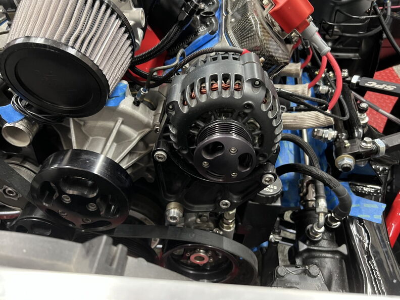

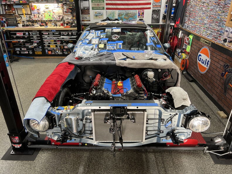

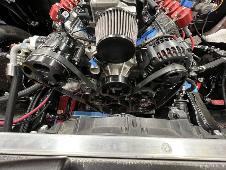

Wagner Front Drive Opps I forgot a bolt ( 05-14-22 )
Back at it.
http://garagescene.net/_data/i/uploa...4465642-me.jpg
So this note has been haunting me for a long time and today I finally decided complete the job. Apparently, I forgot to put one bolt in
and I am certain this is a much bigger project then it needs to be as I am certain stuff is going to be in the way.
http://garagescene.net/_data/i/uploa...d829ffd-me.jpg
I took this picture for reference purposes as I am certain I won't be able to remember the belt routing.
http://garagescene.net/_data/i/uploa...7eca06a-me.jpg
I was hoping that all I needed to do was remove the Alternator & bracket. Unfortunately, I was wrong...
http://garagescene.net/_data/i/uploa...e7240f6-me.jpg
and here is the missing bolt
http://garagescene.net/_data/i/uploa...9c75c4b-me.jpg
Well it looks like more stuff needs to come off.
http://garagescene.net/_data/i/uploa...548707c-me.jpg
Thankfully the intake manifold has yet to be bolted on.
http://garagescene.net/_data/i/uploa...5b36a75-me.jpg
http://garagescene.net/_data/i/uploa...383c96b-me.jpg
http://garagescene.net/_data/i/uploa...e86e3d2-me.jpg
All better.
http://garagescene.net/_data/i/uploa...0aaf00c-me.jpg

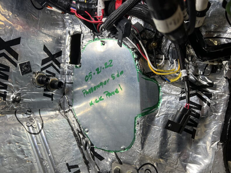

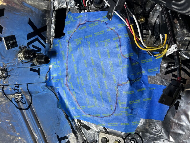

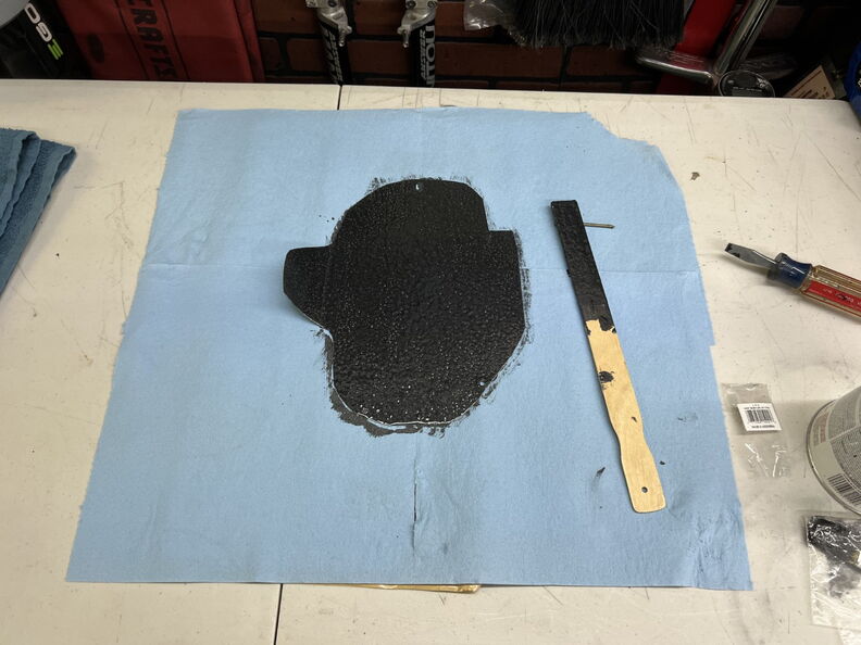

Passenger Side Kick Panel Close out ( 05-21-22)
These are the project that I like doing.
The blue tape is back and you all know how much I like blue tape. I used multiple layers of tape so I would have a very
sturdy template. After I removed it I laid it on a thin piece of E-Flute corrugated with the Flutes in the vertical direction.
As this would allow the bend that I was to have to make to fill the hole in the front.
http://garagescene.net/_data/i/uploa...1a31b3c-me.jpg
I roughly sketched the outside that I felt would cover the hole.
http://garagescene.net/_data/i/uploa...11d95ca-me.jpg
http://garagescene.net/_data/i/uploa...f90cec7-me.jpg
You can see that it folds nicely when the flutes are correct orientation.
http://garagescene.net/_data/i/uploa...4a46da8-me.jpg
http://garagescene.net/_data/i/uploa...7fd6bd2-me.jpg
Here is my cut template
http://garagescene.net/_data/i/uploa...afe6d8c-me.jpg
http://garagescene.net/_data/i/uploa...cfbf67a-me.jpg
I wish I would have take a few pictures of the stud that I mounted which hands the closeout panel. Eventually there will
be a nut and washer holding it on. You can also see I added two sheet metal screws to keep the panel from moving.
http://garagescene.net/_data/i/uploa...0ee0fbe-me.jpg
Hardware that was purchase.
http://garagescene.net/_data/i/uploa...ab42766-me.jpg
I painted the back side first as this will allow me to flip it and paint the front in an hour or two.
http://garagescene.net/_data/i/uploa...e8896e0-me.jpg
Jimbo1367 06-24-2022 12:07 AM
Very nice. What did u use to “paint” the panel with? ITT looks like a bed liner coating .
Thanks,
Jimbo
Mikael A 06-24-2022 12:10 PM
Looking good like always 👌
syborg tt 06-24-2022 12:46 PM
1 Attachment(s)
Thanks,
Jimbo
Hi Jimbo,
Good old Rust-Oleum Hammered Black no primer needed.
Jimbo1367 06-25-2022 06:45 AM
Syborg TT,
Thanks for the reply. Have u used this before? If so, how durable is it? It looked really good IMHO
syborg tt 06-25-2022 09:13 AM
Originally Posted by Jimbo1367 (Post 719273)
Syborg TT,
First time using it and I hope it works. The good news is this surface won't see any weather so it should hold up quite well.
Jimbo1367 06-27-2022 12:10 PM
Yeah, that’s true. (No weather) thanks man
