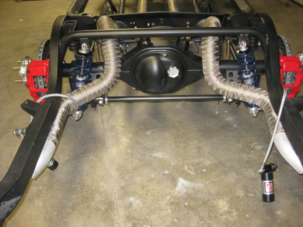

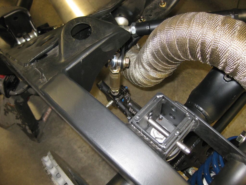

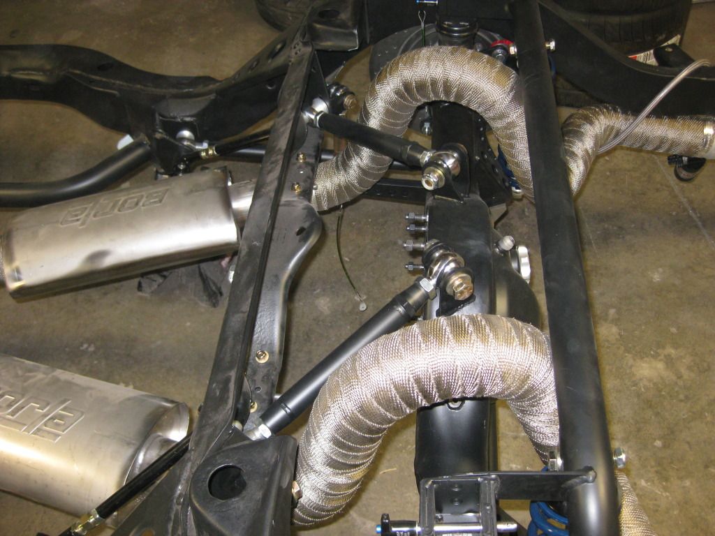

How do you like my jounce bumpers Scott?? lol, Tony took them off my car to get you a set quicker :lol: Still need to get my replacements.
Amazing how similar our chassis look out back. I too am perplexed on mounting the rear Ridetech canisters. I considered the trunk drain holes, but I'm concerned about the proximity of the exhaust tubing, kinda goes right under there. The wrap will help for sure :thumbsup:
I'm thinking about mounting them up on the rear frame rails under the car. Should be safe there.
Do you have a notched fuel tank or did you squeeze the pipe thru?

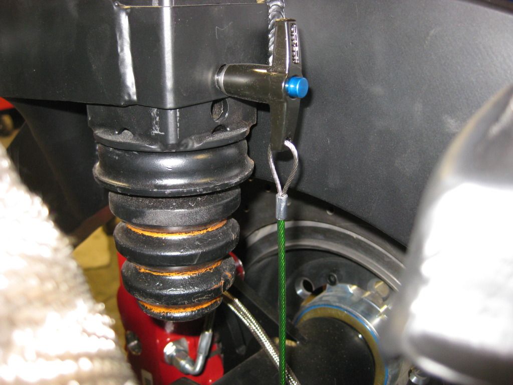

Just curious what the reasoning is for adjustable (particularly with quick-pins) bump stops? Is it so that no matter what ride height setting the coilovers are mounted at, the coilovers never end up being the bumpstop at full compression?

coolwelder62 02-07-2013 09:46 AM
Originally Posted by HEEP (Post 462992)
What size of tubing are you using on the exhaust? Looks like about 4". That setup looks really good on the rear frame section. Are you pleased with the ABC setup?
By the way, loving this car. I've been following along seeing the little things you have added. I especially like the way you are making everything adjustable with the pins.
HEEP
Thank's,the ehaust tubing size is 3",Abc frame part's fit pretty good.Using the ajustable pin's will speed thing's up when are at the track making ajustment's.

Will see on canister mounting after the body mounting is complete.Fuel tank is not notched,just stuffed the tubing up in there,til it fit.:lol:
Nice work!
joe
:thankyou: for the nice word's.The quick pin's on the bump stop's will make it easy to ajust or remove if need be.Won't know where they need to be until we get a chance to drive the Junk down the road.:thumbsup:

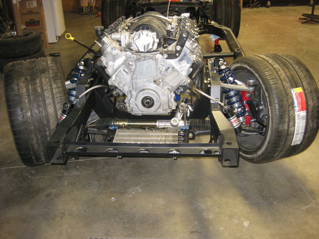

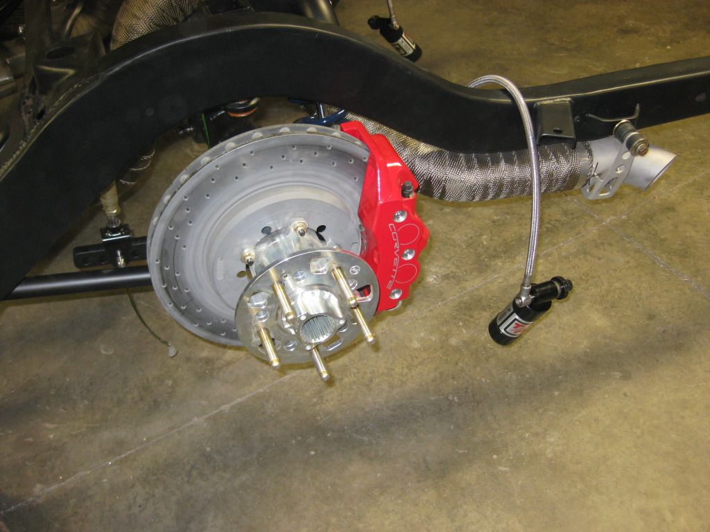

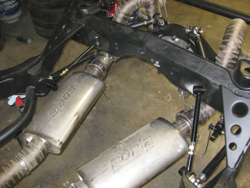

coolwelder62 02-07-2013 07:03 PM
http://i1104.photobucket.com/albums/...ps8d0878d2.jpghttp://i1104.photobucket.com/albums/...ps4d18dd3d.jpghttp://i1104.photobucket.com/albums/...ps2ae90152.jpghttp://i1104.photobucket.com/albums/...pse0e760ac.jpg
Flash68 02-07-2013 07:06 PM

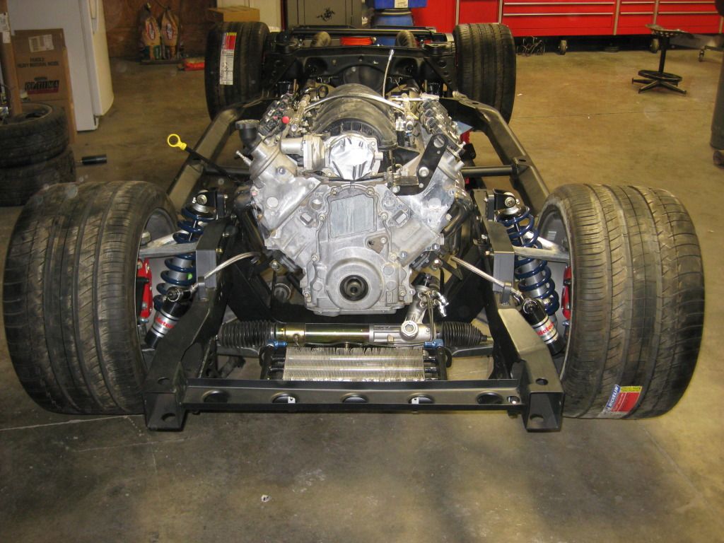

Scott, that is lookin great, man. :thumbsup: Killer with those steamrollers up front.
GregWeld 02-07-2013 07:22 PM
I want to see those fronts turned lock to lock.....
:D

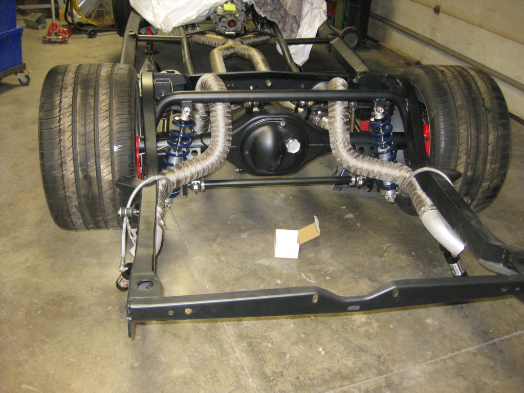

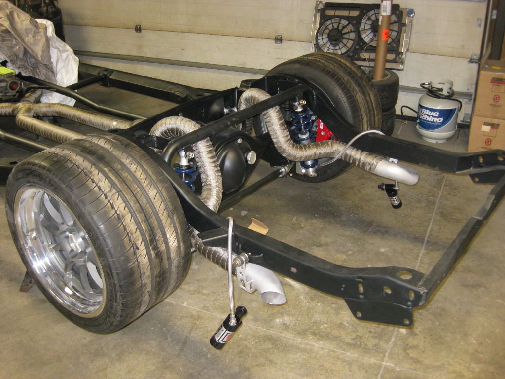

coolwelder62 02-07-2013 07:40 PM
:D
http://i1104.photobucket.com/albums/...ps979d7809.jpghttp://i1104.photobucket.com/albums/...psb834b04e.jpgI need to leave the chassis on the stand's a few more days to finish up sutff from the bottom side.After that I will get some shot's of the chassis on the ground.:relax:
