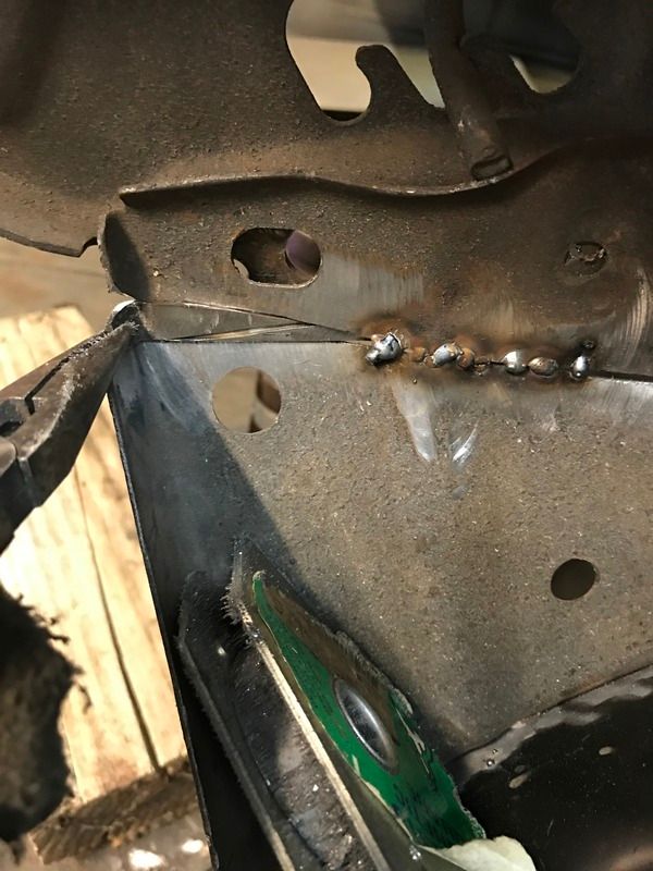

Needed to set up the trunk hinge brace when I cut it out.
http://i115.photobucket.com/albums/n...pserhp0fbd.jpg

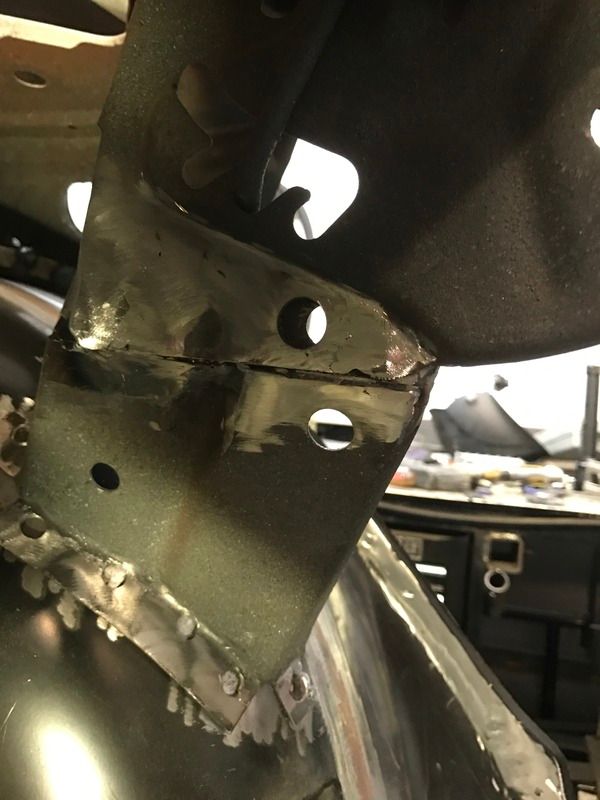

HEEP 01-15-2017 04:55 PM
So got the trunk hinge brace welded back together and in.
http://i115.photobucket.com/albums/n...psxdbb7dpe.jpg
Filled in a gap between the trunk pan and the inner fender
http://i115.photobucket.com/albums/n...psdz6gpteg.jpg
