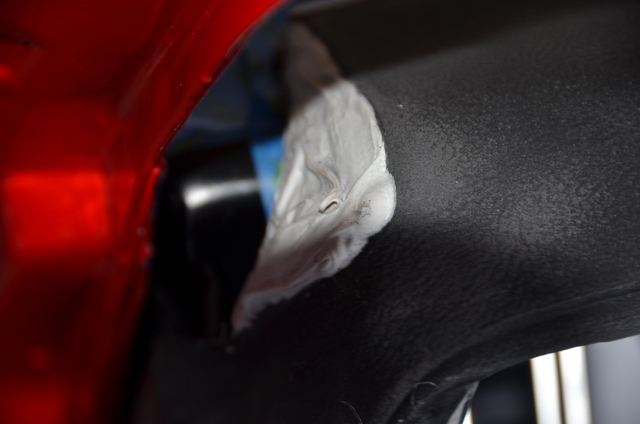

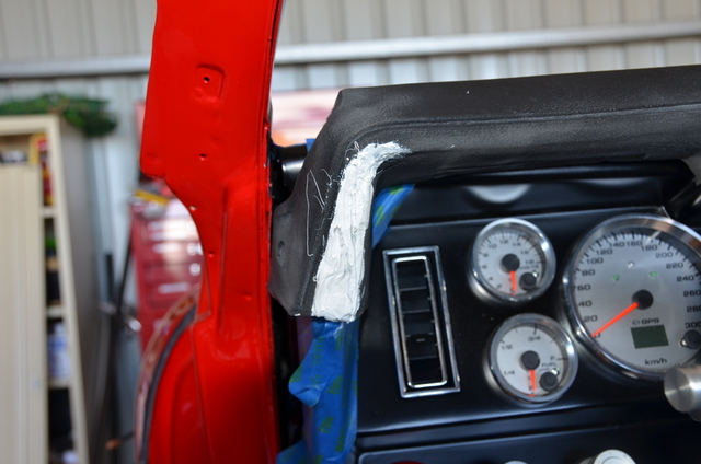

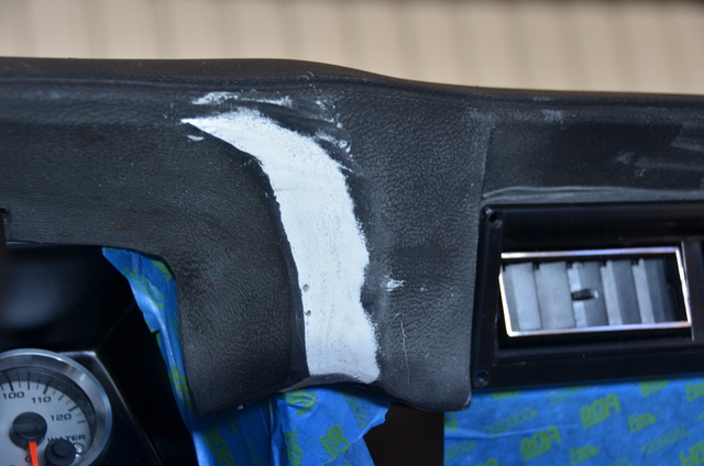

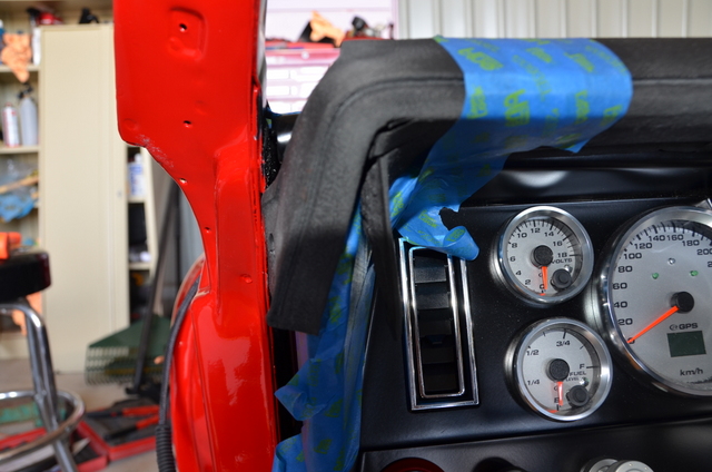

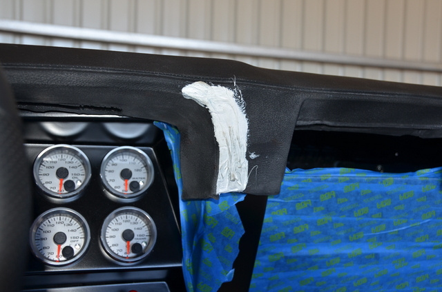

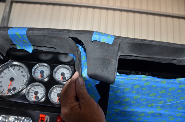

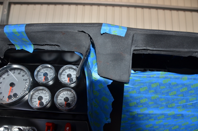

I have been working on the dash pad, what a piece of $hitt. If there is one part I hate in a 69 Camaro it's the dash pad.
I have had all sorts of problems with the fit up to the DSE dash, I am not sure if the pad is the problem or the dash.
So I have made it fit, it will be covered in leather so it should come out fine.
First I cut it up, then I filled it and shaped it with Sika Flex.

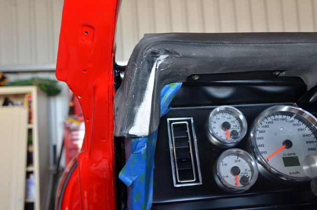

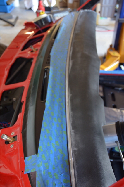

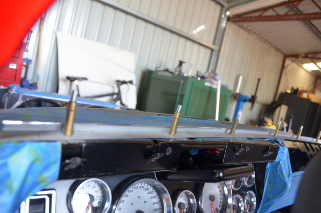

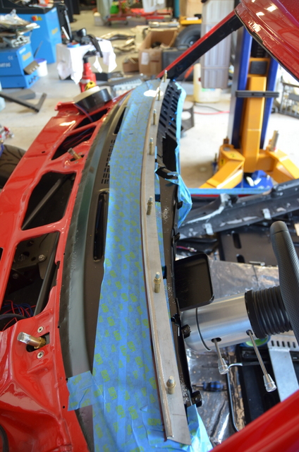

My other big hate it the waviness on the leading edge of the dash pad as it's held down by about 8 clips. I had the boys at Rowe & Sons make me up a leading edge from metal, to hold it nice and straight.
Attachment 42746
Attachment 42747

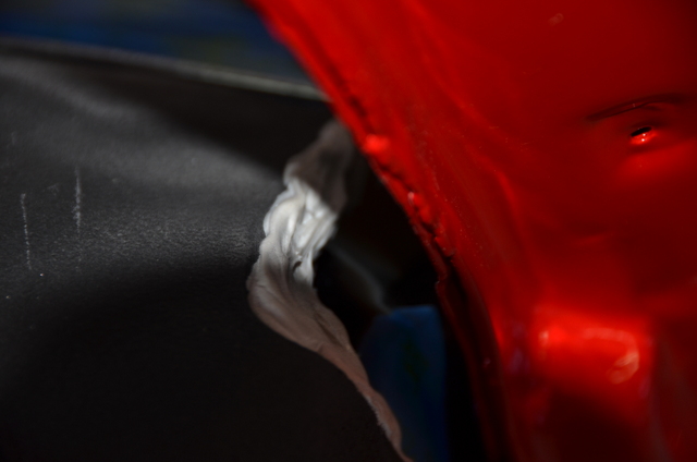

Now working on building out the area's around the A pillars, another terrible fit.
Attachment 42749
Attachment 42750

Greg a lot of this aftermarket stuff is just garbage. That's a lot of work to make something fit but the end result will be perfect!:bow:

Sika Flex is bad ass stuff… always used the various "adhesions" on the boat. The strongest will rip fiberglass in two before it lets go.
