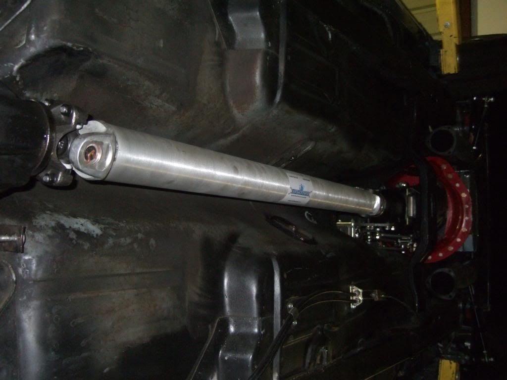

Long story short on the new 3" aluminum driveshaft I got recently... bought a new/2nd hand shaft on ebay for $200 in the length I thought was dead nuts what I needed, but I failed to account for the larger 1350 pinion yoke, so was going to get it shortened 1/2" (at the tune of $125) to make the trans yoke hit its target slip of 3/4"... driveshaft guy says we dont have a 1350 pinion u-joint, as I was told by seller, but instead it's a 1330/3R conversion u-joint... first I am kinda pissed, but then realize because of this the 1330 pinion yoke is shorter than the 1350 and that makes my driveshaft perfect length and hits my 3/4" slip target as I had previously thought. And the 1330 pinion yoke I needed is a little cheaper than the 1350 yoke I just bought (1350 is an overkill upgrade for what this car is doing anyway). Things were just fine with my old 1310 yoke/u-joints. Okay not so short of a story but it had a great ending and I wanted to share. :thumbsup:
http://i236.photobucket.com/albums/f...8/DSCF3707.jpg

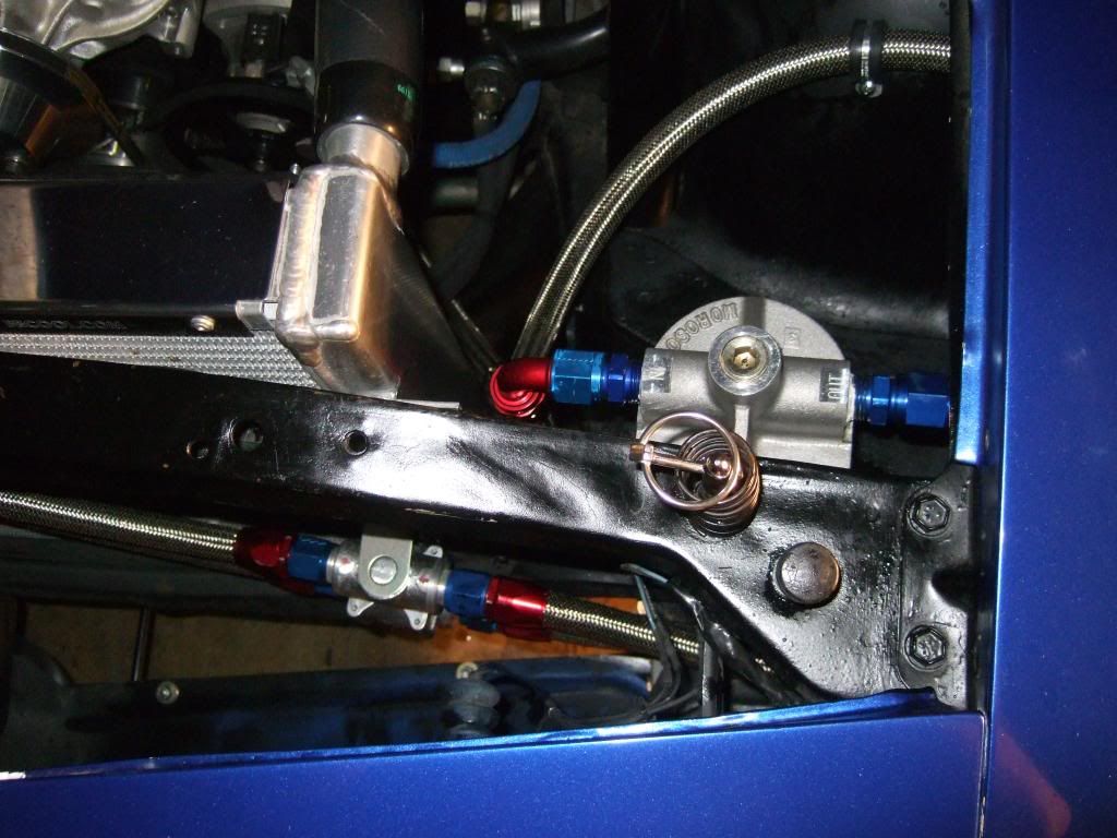

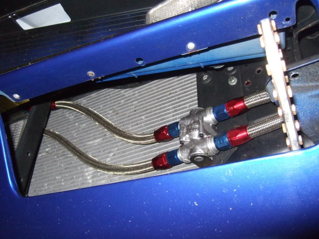

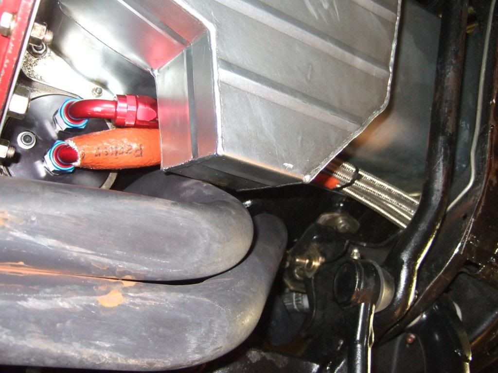

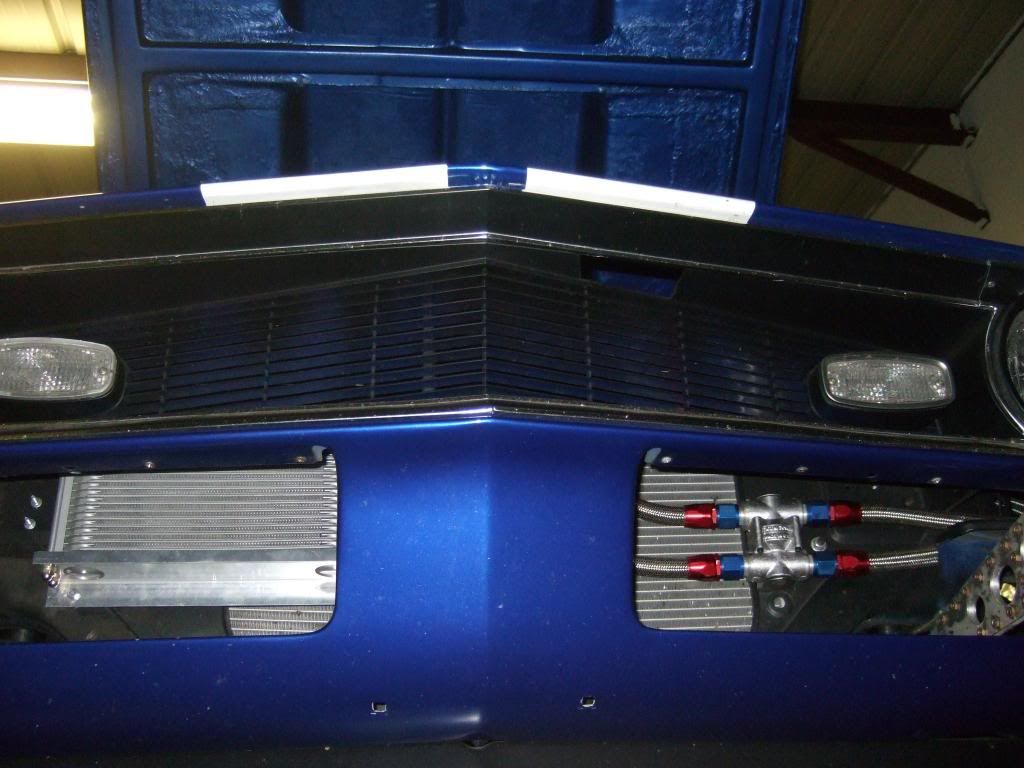

Got the oil cooling system finished and buttoned up consisting of a good sized Earl's cooler, Mocal 180* thermostat, 17 feet of Aeroquip -10AN stainless hose, 10 fittings, and Moroso remote oil filter system. Fired up the motor and it ran like a champ and got up to proper temp and pressure. First time I'd heard the kitten purr in almost 3 months. :unibrow:
The system added just under 2 quarts to the total amount of oil being used.
http://i236.photobucket.com/albums/f...8/DSCF3718.jpg
http://i236.photobucket.com/albums/f...8/DSCF3721.jpg
Very tight fit.

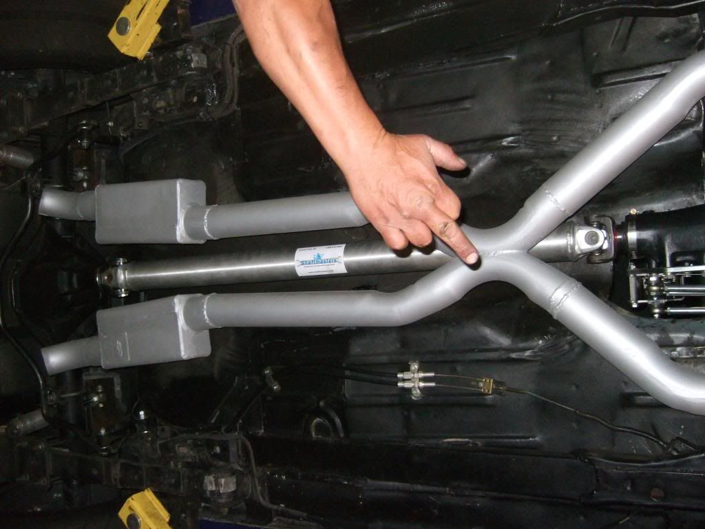

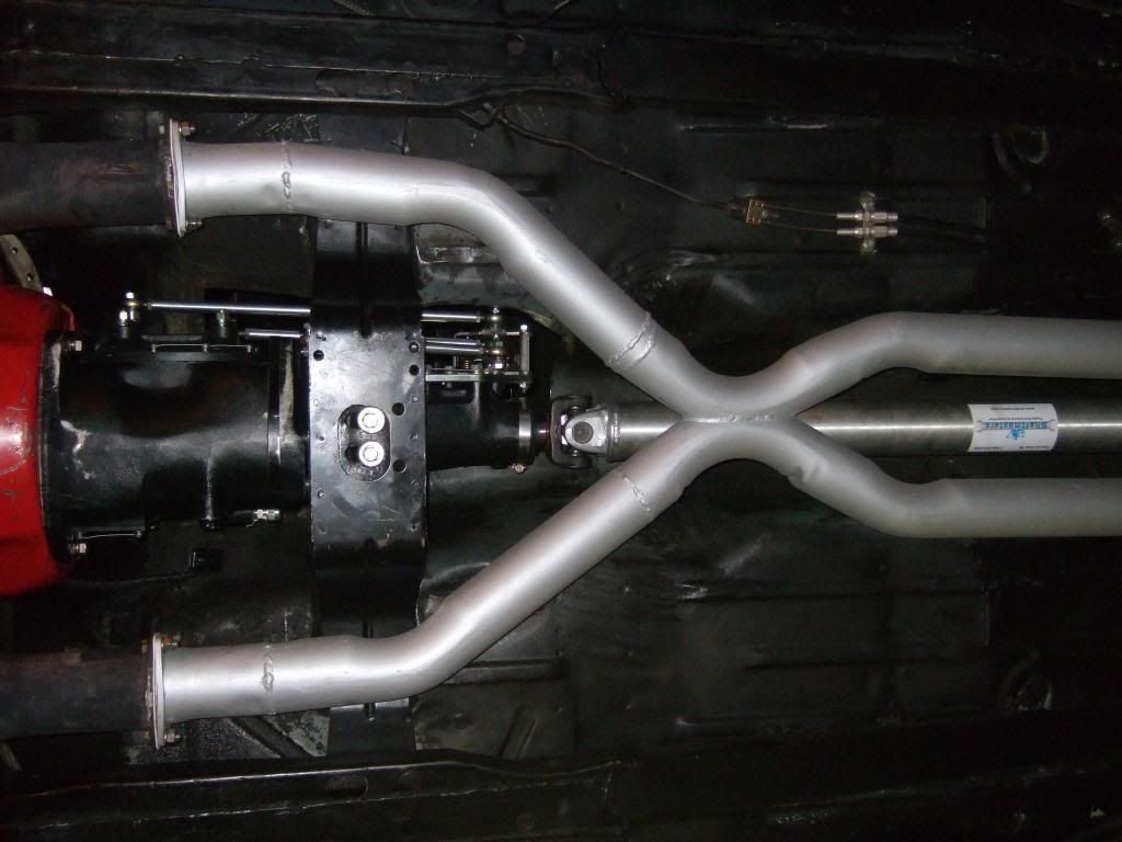

We ended with the new driveline and cleaned up exhaust all done and called it a night.

Looks great Dave! Your motor will thank you for that oil cooler on those hot track days in the middle of the desert. Your Mocal T-Stat looks very similar to the Derale I bought:

Drive shaft looks right at home too. Glad it fit, cause I know how mad you get about eBay deal fail...:lol: (teasing Bro!)

Dave it looks like you did a nice job mounting the cooler. Plus on the drive shaft don't you love it when a plan comes together even if you didn't plan it or something like that! :goofy: Very Nice.

Nice upgrades too. You should really find a way to get the one header tube off the pan or heat wrap that tube . That's just added unwanted heat to the oil not to mention that it could rub a hole from vibration, if its pushing hard enough on the pan..Just my 2 cents

That Derale looks like a nice piece for 1/3 of the price of my Mocal. (Thanks a lot Gaetano!) :lol:
Yeah I lucked out on the shaft. But I love rollin the dice on ebay parts. It's just a fun part of life for me. Sometimes it works and others it don't. But I think I've "won" more than I've "lost" so far. :thumbsup:

Yeah we just saw the Trans Am Vintage races at Laguna Seca recently and tried to mimic a lot on those cars. And it was very relaxing and rewarding to have that driveshaft work out just right! :woot:

Thanks man. I'm not sure how much on the DS but I've read usually 6-8 lbs savings for a stock unit. I've really tried to go light on everything -- light flywheel was there, so added a light metal clutch disc and now the driveshaft. Esp since mine is such a high revver.
How much can you pick up a 1LE shaft for?

I would dent that header and get it off your oil pan. That is transferring some serious heat into that oil pan.
