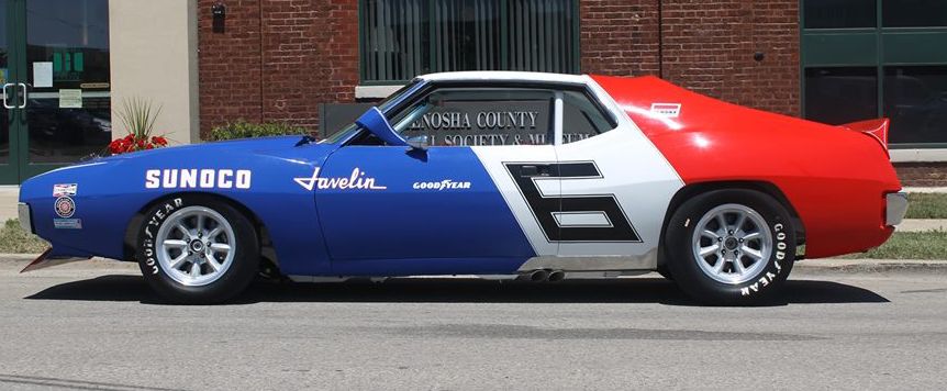

mike343sharpstk 03-10-2016 10:46 AM
Nobody has mentioned the Breedlove AMX. Pretty much the same horizontal color breaks as the Kaplan Javelins.
I like this car a bunch, and I've seen it in person many times, it's Amazing.
No bad choices here, all options are cool, and will certainly add to the attention grabbing properties this car will undoubtedly have.:flag2:
http://image.hotrod.com/f/muscle_car...-breedlove.jpg
57hemicuda 03-10-2016 11:56 AM
That's what I'm talking about!!!
I like the colors on this one also, but the layout not so much.
https://57hemicuda.smugmug.com/Cars/.../0/O/27876.jpg
