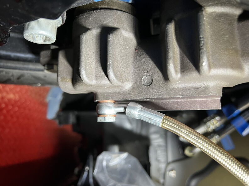

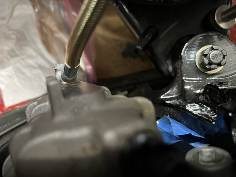

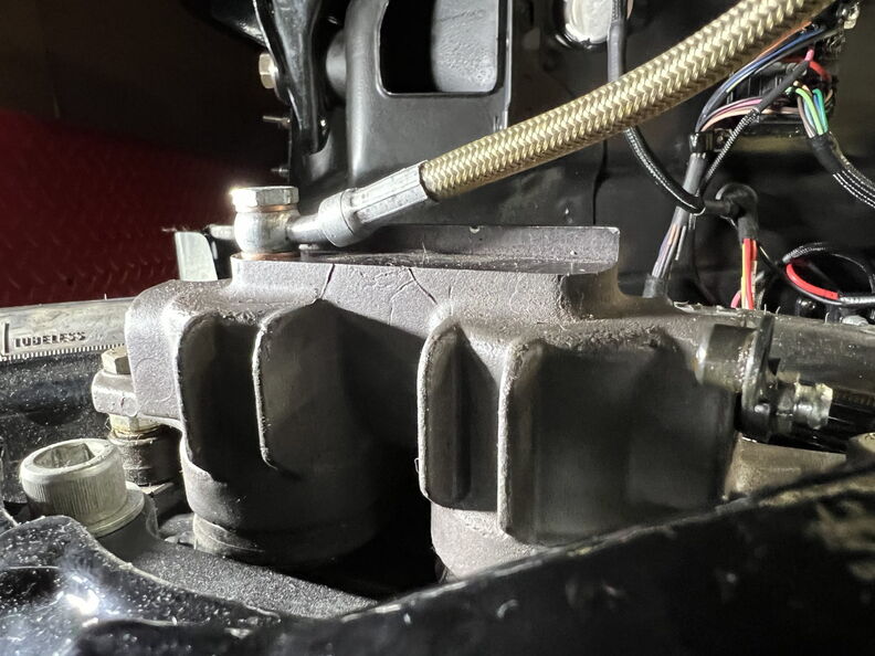

It looks like I figured it out and apparently the line is hitting the caliper before the banjo bolt can be tighten down all the way.
Here is a picture of the Drivers Side and it doesn't leak.
http://garagescene.net/_data/i/uploa...d59d2f7-me.jpg

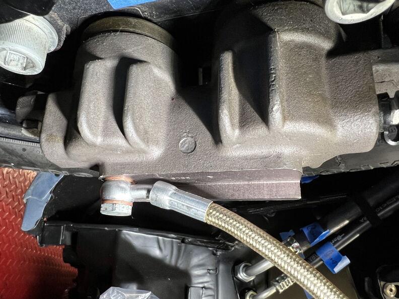

Here is the Passenger side and you can see it is resting on the caliper body.
http://garagescene.net/_data/i/uploa...8bfd750-me.jpg
http://garagescene.net/_data/i/uploa...a4c6413-me.jpg

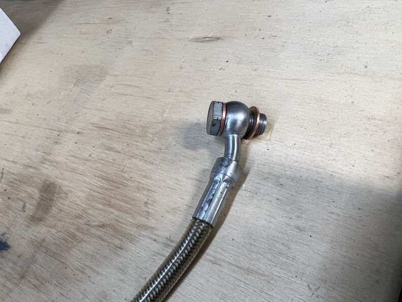

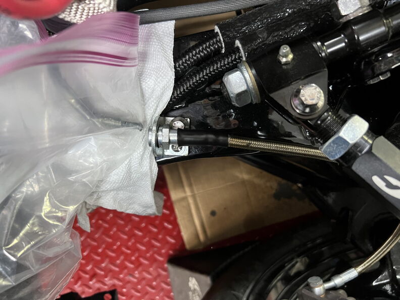

Once again this line is coming off and being bagged.
http://garagescene.net/_data/i/uploa...fc340db-me.jpg

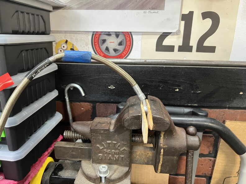

Back to my Grandfathers vise.
http://garagescene.net/_data/i/uploa...711e4e9-me.jpg
http://garagescene.net/_data/i/uploa...d063759-me.jpg
2nd Attempt as the 1st one was not successful.
http://garagescene.net/_data/i/uploa...f3ae95d-me.jpg
Looks like it's going to work.
http://garagescene.net/_data/i/uploa...b712983-me.jpg
http://garagescene.net/_data/i/uploa...8202659-me.jpg
Line is back on and I will try to bleed the brakes again tomorrow.
http://garagescene.net/_data/i/uploa...ef0f44f-me.jpg
http://garagescene.net/_data/i/uploa...3546558-me.jpg

Nice work. I've had this happen before too. Fixed it in the same manner as well.

I was considering calling Tobin and getting some new lines with a bend in them but I it looks like I am just use these.

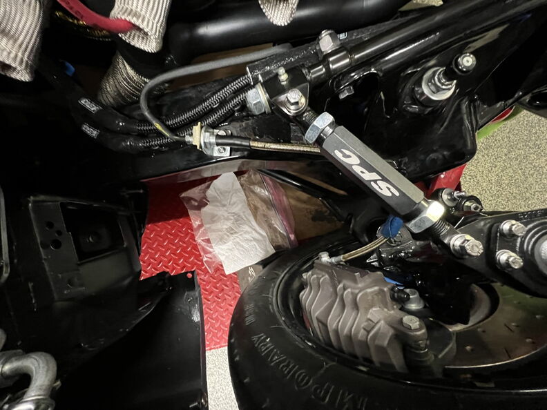

The brakes are from Tobin at Kore3. It’s a c5 / c6 kit with the DSE Corvette Reduced angle brake booster. It like having modern factory brakes on an old car. One of the other benefits is if I break down on the side of the road, I can go to Napa or AutoZone or any other local auto parts stores. I’ll be back on the road.
Sorry, I just added pictures
waynieZ 10-29-2022 02:10 PM
It looks good to go as far as room.

It always scares me when I bend a line. My brain tells me I shouldn't do it as it could fail. However, I just barely moved it.
