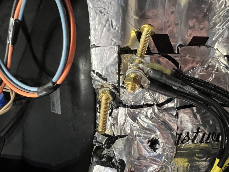

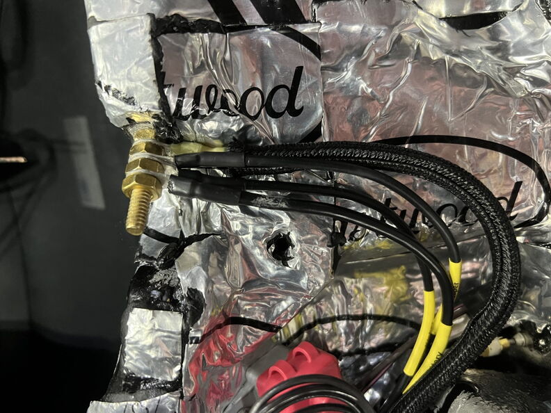

Ground Wiring (( 11-13-22 ))

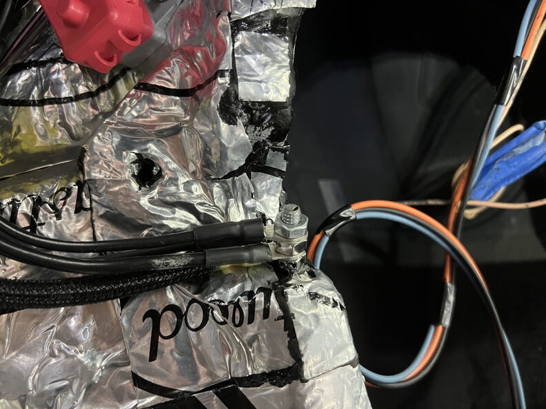

It's getting closer to starting time with Andrew Dr EFI so I figured I would wrap up all the ground wiring. I have ground studs in the drivers and Passenger side Kick Panels which need to be converted to brass nuts, bolts & washers.
Passenger Side
http://garagescene.net/_data/i/uploa...4836492-me.jpg
http://garagescene.net/_data/i/uploa...04691bd-me.jpg
Drivers Side - Out with the old
http://garagescene.net/_data/i/uploa...8f56c4d-me.jpg
I put a small amount of Dielectric grease on the head of the nut and the washers inside the cabin.
http://garagescene.net/_data/i/uploa...3cc4f2b-me.jpg
Since my memory sucks (chemo side effect) I used an extra bolt to stack the wires the same way they were in for mock up.
http://garagescene.net/_data/i/uploa...e1ff8ff-me.jpg
All better
http://garagescene.net/_data/i/uploa...b3f9969-me.jpg

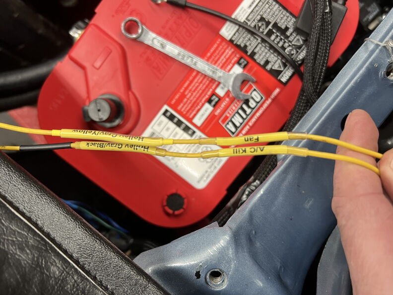

I also located the wires from the Holley ECU that I will be using to control the fan and AC shut during full throttle acceleration
http://garagescene.net/_data/i/uploa...f8ea37e-me.jpg

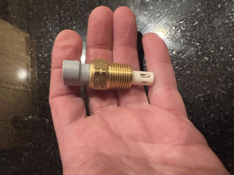

Picked up the Mat Sensor which I completely forgot about.
http://garagescene.net/_data/i/uploa...239645f-me.jpg
http://garagescene.net/_data/i/uploa...ae69199-me.jpg
