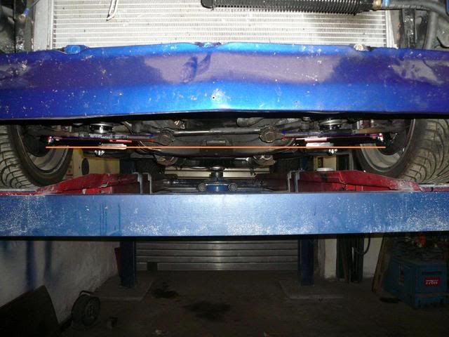

Klaus and I have been working this over and the primary issue is that the car is simply set much too low. He raised the ride height some and the arms had a lot more clearance. At this point the pivot axis of the lower ball joints was still above the inner pivot axis where the arms bolt to the frame. That`s too low. You want the inner pivot far enough above that you allow for some brake dive before the geometry goes south. See pic. The orange line is level. The red line shows where a line between the pivot axis is now (at the "raised ride height") and the blue shows where it really should be for best geometry and performance. Basically the Spohn arms use the cross bar in lieu of a bumpstop to prevent over compressing the suspension and causing shock or steering linkage damage.
http://i158.photobucket.com/albums/t.../P1020527b.jpg
At that height the car is still about 1.5" or so lower than stock and everything has plenty of clearance and travel. If you want the car lower for cosmetic reasons simply use tall lower ball joints (in this application) or spindles with some additional drop like AFXs and you can have lots of travel,great geometry and the stance you want. Coil overs aren`t the end all be all of lowering a car and making it handle,they`re just another useful tool in the box. Like any tool they have to be used properly for best performance. A new option BTW are the SPC Performance tubular lower arms which offer 1" of additional drop and more clearance as well as enhanced geometry and bumpstops. We`ll have them up on the site as soon as our web guy gets off his butt. Mark SC&C

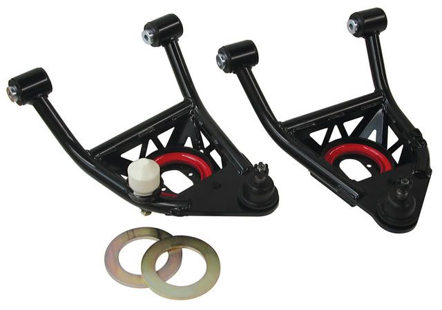

http://i158.photobucket.com/albums/t...C/lowerarm.jpg

and last but not least, the biggest joke are the lower tubular a arms from spohn.
this a-arms have no steering stop limit and no bump stops.
the centering for the ball joints is not the same as on stock arms.
and this will say, i come with the steering parts more backwards.
i think i replace the lower arms and buy the g-plus from global west.
the global west have all the features, bump stops, steering stops.

el-camino 04-28-2008 12:25 AM
here are now two new pics.
the first pic on the left side the spohn and right the global west.
the global west comes with bump stops and steering limiter and stabi-rods, the spohn has nothing.
with the spohn you have no place between chassis and a-arm.
http://www.chevy-elcamino.com/spohn-global1.jpg
on the second pic you can see on passenger side the global west and on drivers side the spohn. both sides the coil over fully compressed.
http://www.chevy-elcamino.com/spohn-global2.jpg
forget the spohn for the g-body:yes:

Marcus SC&C 05-06-2008 11:28 AM
Just goes to show different things work for different folks. We have an `87 GN in the shop right now with exactly the same Spohn lower arms, coil overs and 2" drop spindles and we have it sitting at near stock ride height. I`m glad you have the car where you want it now though.
BTW if you think the Varishock spanner with the 4 huge teeth is a knuckle buster you`ve never worked with the standard 1 little tooth coil over spanners! The Varishock wrenches are really awesome in comparison.
Don`t count on the tiny GW bumpstops,the coilovers will still overtravel and the tie rods will still hit the frame before the bumpstops contact the frame. They`re just for looks. Check your compression travel and replace them with taller ones that will prevent over compressing the coil overs and you`ll increase the life of the shocks and suspension parts. Mark SC&C
