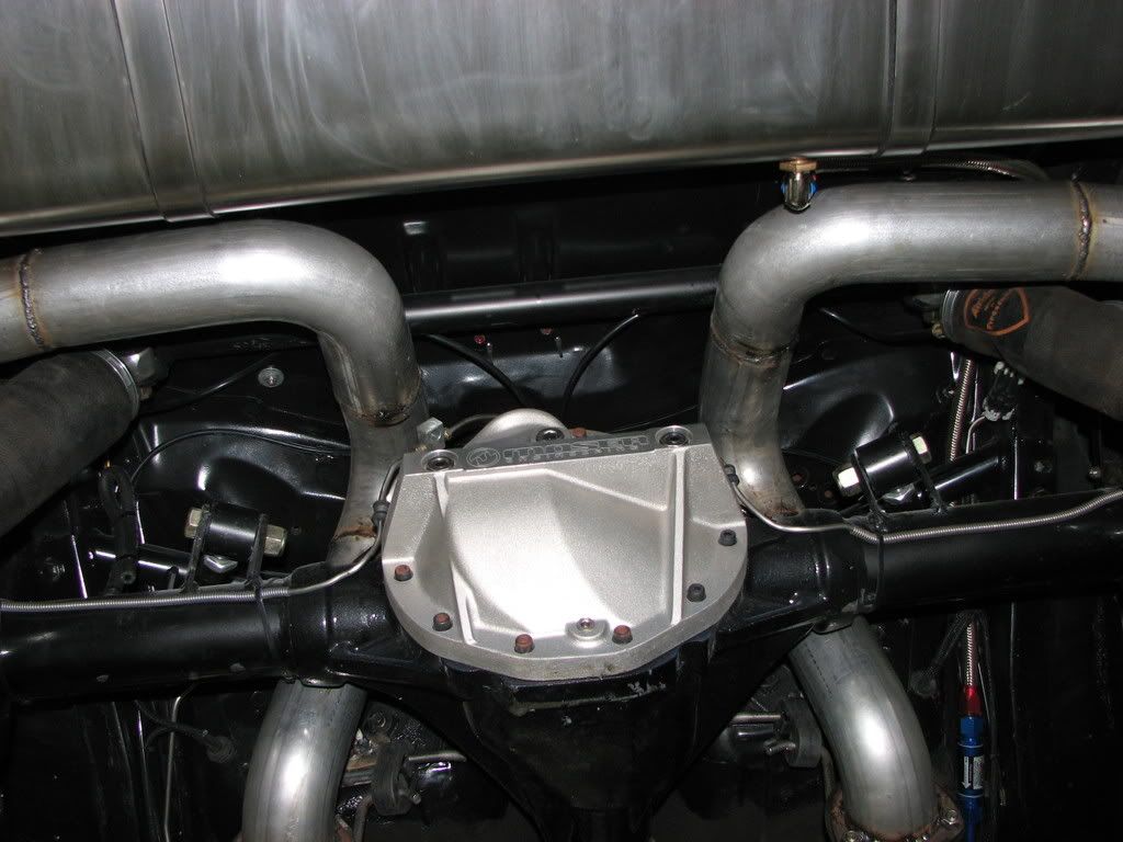

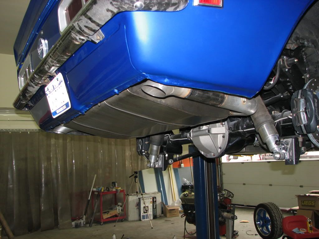

68protouring454 09-18-2008 10:50 AM
heres vinnys car, pipes clear bags by 1 inch, hes got 3-4k miles on the car with no issues, its full 3 inch pipe, 2 dimples are made for the casting gusetts on the 12 bolt.and vinny drives his car as hard as anyone
http://i239.photobucket.com/albums/f...p/IMG_0038.jpg
http://i239.photobucket.com/albums/f...p/IMG_0041.jpg
Flash68 09-18-2008 10:56 AM
Now that looks good. Thanks for posting.
