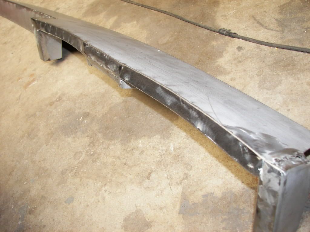

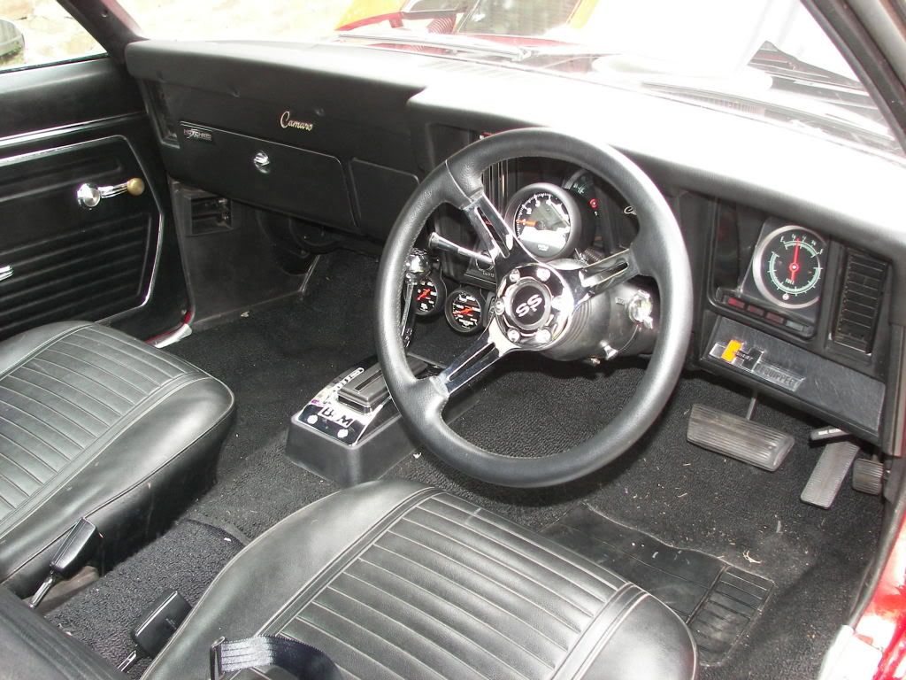

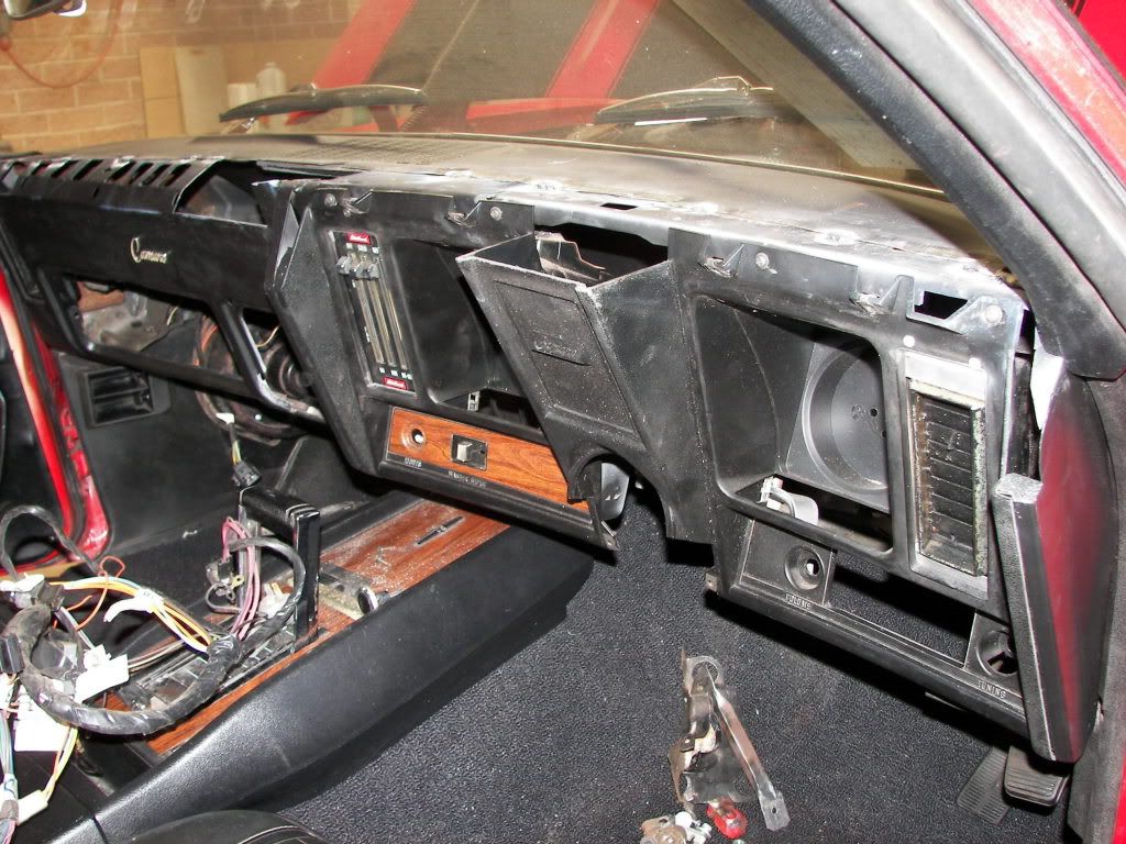

WOW!, First time I ever saw one like this. Is the steering box on the right side as well? Keep up the good work .
usa-69z 02-17-2009 05:30 PM
yes, the steering box ( chev rhd ) is notched into the subframe on the right rail . Cut the peice from fire wall on left and weld in to right side for the colum.
Brake booster is from an aussie GM 'commodore' (they make your pontiac 'gto' , its really our aussie holden commodore)
Then wiring, handbrake swap, pedals etc.
We can register LHD here if over 30 years old 'as is' or if you change it over it must comply with that states design rules, ie; seatbelts , lights , blinkers,
Wade

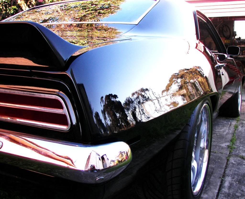

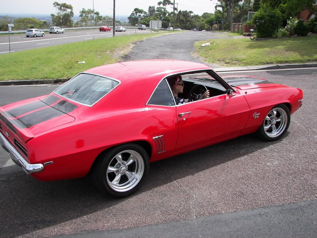

usa-69z 09-18-2011 09:07 PM
This has been a long time overdue ! well from humble beginnings to "this is now"
my aussie RHD 69 has had a major rebuild , adding new panels, quarters glass , and black paint with grey hockey stripe, etc.
fitted injection recently using a 'fast ezi efi' computor and harness
http://i221.photobucket.com/albums/d...CARFEST021.jpg
Spiffav8 09-19-2011 02:08 AM
DANG! Car looks amazing! :wow:
:cheers:
Rybar 09-19-2011 01:10 PM
I'll second that, looks killer Gav, post more pics. :thumbsup:
