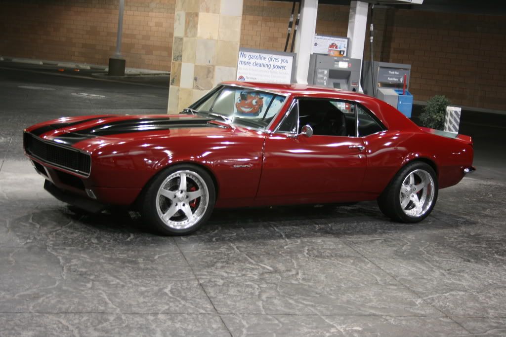

Spiffav8 05-03-2009 01:01 AM
Ok scottybuck 11 here's a picture of my car with a set of GW 3" drop springs. It took a few months but it did come down from the height of the initial install, about 1.5". If you are still working on the car and it is not being driven, I would suggest leaving everything loose and keep some weight in the trunk. Get some measurements so you can track the drop. So basically don't panic yet. :lol: Maybe a few guys with the DSE 2" drop springs can post some pics for comparison.
As for any feelings of being stupid...you can totally dismiss those. Lots of guys have been in your shoes including me.
:thumbsup:
http://i256.photobucket.com/albums/h...Picture012.jpg

scottybuck 11 05-09-2009 07:32 PM
ok guys i got my 3inch drop springs in and thats got me about an inch lower but i still havent got everything in the car so i put 250lbs in the trunk and left everything loose so it will settle.once again thanks guys.:lateral:
Spiffav8 05-09-2009 09:55 PM
Sounds good! Give it some time...sadly that's what it takes. :thumbsup:
scottybuck 11 05-14-2009 01:48 PM
just a little update.i put 250 pounds in the trunk and it has settled an inch.so im looking good now.:thumbsup:
Vegas69 05-14-2009 02:13 PM
Told you dude.:D
