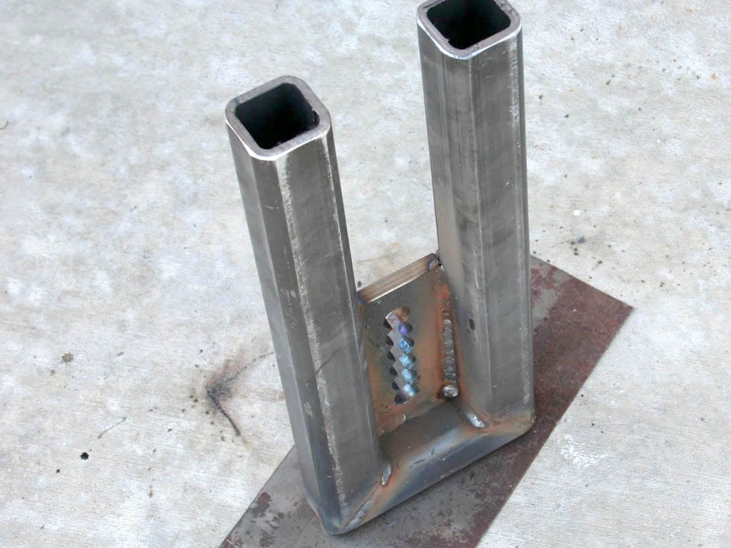

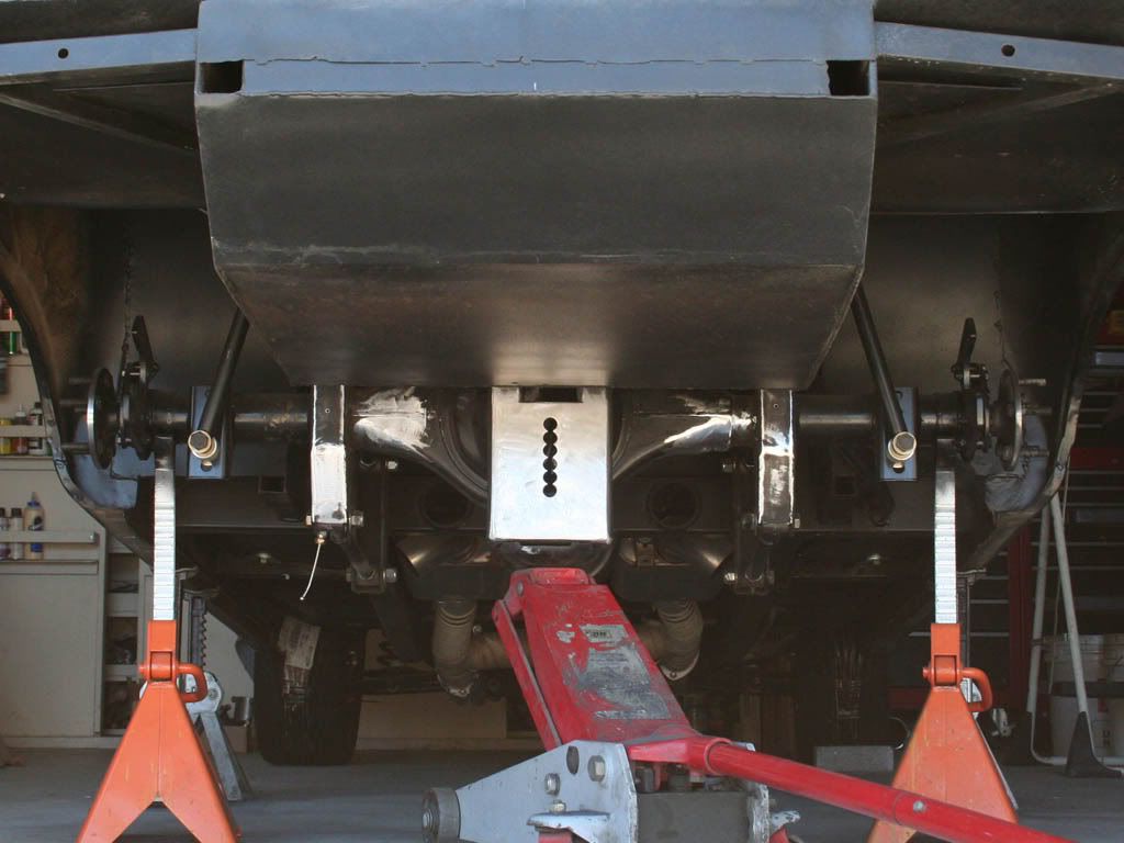

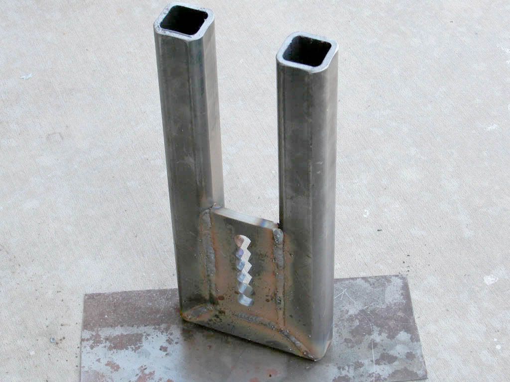

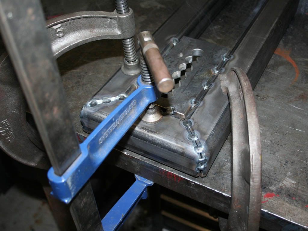

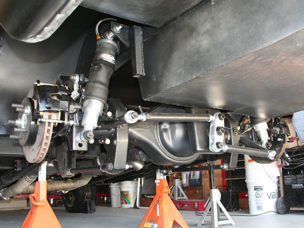

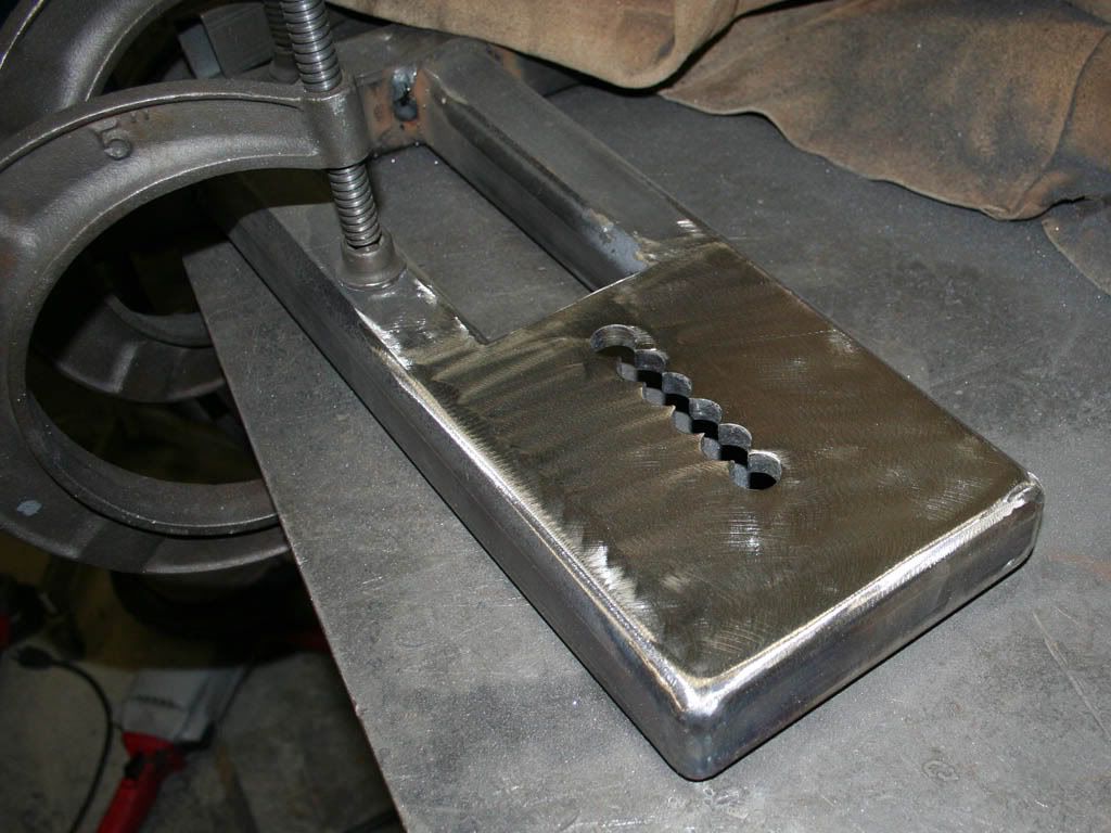

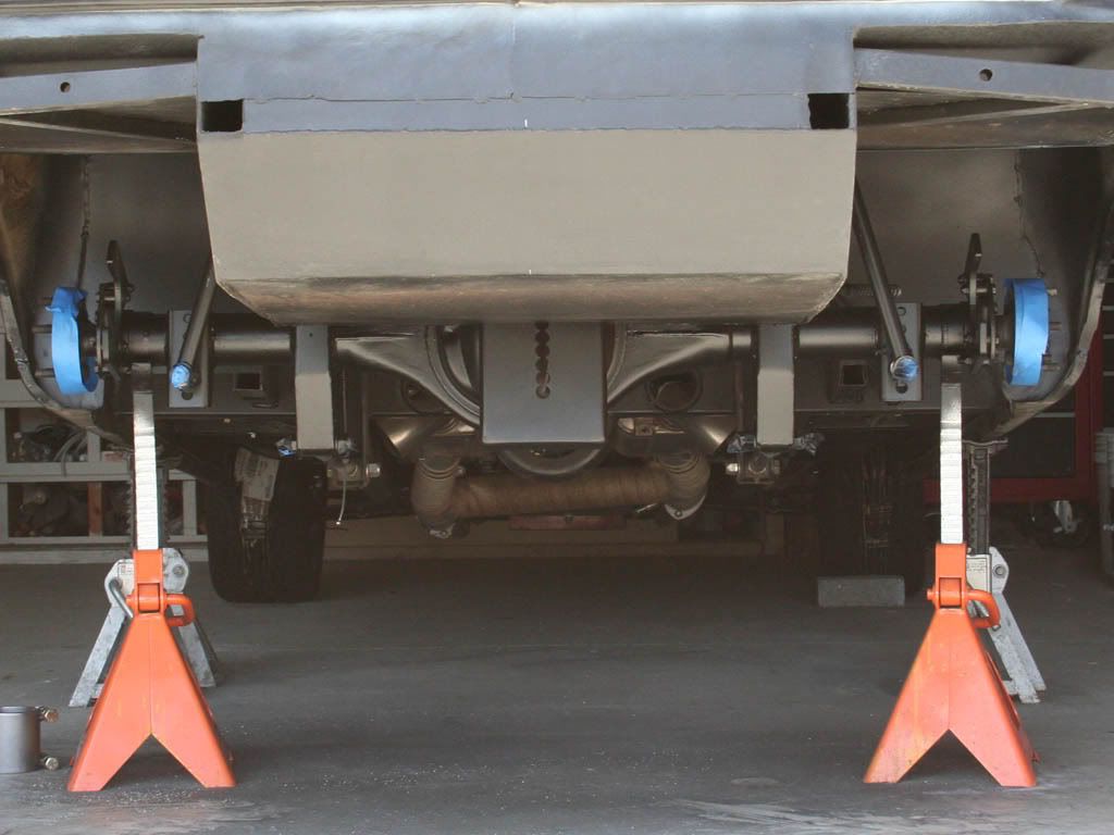

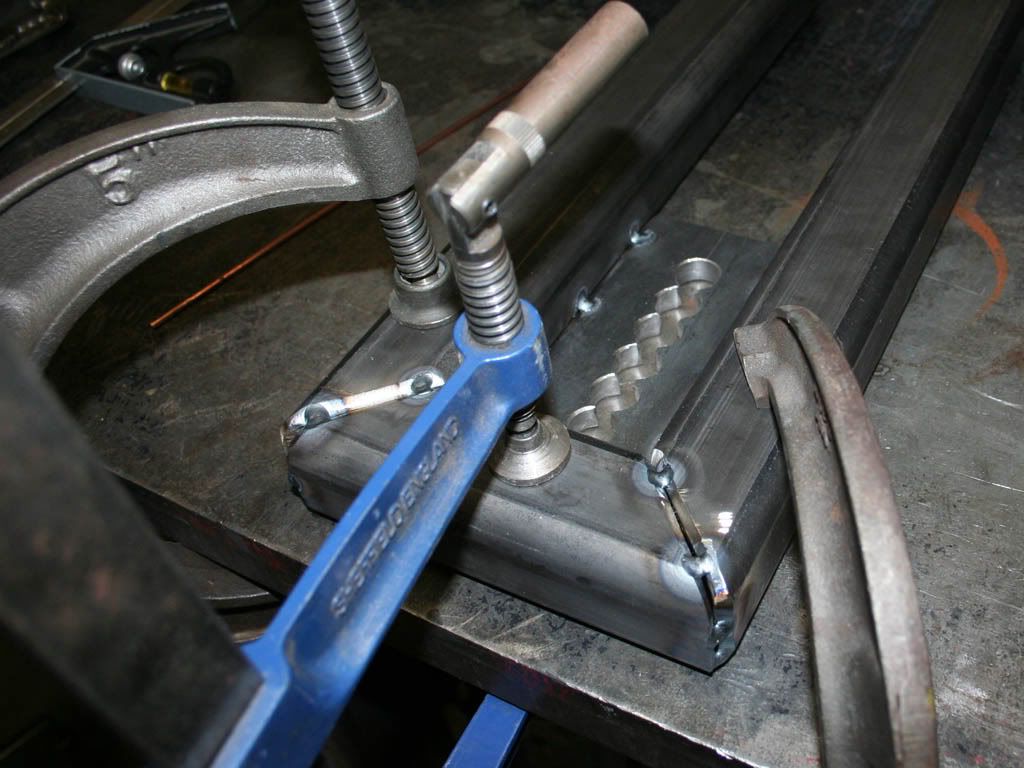

Here is an example. This is a piece I made for my watts link. 1/4" wall tube and 1/2" plate. With 23 wire. And really, its a solid joint, it was hotter than hell. I think it is sufficient. Would 45 wire done just as well, or better? Just as well, not better IMO. JR
Tacked up with the TIG on the bench.

Then out to the driveway for the final welding with the MIG and .023" wire.
http://img.photobucket.com/albums/v3...s%20link/g.jpg
http://img.photobucket.com/albums/v3...s%20link/h.jpg
Some flattening of the outside beads for clearance..
http://img.photobucket.com/albums/v3...s%20link/i.jpg
And in the car for final welding..
http://img.photobucket.com/albums/v3...s%20link/j.jpg
http://img.photobucket.com/albums/v3...s%20link/k.jpg
http://img.photobucket.com/albums/v3...l%20pics/c.jpg
