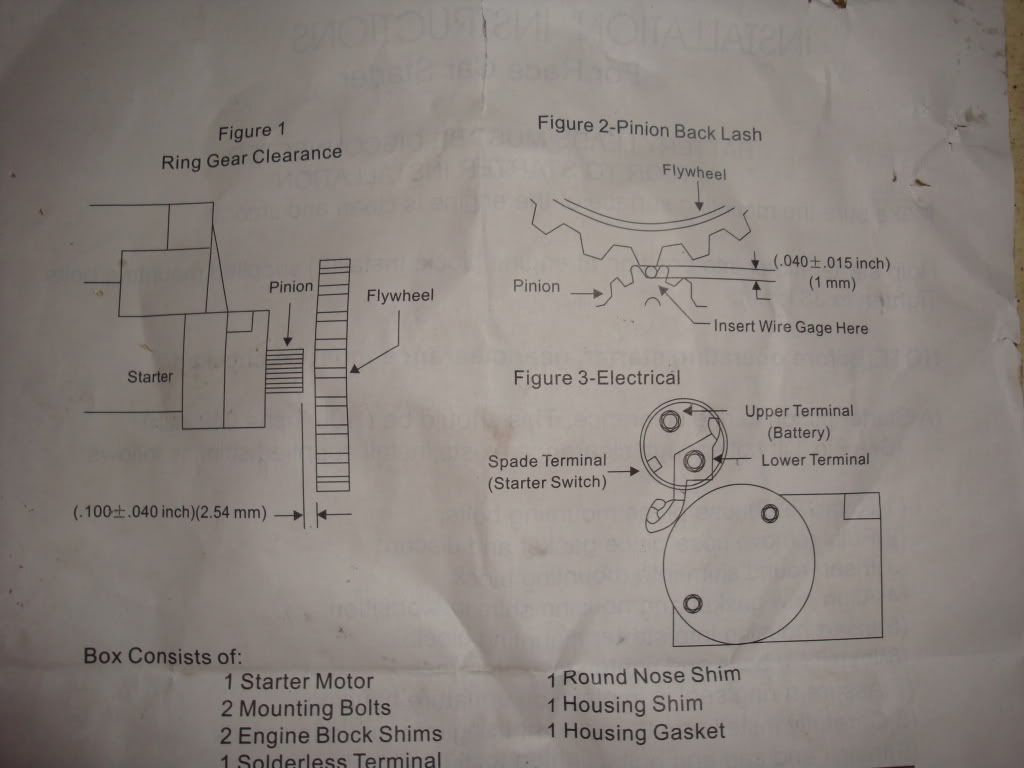

You need to re read my post. There are "TWO" measurments to make a starter work correctly.
1. The distance between the end of the sterter pinion and flywheel teeth. (What is pictured in my thread previous) Must be over .100 but not greater than .150 from memory.
2. The distance between the tip of the starter tooth and the gut of the flywheel. (how many different size paperclips are there?) I have about 6 in my office. Probably not the best way to check it. Go to sears and get you a set of pin gauges. .035-.060 sounds close.
In picture number two in my previous post, you see a shim sitting on top of the starter housing. This is moving the pinion gear farther away from the flywheel teeth. If it is to close, you starter will not engage properly and will stick in the flywheel teeth. By the way, it's either a 153 or 168 tooth flywheel. If the gears mesh, they mesh.

okay, i am going to try the new starter, which has the removable mounting block.
I have: Removed the nose piece, installed a a shim in the mounting block, alighted gasket and housing, and put shim in position, installed back the 3 bolts, made sure armature is sitting flush with mounting block.
i will be making sure that my ring gear clearance (pinion not engaged, measuring to .100 inch)
also, making sure the backlash of the pinion and the flywheel mesh is .15 inch
The thing i am worried with this starter is, the pinion gear is already meshing with the flywheel, and the clearance i would need would require a large shim to move the whole starter back, while leaving the mounting block still bolted to the engine, this would ultimately move my pinion back, and i would be able to to have a clearance or .100
AH so hard to explain, which we could have a video chat with like 10 of us and me explaining lol!
I ll take pictures!
also,
vegas69 right on the money, you were right, look below
http://i361.photobucket.com/albums/o...9/DSC00910.jpg
