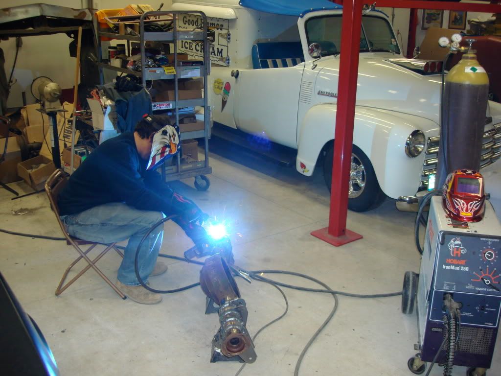

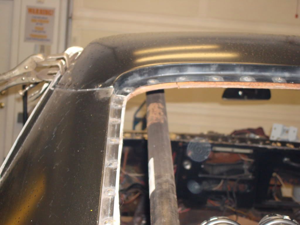

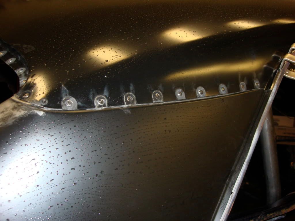

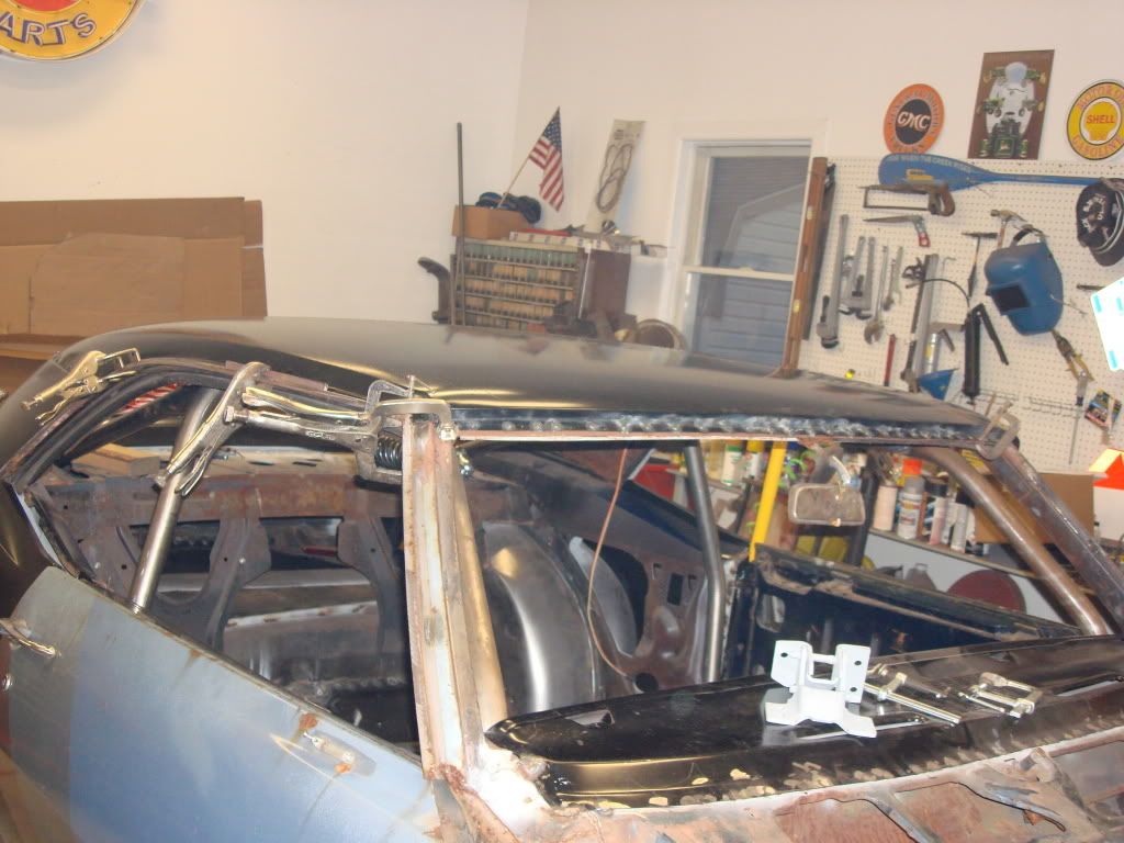

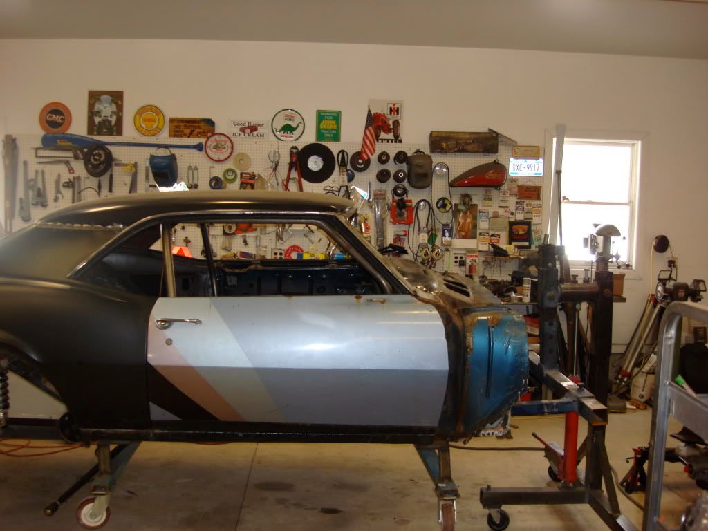

Roof is on. I welded the front/back and the where it meets the quarter but used 3M body panel glue in the drip rails to keep it clean. It came out really well.
http://i819.photobucket.com/albums/z...o/DSC02087.jpg
http://i819.photobucket.com/albums/z...o/DSC02089.jpg
http://i819.photobucket.com/albums/z...o/DSC02094.jpg

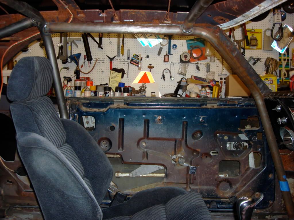

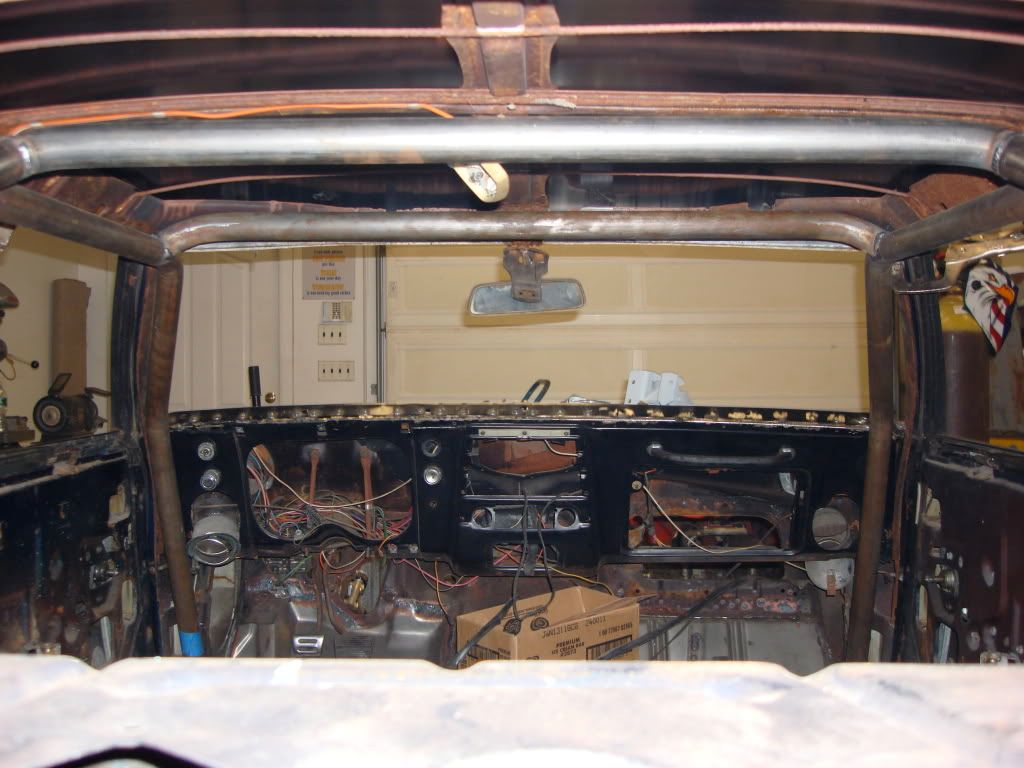

Good visual on the cage fitment with the roof on.
http://i819.photobucket.com/albums/z...o/DSC02097.jpg

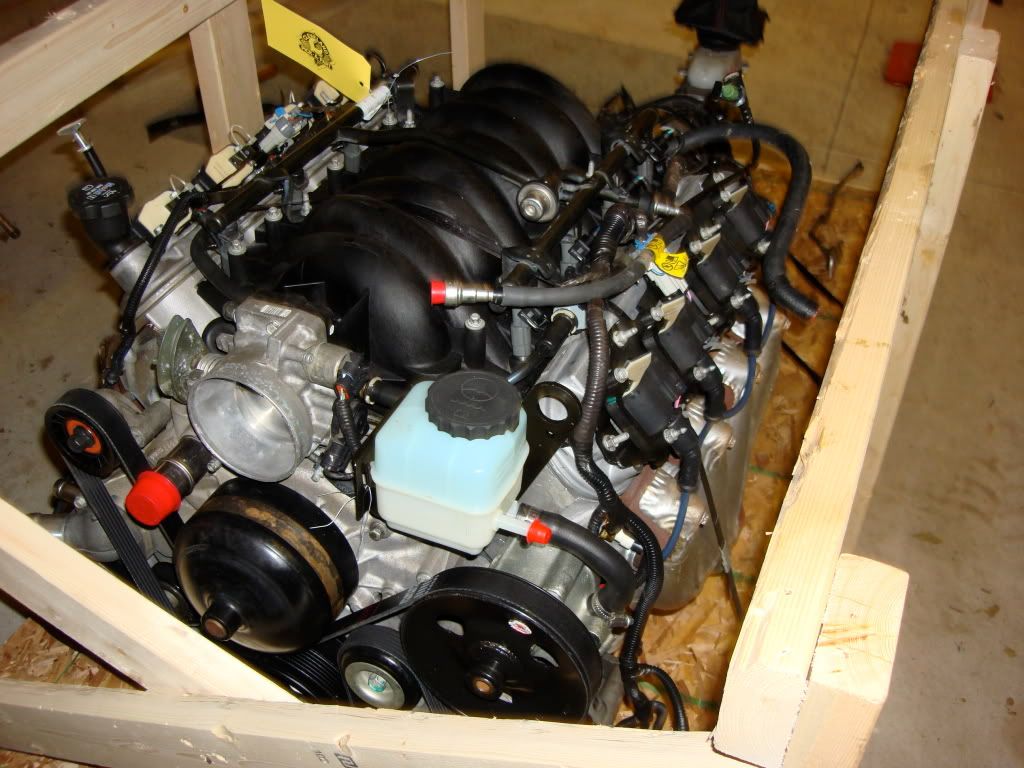

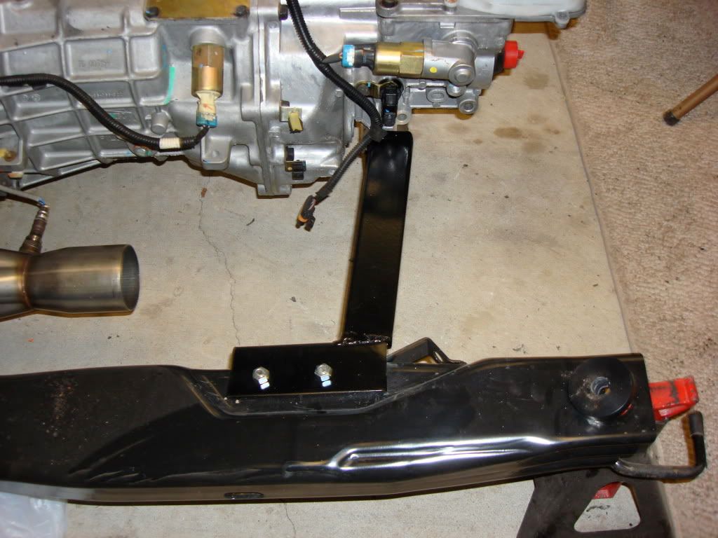

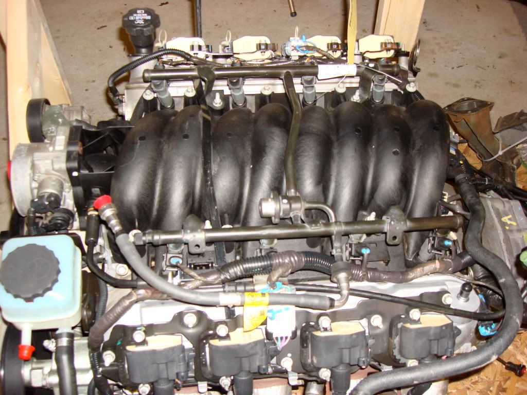

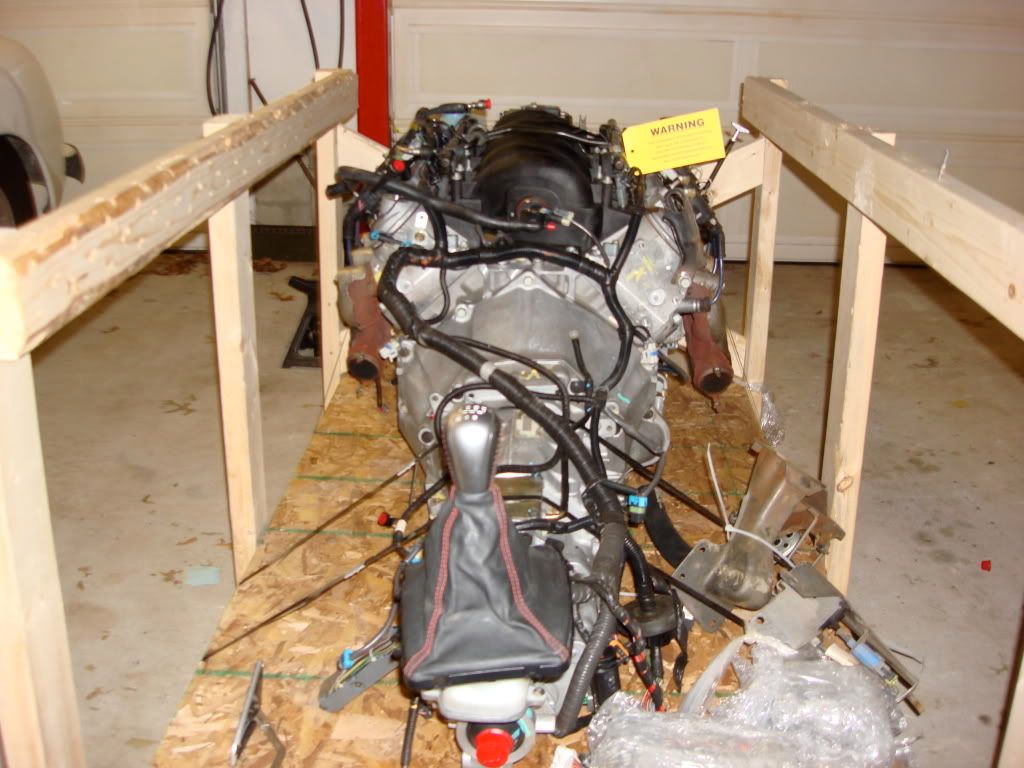

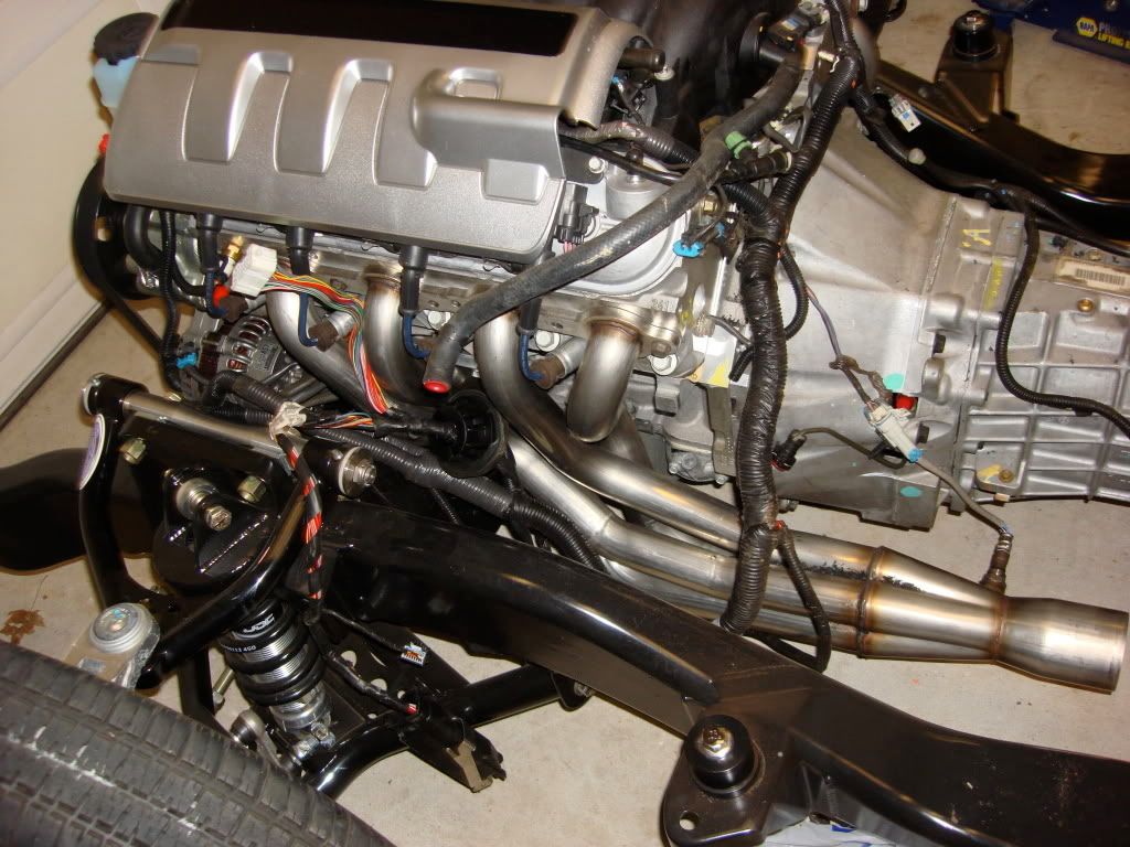

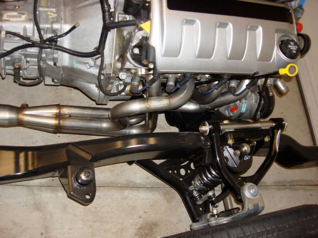

LS1 6-speed from an 04 GTO. Came with 35000 miles on it. Cleveland pick apart sells a really complete package. It made the LS conversion really cheap. You couldn't build a cast iron small block for this price and it bolts in to the Detroit speed frame like it was made for it.
All i had to do was bolt on a stock F-body oil pan, and a VA AC compressor and it fits fine.

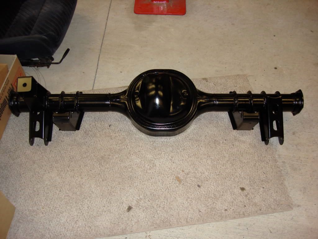

The rear is done and powdercoated. The stange axles and center is on order. It should be here in a week or two.
http://i819.photobucket.com/albums/z...o/DSC02139.jpg
http://i819.photobucket.com/albums/z...o/DSC02183.jpg
We made a crossmember out of some rectangular tube and flatbar.
http://i819.photobucket.com/albums/z...o/DSC02180.jpg

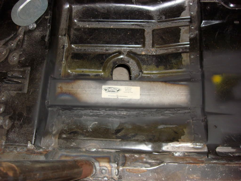

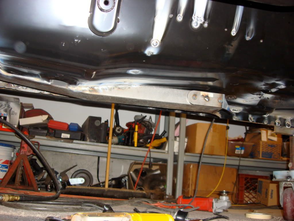

We also got the DSE subframe connectors done. When the car goes on the rotisserie we'll finish the welding
http://i819.photobucket.com/albums/z...o/DSC02176.jpg
http://i819.photobucket.com/albums/z...o/DSC02177.jpg

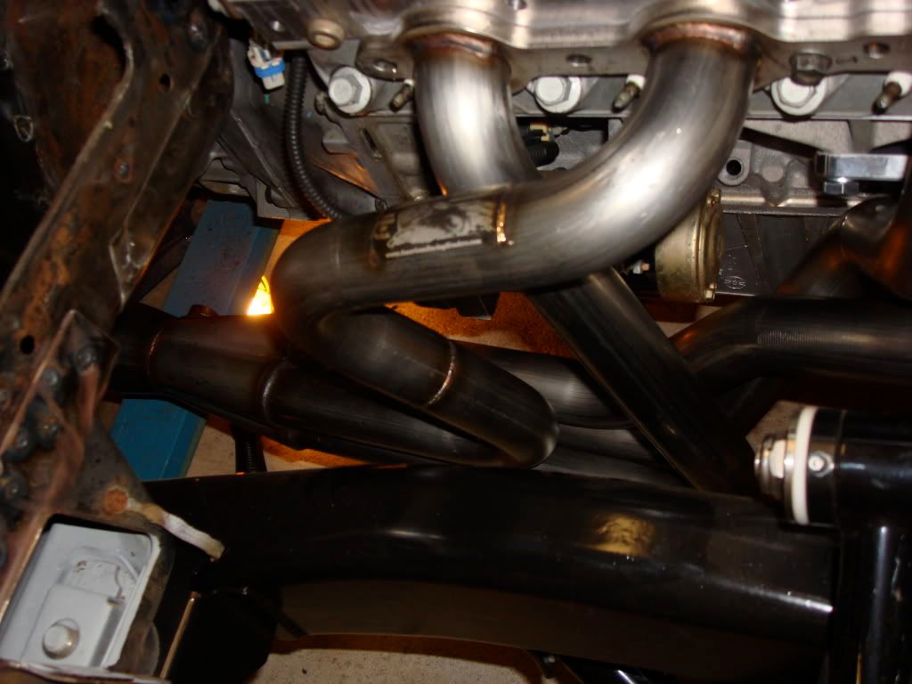

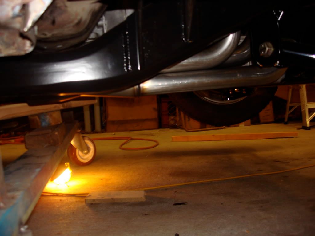

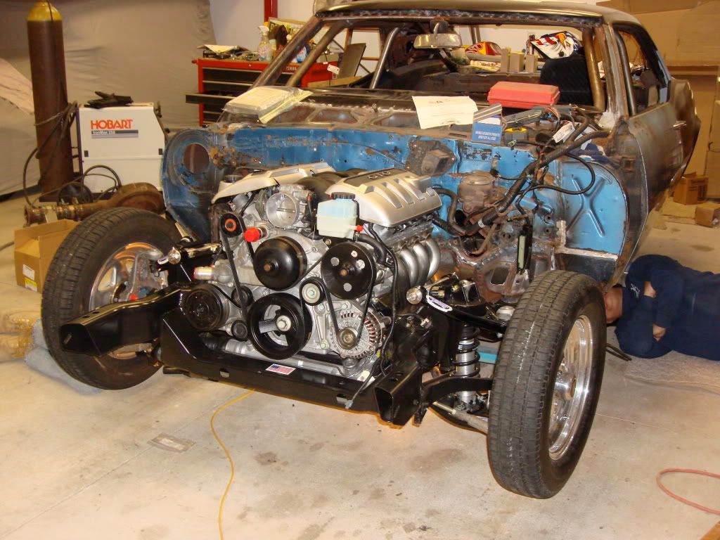

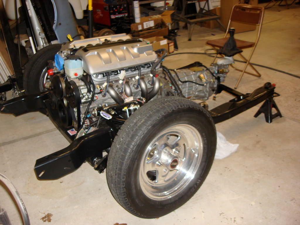

The engine is in the subframe and the american racing headers are in. It's so much more gratifying when you pay for the parts yourself. The f-body oil pan and pickup tube were also need for it to fit.
http://i819.photobucket.com/albums/z...o/DSC02170.jpg
http://i819.photobucket.com/albums/z...o/DSC02171.jpg
http://i819.photobucket.com/albums/z...o/DSC02173.jpg
amazing ground clearance
http://i819.photobucket.com/albums/z...o/DSC02163.jpg
http://i819.photobucket.com/albums/z...o/DSC02150.jpg
http://i819.photobucket.com/albums/z...o/DSC02147.jpg
And no i'm not running the skinnies... Those are the only wheels we have that clear the spindle lol

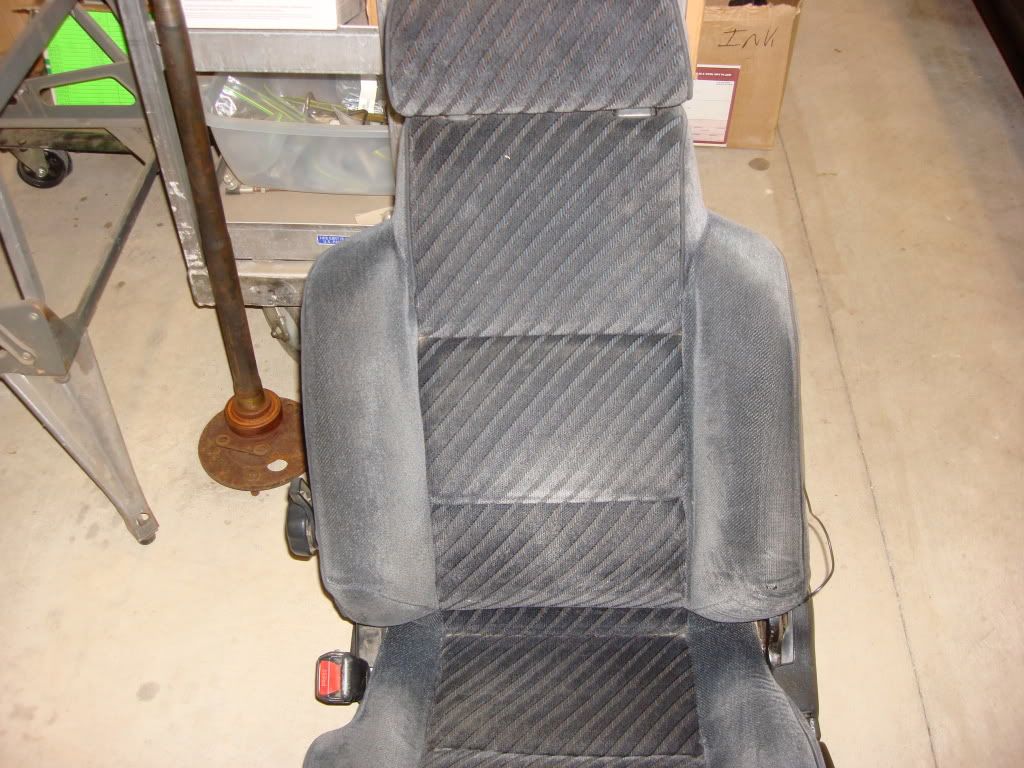

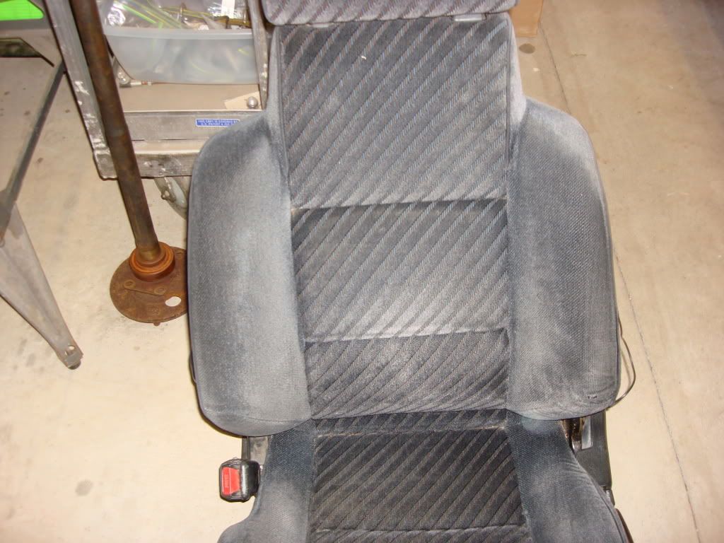

I also got new seats from the junkyard. They are from a 91 honda prelude....... :willy:
But they are really supportive and have adjustable side bolsters.
http://i819.photobucket.com/albums/z...o/DSC02157.jpg
http://i819.photobucket.com/albums/z...o/DSC02158.jpg
This gives you a better idea of how well the cage fits and how large the side bolsters are. I know the seats are kinda funky looking, but they're cheap

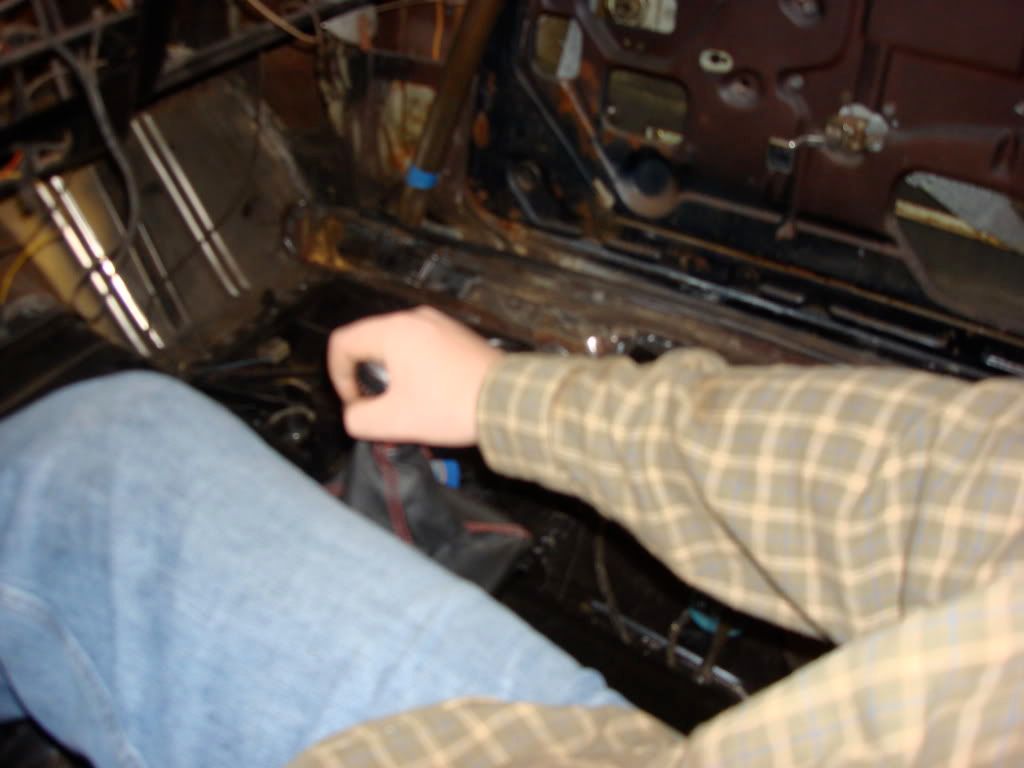

And the stock GTO shifter is in the perfect position. We got lucky on that one :thumbsup:
http://i819.photobucket.com/albums/z...o/DSC02166.jpg

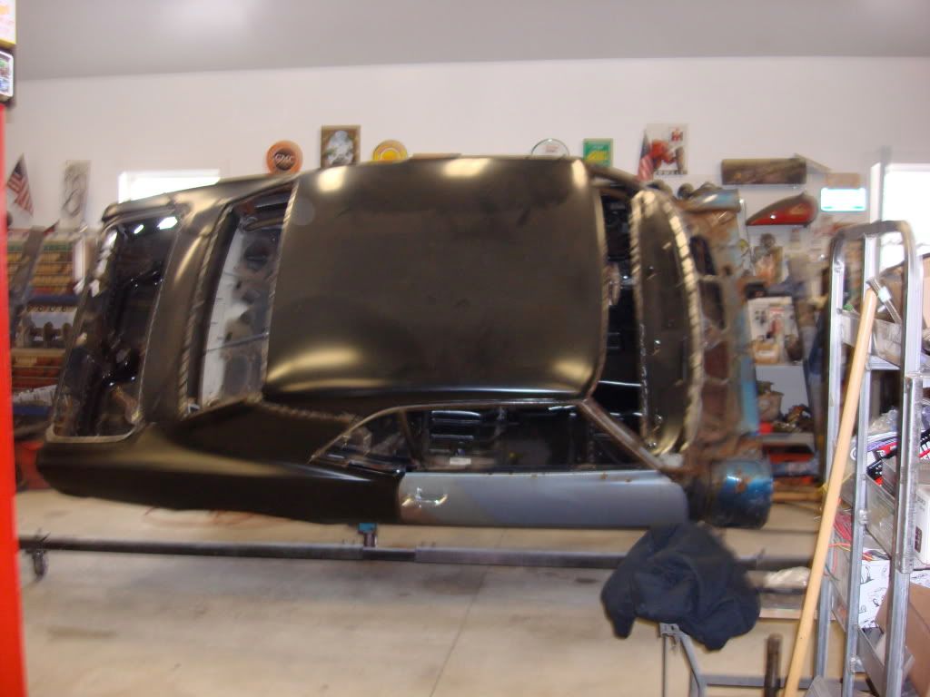

6spdcamaro 03-20-2010 06:04 PM

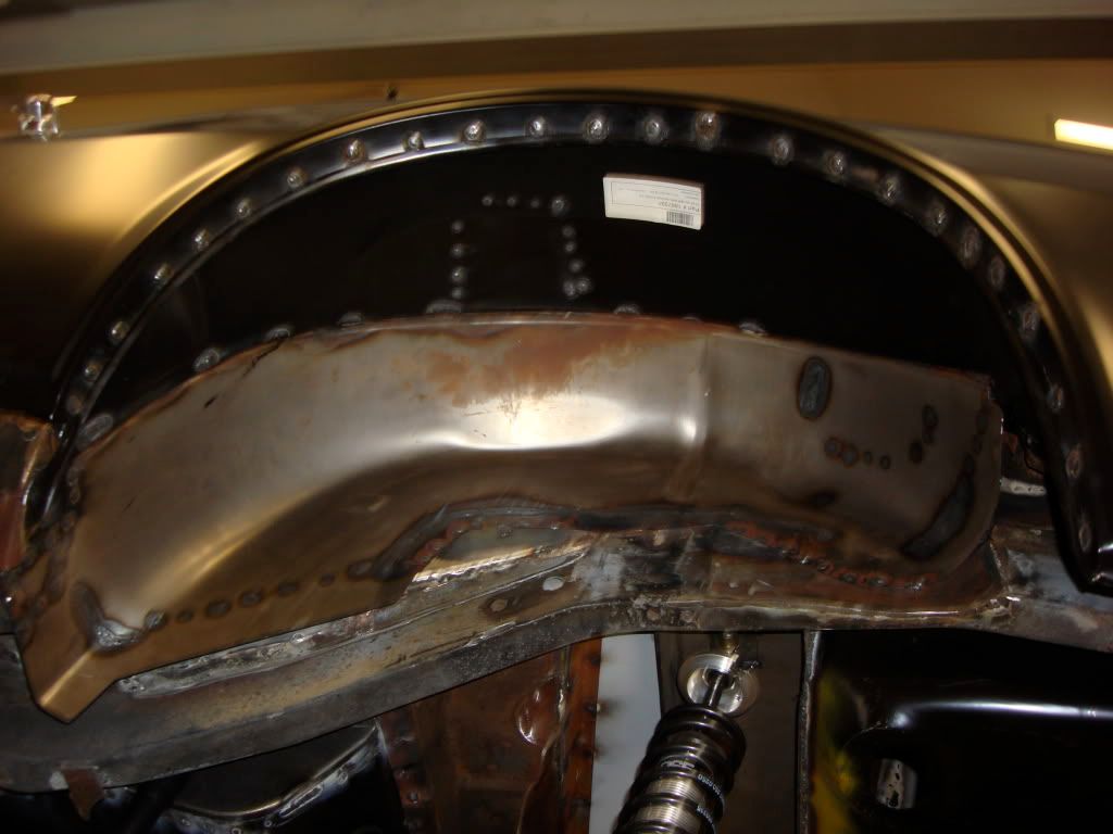

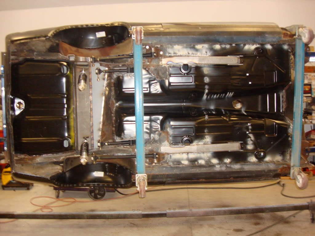

The car is on the rotisserie so now its a bunch of detail work.
http://i819.photobucket.com/albums/z...o/DSC02190.jpg
http://i819.photobucket.com/albums/z...o/DSC02191.jpg
http://i819.photobucket.com/albums/z...o/DSC02195.jpg
http://i819.photobucket.com/albums/z...o/DSC02198.jpg
Once everything is welded solid and wire wheeled clean of rust, we'll seam seal everything and undercoat it. Than begins the body work....... :willy:
