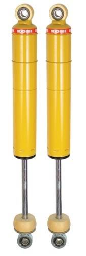

Its hard to tell just from the pics. But I went on the DSE site and looked at the shocks they say are used for your setup. And just going off the pics your shock looks to be about 2-1/2" longer. Again, hard to tell from the pics and their pic may just be a stock pic of the konis they sell.
The pic they show for your car. Its prolly a stock photo for all their shocks. Too bad they dont give specs on their site for the shocks. JR

Well I was welding in my upper rear shock mounts in my 69 camaro with DSE mini tub kit and noticed that when I install the shock its almost bottomed right out at ride height.It only has about 2" of travel before it hits the bump stop.I am using DSEs Koni mini tub shocks.Where have I gone wrong??? I hope someone can shed some light on this.Thanks in advance.

Well guys I spoke with Dan @ DSE and he assured me that I have the correct shocks and thats the way they sit.What I forgot was that I installed the shocks at ride height so if the diff hangs the shocks will extend out further.So I guess my findings are normal according to DSE.
