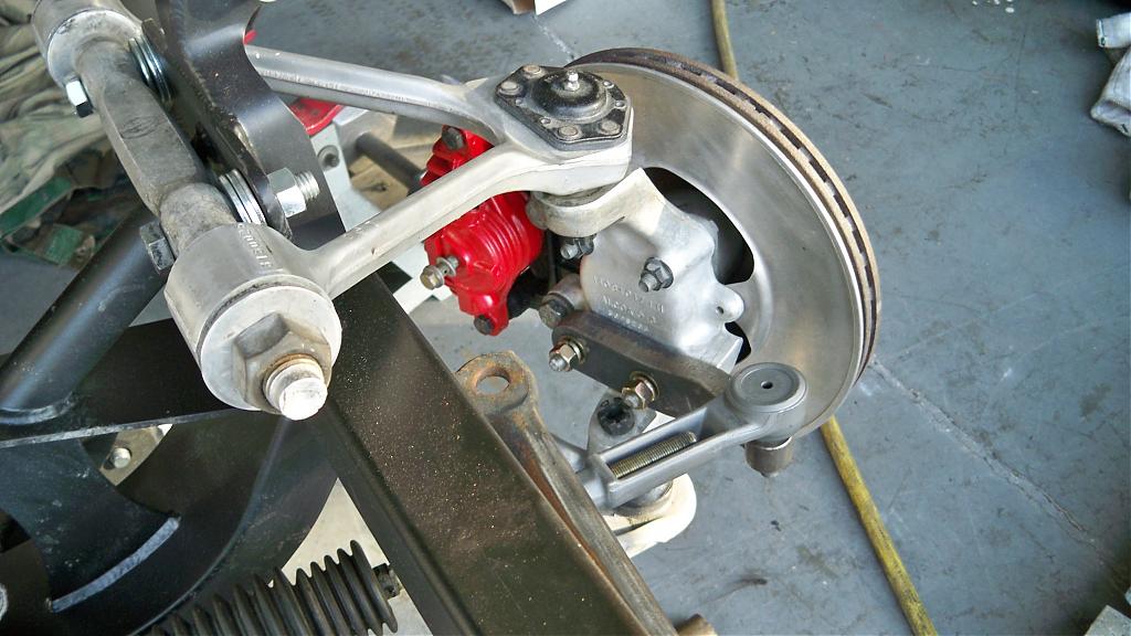

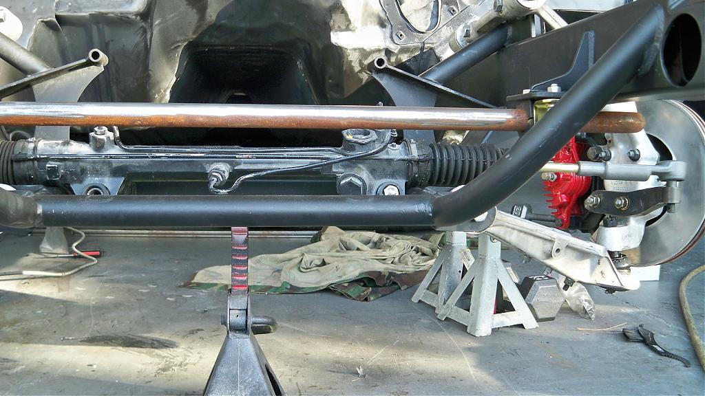

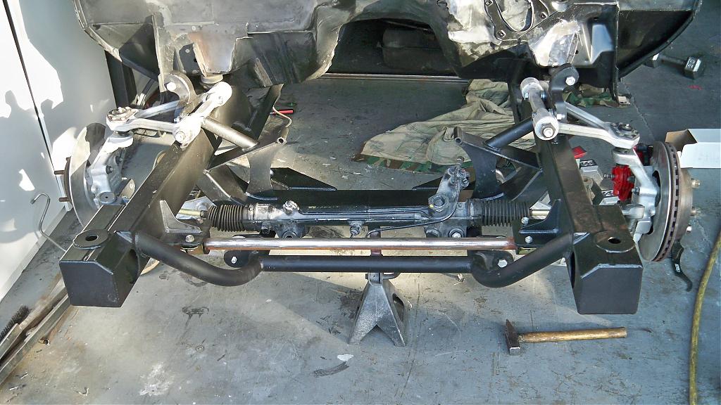

3 Attachment(s)
I'm stickin with the WD subframe.
Undecided on the body mount bushing but thank you everyone for the input. I was actually thinking about the body drop aluminum ones before all this, not anymore though haha.
Attachment 24836
Attachment 24835
Attachment 24834
