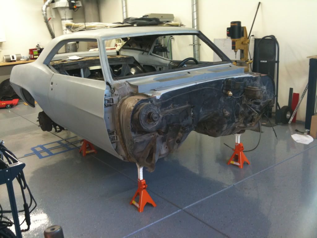

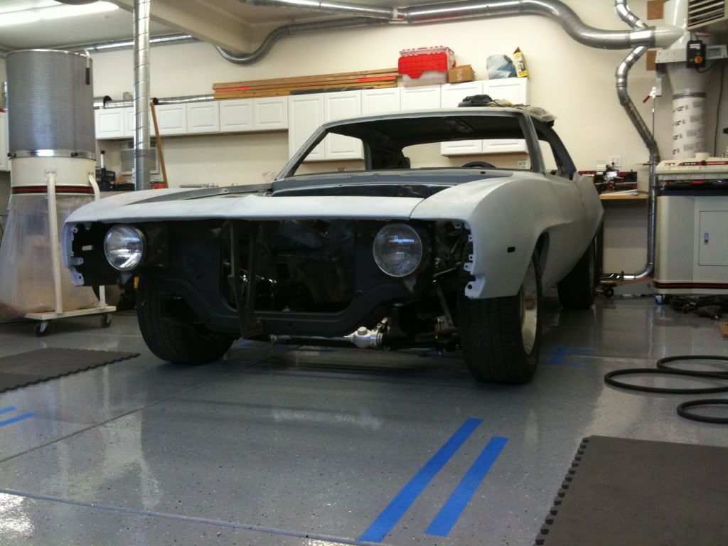

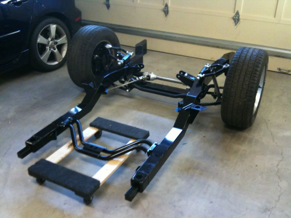

Cool, I have the same subframe and am trying to figure out the best backspace for a 18X9" with a 275. I want the car to be prety low, and based on Franks recommendation of a 6.75"bs for your 10", I was thinking 6.25" for my 9" but I am having a hard time confirming this. So I was just checking to see if you got something to work. Thanks.
DriverzInc 06-15-2010 05:19 PM
Based on the measurements the original poster came up with, I'd agree that a 9" with a 6.25" should work as well. Have you measured the distance from your rotor hat to the outer fender? What do you come up with?
steve671 06-15-2010 07:55 PM
Thanks Jon. Unfortunately the subframe is not in the car yet, it's sitting on jackstands.
Maybe Mikamaro would be so kind and take this measurement?
steve671 06-20-2010 05:38 PM
Ok, I put the whole thing together, swapped out the subframes and measured this. It is 5-5/16" from the hat to the unrolled fender lip.
Base on this measuremeant, to make the 18X9 with a 275 the same distance to the fender lip as the factory ralley with a 235, the BS needs to be 5.75". I am considering going 6.0" to give me a quarter inch more clearance because I am going to be pretty low.
Does this sound right?
