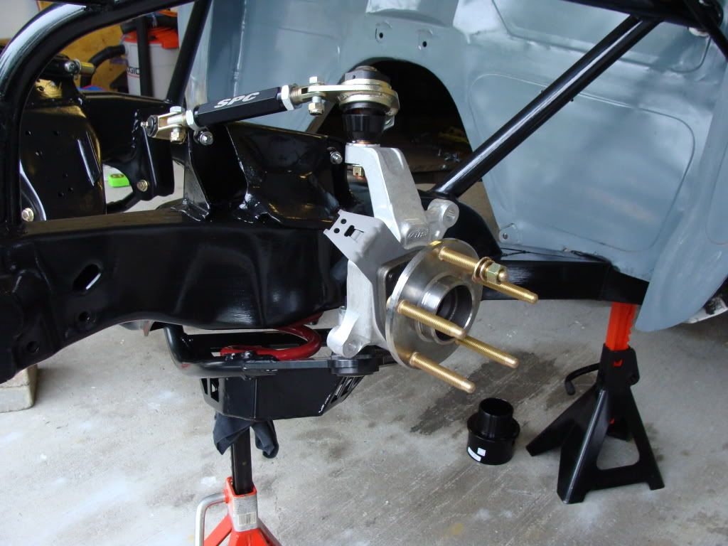

speedjohnston 07-26-2010 07:59 PM
I have them on my car...
and yes its a second gen.
http://i175.photobucket.com/albums/w...o/DSC00850.jpg
speedjohnston 07-26-2010 08:01 PM
Something may have changed but they were available.
