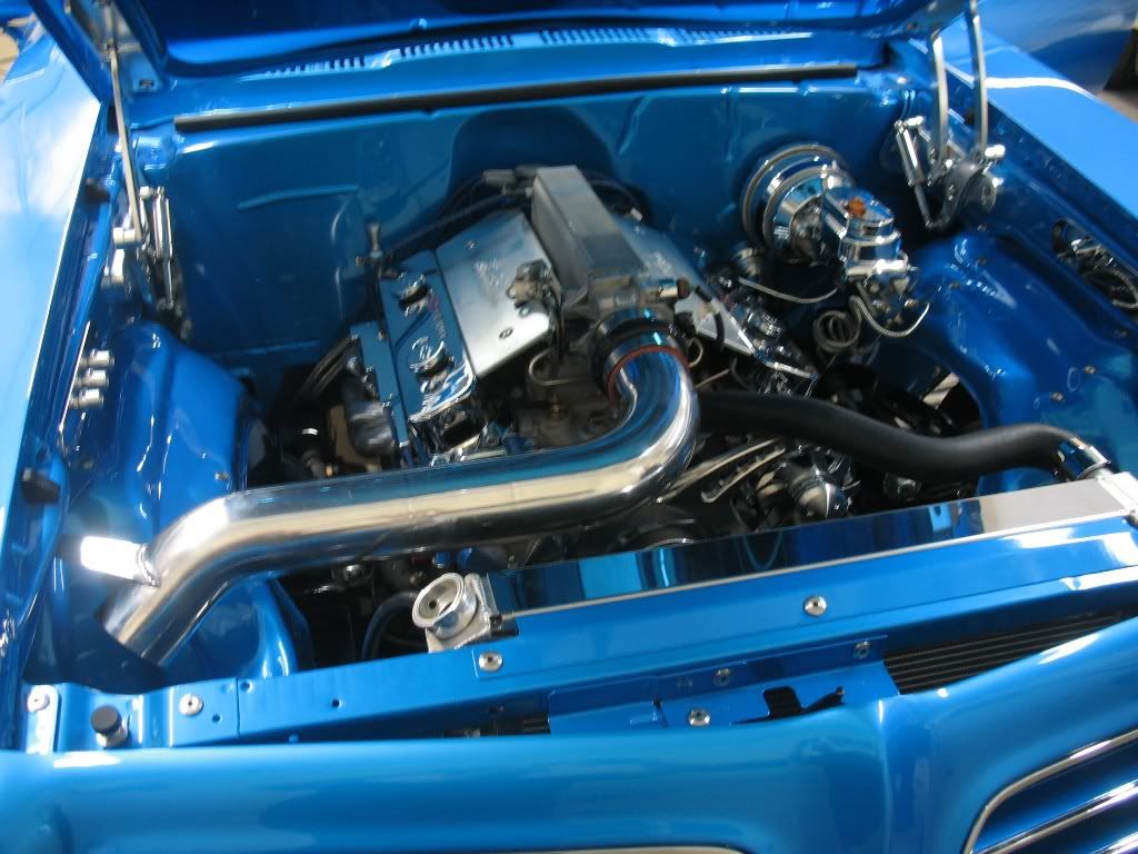

This is the engine bay (a little much, but we just did some of the components!) of a 76 ventura that a GM dealership built up here for a customer of theirs. We did alot of cnc machining, the air intake, ac plumbing, and custom billet tail lights.

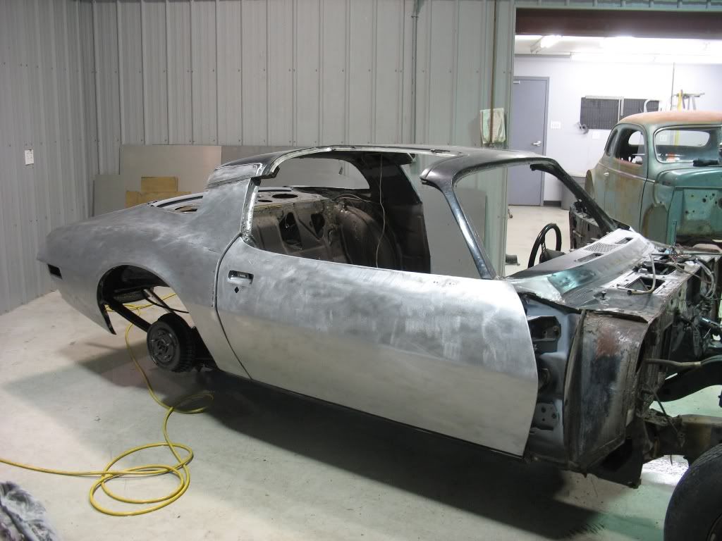

We have been doing a bit of work on a 77 trans am. Tons of rust repair, had to use quarter skins, and the last shop BUTCHERED the quarters so had to get a donor car for the upper quarters and flush welded the lower skins on. New door skins, lower door framework, floor pans, trunk floor, wheel tubs.
Car now has Hotchkis suspension front and rear, and some basic SSBC brakes.

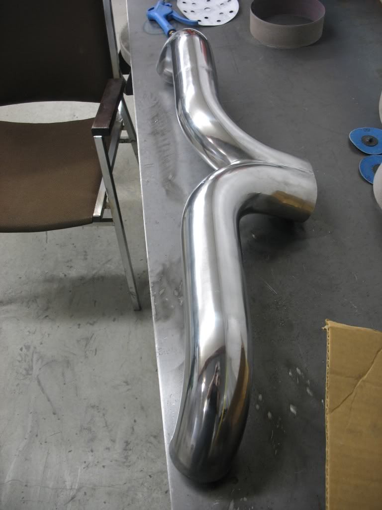

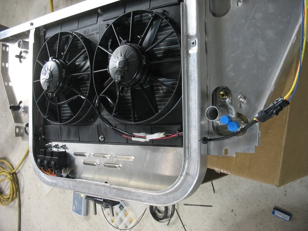

For the 55 AME Belair frame we are building, a custom dual intake for the LT1 (still needs to be properly polished), and becool rad module with nicely hidden wiring.
