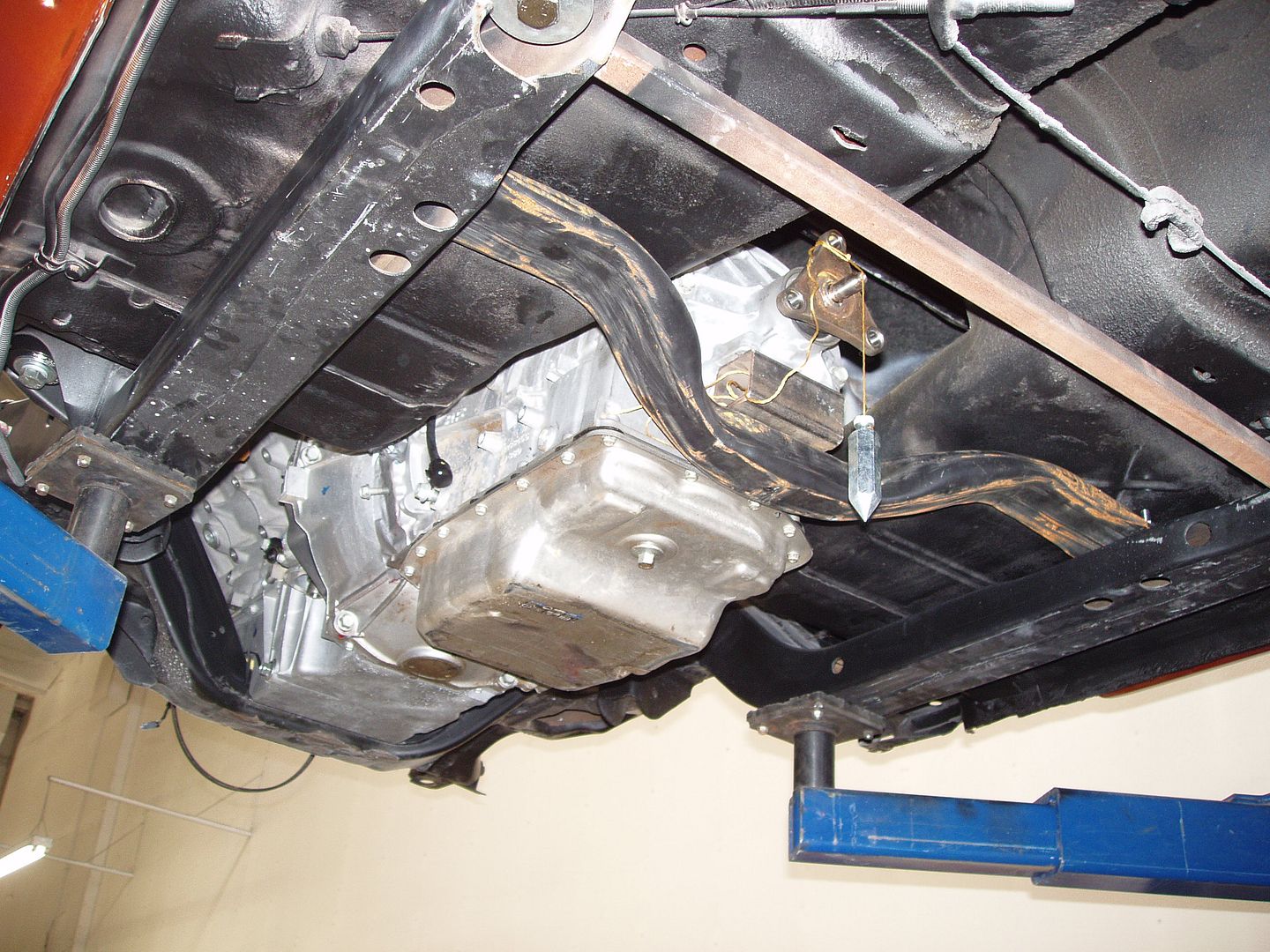

Here are some pics of a 71 Camaro we did with 2010 Camaro 6L80 Transmission.. Minor modifiactions required :D
These transmissions are huge! Take into consideration that 2nd gen drivetain sits offset torwards the passenger side about 1/2 an inch..
http://i1015.photobucket.com/albums/...P3080056-1.jpg
http://i1015.photobucket.com/albums/...P3080053-1.jpg
Pontiac G8 tansmission pan is shallower.. I am setting that up currently on a first gen..

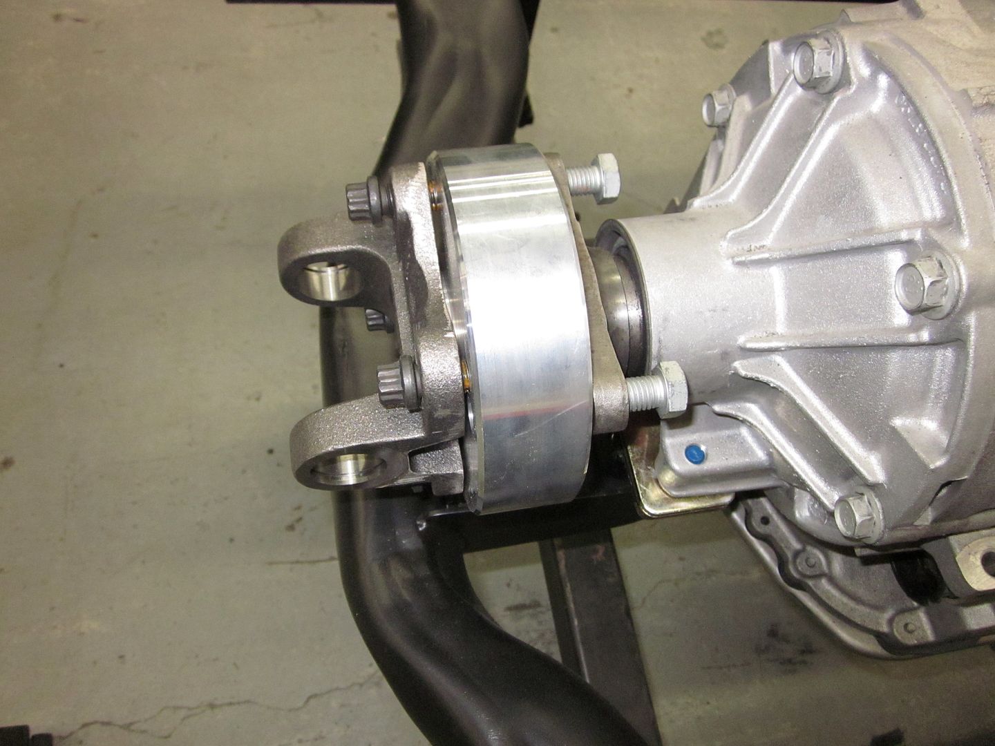

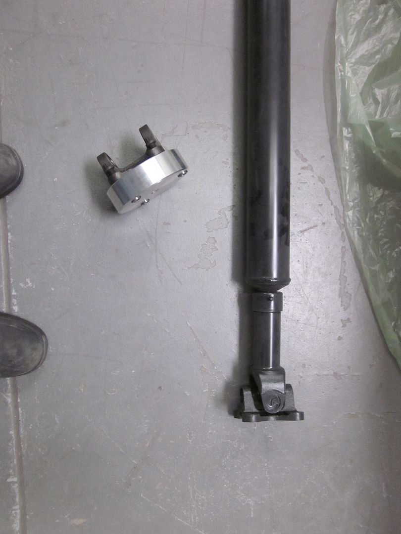

You will require something like this to build a driveshaft..
http://i1015.photobucket.com/albums/...IMG_0375-1.jpg
http://i1015.photobucket.com/albums/...n/IMG_0969.jpg

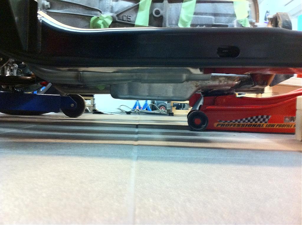

2 Attachment(s)
I have talk to Kyle at DSE about the problem, I have problem with the engine sitting to low in the frame, if I shall get the right angel i have to get it higher in the frame..:) so I have to cut the tunnel and rise the engine and then we are good to go:rolleyes:
I will check out Ls1tech
Its hard when you are stubborn,, and choose to go another way than anybody else:thumbsup:
KjellAttachment 29922
Attachment 29923

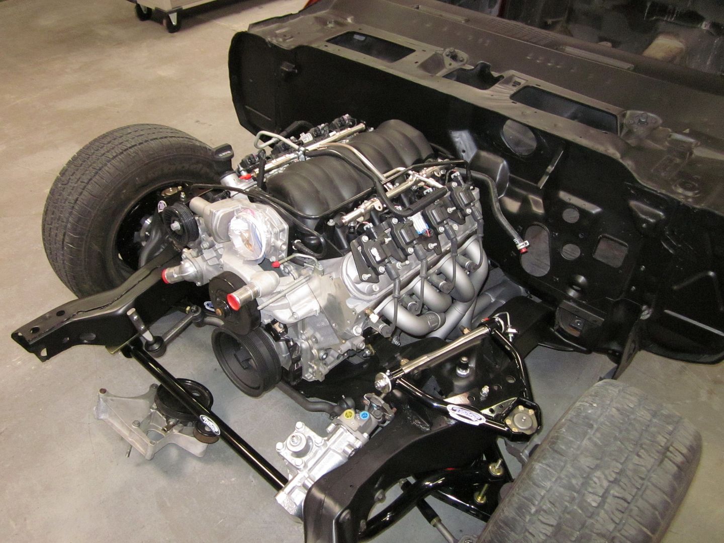

I don't know if this will help.. but here is a stock sub-frame with a L99..
http://i1015.photobucket.com/albums/...IMG_0378-1.jpg
I recommend that you use the DSE engine mounts.. It is designed to work with engine placement in stock location.. DSE headers will make it a simple for exhaust.. Use a 2002 Camaro oil pan or the new one that Mast just came out with.. I usually set up @ 2 degrees down on transmission angle & 2 degrees up on the pinion..
I hope this helps!

It sounds like Gonzo has you covered. He just showed you he has done exactly what you are doing in a second gen.
It also looks like you will need him to make you a driveshaft adapter. :yes:
