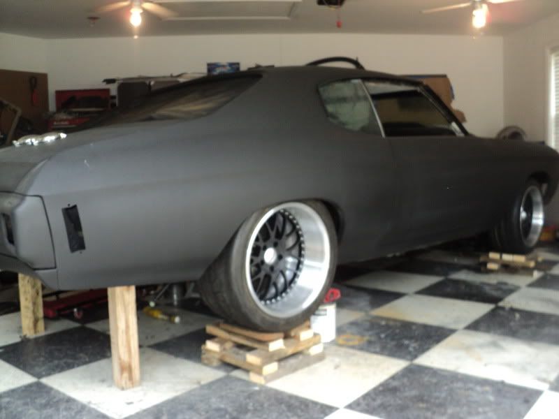

Well, I got the tires mounted today, I just can't get a good picture of the car with it still in the garage. The front end still has to be lowered about an 1 1/2" to match the rear which is at ride height. Hopefully it will come out of the garage in a week or 2 and I can get some real good pics.
http://i119.photobucket.com/albums/o...c/DSC00218.jpg
In this pic, ignore the door to fender gap, I had to remove the fender to retrieve a dropped window trim clip, and I didn't want to line it back up with out all four tires on the ground.

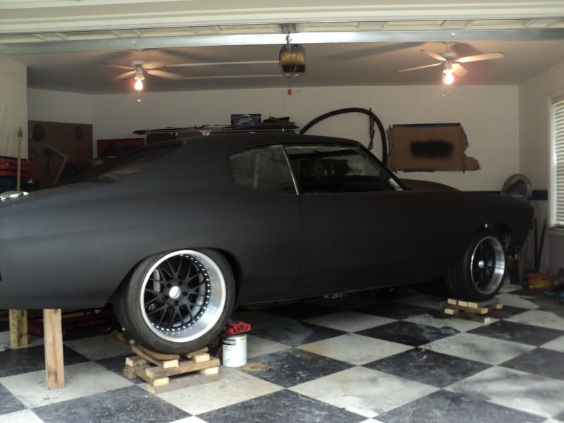

http://i119.photobucket.com/albums/o...c/DSC00216.jpg
Those rears are 345/30/19's Nitto Invo's Once again ignore the rear bumper gaps, it's just put on for the pic, all gaps on the bumpers are 3/16" just like every gap on the car, it's hell being a Machinist, your eye catches every gap if it's wrong, it just sticks out like a sore thumb.

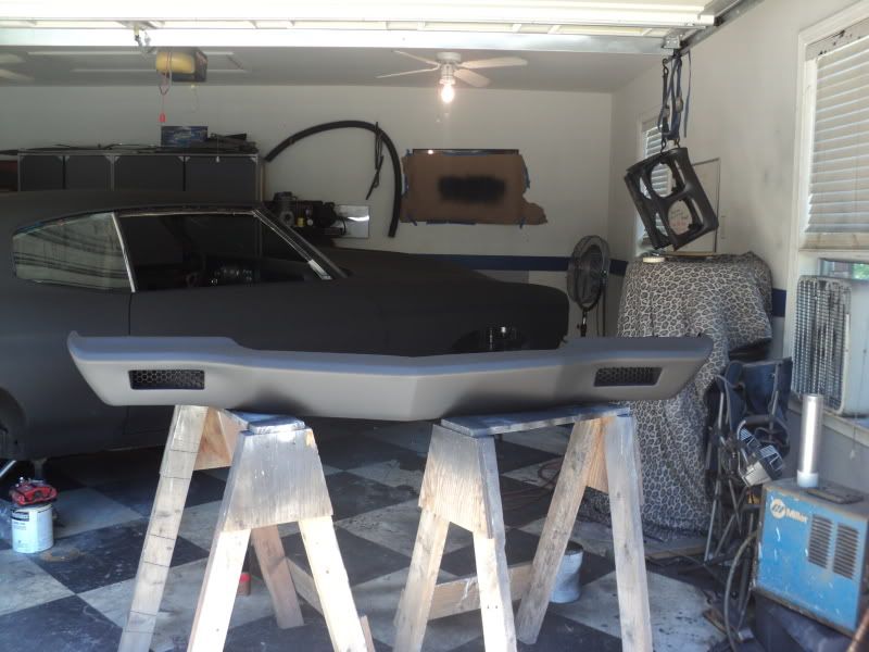

Working on a custom grill now to match the grills in the air intakes I made in the front bumper
http://i119.photobucket.com/albums/o...c/DSC00202.jpg

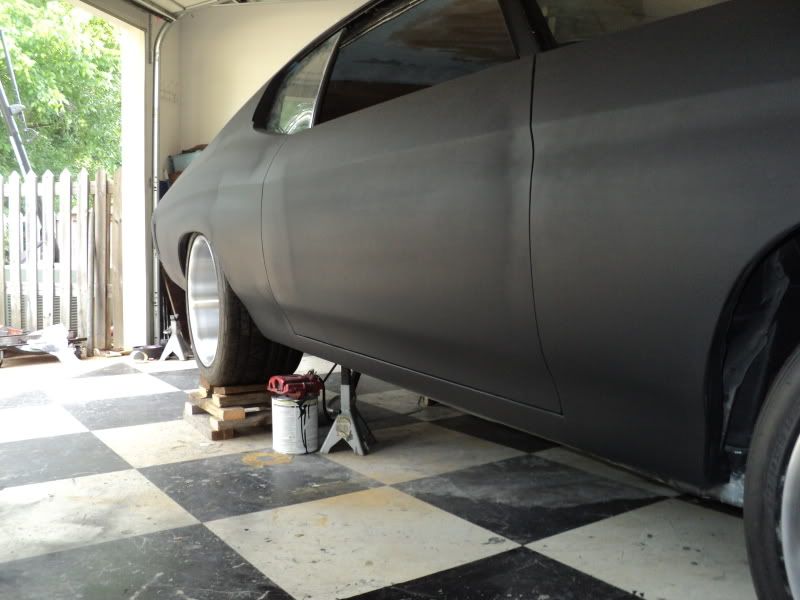

is that just primer on bare metal or did you add some filler to the body already? either way it looks really good. i'll have to pick your brain about the filling in the plate on the front bumper. i now know your pain on getting the gaps looking good.......
SS454 05-06-2011 07:32 PM
Bare metal,Welding, Grinding, Welding, Grinding, Welding, Grinding, SPI Epoxy, Filler, SPI Epoxy, now this is the first coat of Turbo 2K High Build primer.
