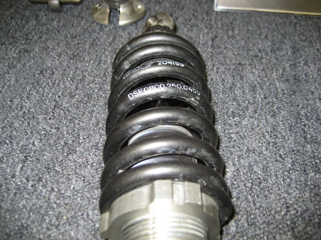

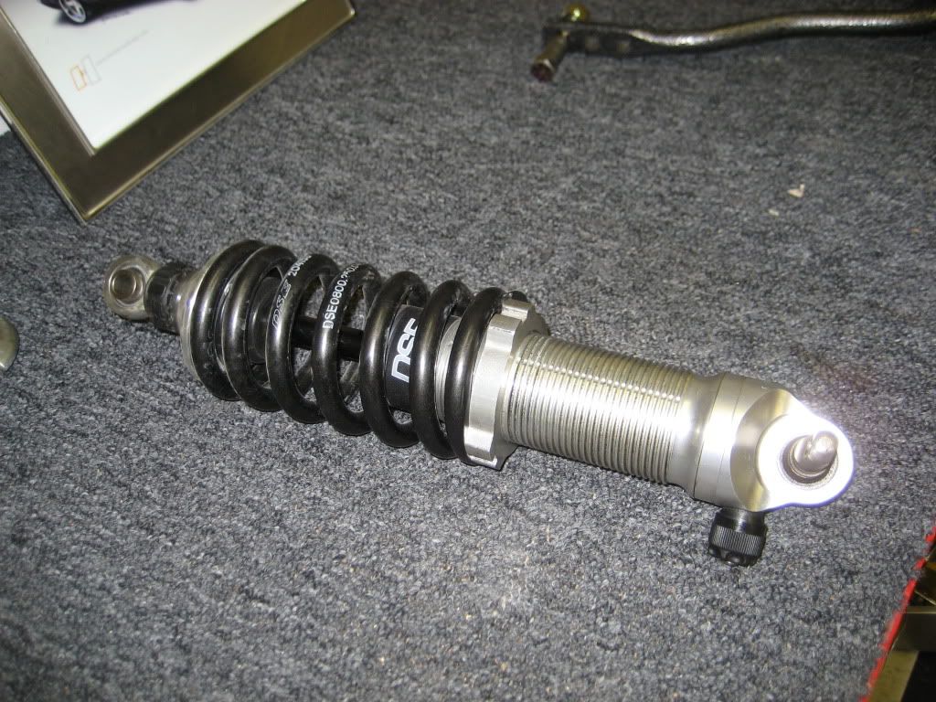

Here are my front's with the 450's adjusted for my all aluminum big block which is a little heavier. Mine showed coil bind but I had them in there with my original iron block. That was an oversite when prodigy put the frame under the car. It's only an 8 inch spring so keep that in mind. I've since went to a higher spring rate hypercoil. You may as well set your car up about 1/4 high because those DSE springs will settle.

WTH..... Todds is cranked way the hell up there. I'm not even close to that yet. Mine are maybe 40% of the way up the shock. In the previous replies, it was implied that the adjuster should be no more than about 1/3 up the shock.....so thats when I started to worry that something wasnt right.....
So I'm not even close to what Todd has cranked up.....so up we go until I hit the right ride height.
I bought the whole set-up through Musclerodz, fully assembled by DSE etc....its the 450 SBC spring in there..... theres no way my car should require a heavier spring to get to a decent ride height.....its just not cranked up high enough....got worried for no reason

Todds are ridiculous and wrong... No way I'd run that short of a spring cranked up the body like that. I'm totally serious. Typically a 1/3 of the way up the body is all that is required. More than that is a "half an inch" one way or the other. So I would be buying LONGER springs if I had Todds set up.
In your case -- you still should TRY for not much more than a 1/3 up the body... and if you're springs won't raise the car on a ONE FOR ONE basis - in other words adjuster up 1/2 and inch the car should rise 1/2 and inch -- then you need more spring.
Remember that the "shock" has a ride height length - and a minimum and maximum etc - and you want to stay within those ranges as set by the manufacturer.
