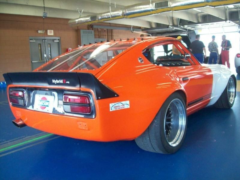

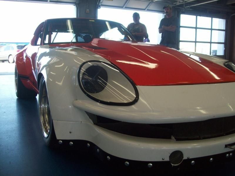

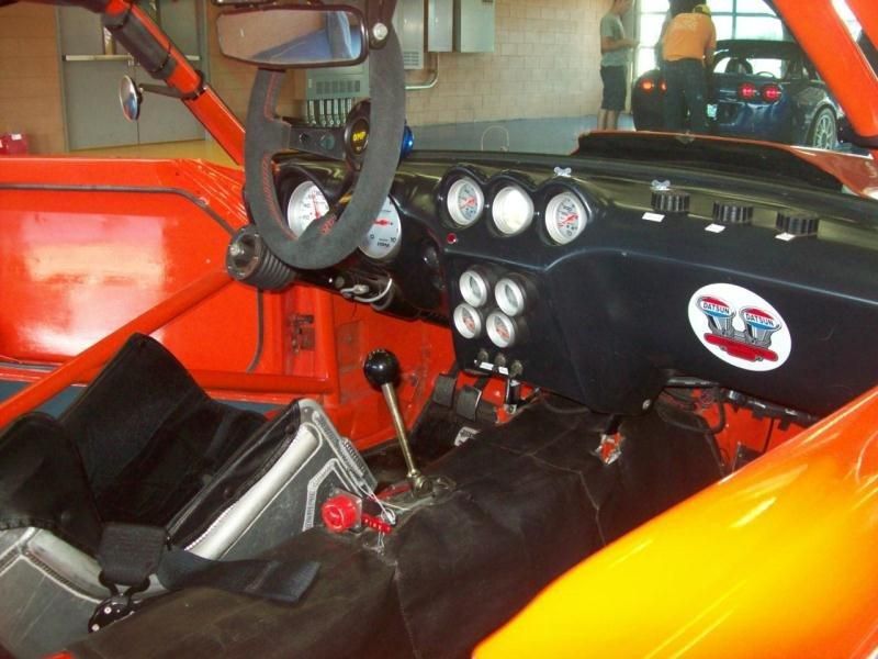

Payton King 06-21-2012 08:06 AM
I saw this car at a recent private track day I attended
Someone still makes the wide body stuff in glass, but I cannot for the life of me remember who he said. This car has an LS6. Good luck on your project!
http://i1138.photobucket.com/albums/...g/18099072.jpg
http://i1138.photobucket.com/albums/...g/18099074.jpg
http://i1138.photobucket.com/albums/...g/18099073.jpg
