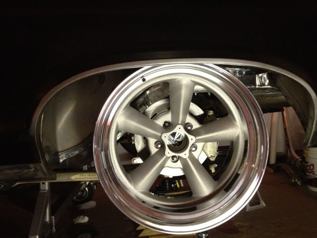

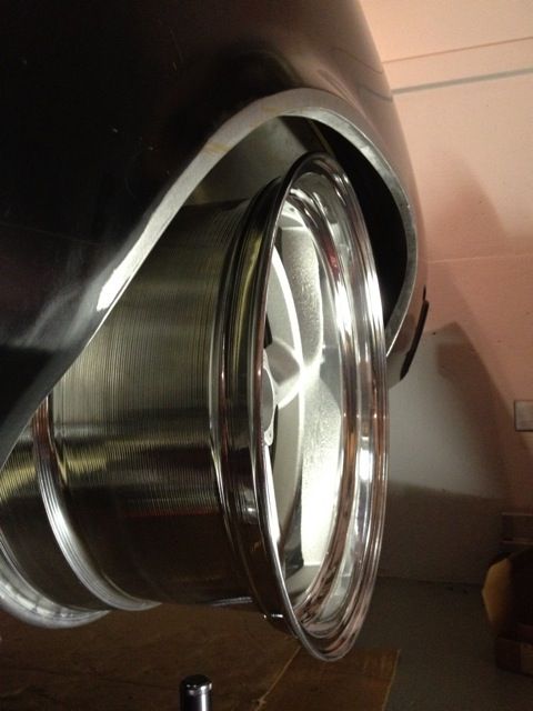

BBC71Nova 08-31-2012 08:34 AM
Here are some pics. As expected those 11" brakes are swallowed by those 18" wheels. Maybe one day the budget will allow me to upgrade to some big boy brakes :lol: :lol: .
This is ride height. I'm going back and forth about swapping out the G-link shock crossmember with a DSE like setup. That way I get another 1" lower and exhaust clearance.

Looking up showing outer wheelhouse to wheel lip.

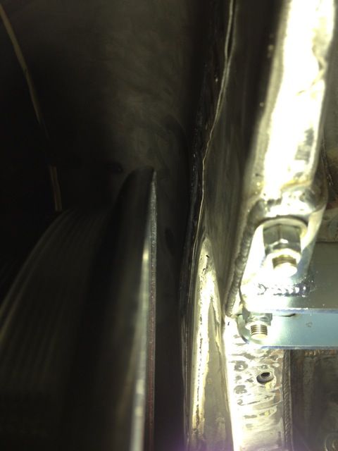

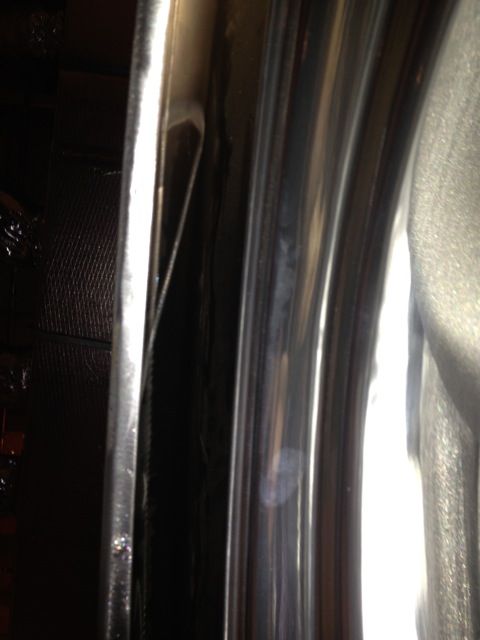

http://i33.photobucket.com/albums/d6...ect/wheel3.jpg
Showing inner wheelhouse to wheel lip.

Payton King 08-31-2012 09:52 AM
Dude
That does suck. On the brighter side your car is not painted. Bulge those quarters a tad. Normally on a 69 Camaro you want about 3/4 an inch from tire bulge to lip. Not sure on a Nova.
I am digging those wheels

Hate to say it, but, you won't be OK with a wheel and tire package that wide, on a stock wheelwell. You have to have room for articulation of your axle which when it occurs is going to mean that the tire sidewalls are going to rub. ***EDIT: I see from reading your other thread that you have installed mini-tubs...I think if you have a problem, it will only be at the inside upper center portion of the outer wheelhouse, where it curves inward.

BBC71Nova 08-31-2012 03:11 PM
I now think it is gonna be ok. Not ideal but ii don't think it will even run at full compression. I had a 13.1" combo stuffed up in there and it didn't much rub at full compression. This combo is narrower by over .25" per side.
Vince@Meanstreets 08-31-2012 04:20 PM
you might just have problems going into driveways. can you roll that outer lip more?
