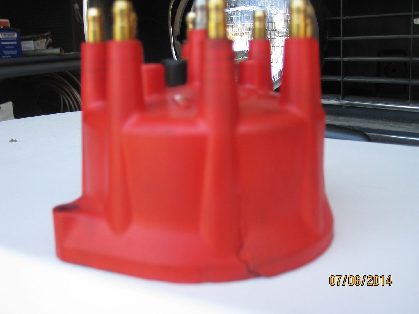

OK, so here is a pic of the cracked cap that I replaced that I thought would fix the issue.

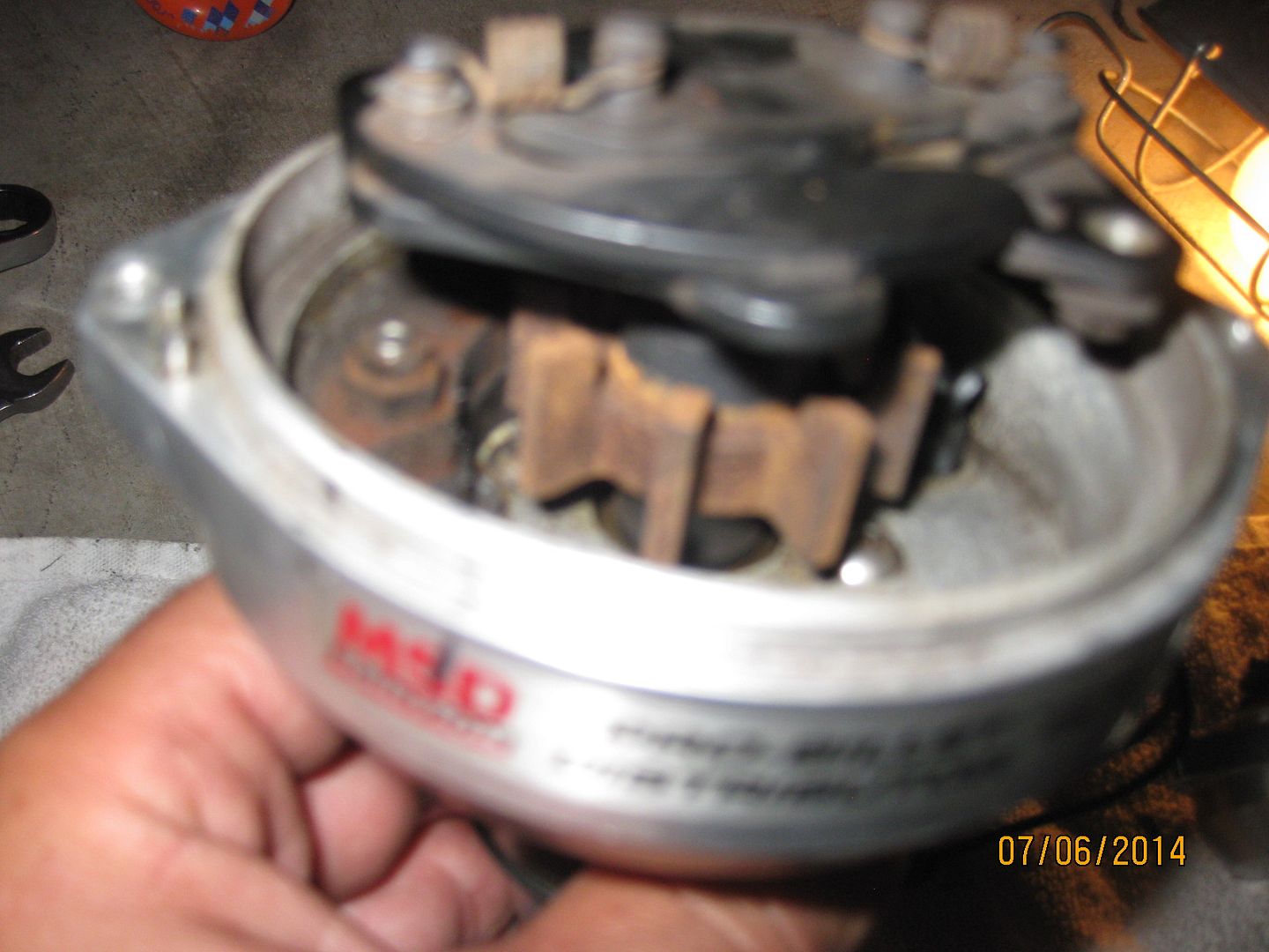

Hers a pic of the rotor I just pulled off. Notice the broken portion to the upper left of the screw. That's a weird deal there

That cap looks short, are you sure it's the right one?

Pic of rusty reluctor

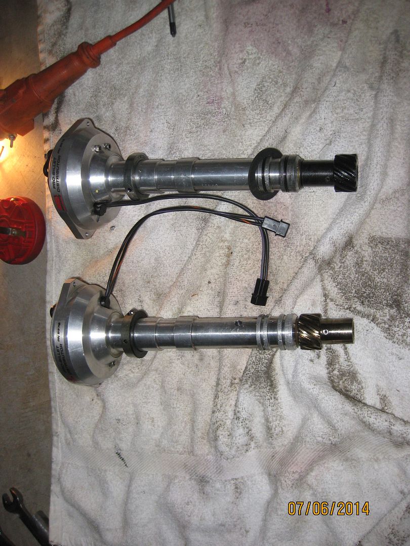

Track Junky 07-06-2014 04:03 PM
And now the million dollar question. Above is a spare MSD distributor. Below it is the one I pulled out of the car with the bronze gear (which is still in good shape.)
Can you guys tell me why one gear is higher than the other because I don't have a clue.
http://i851.photobucket.com/albums/a...torpics046.jpg
Vegas69 07-06-2014 04:23 PM
Different application or the gear is on upside down.
