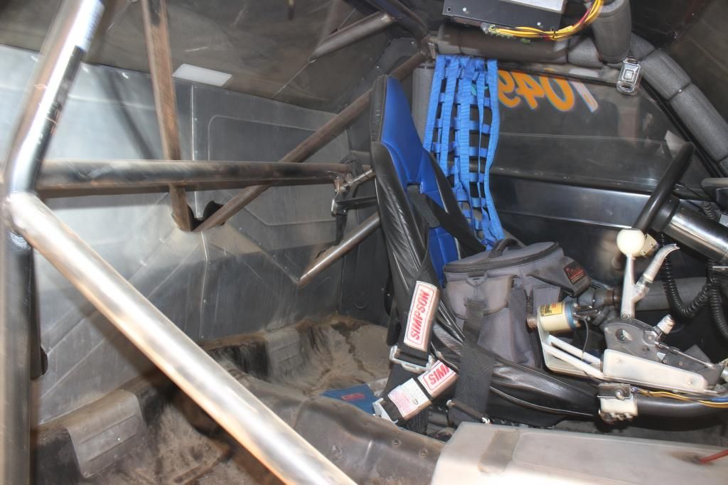

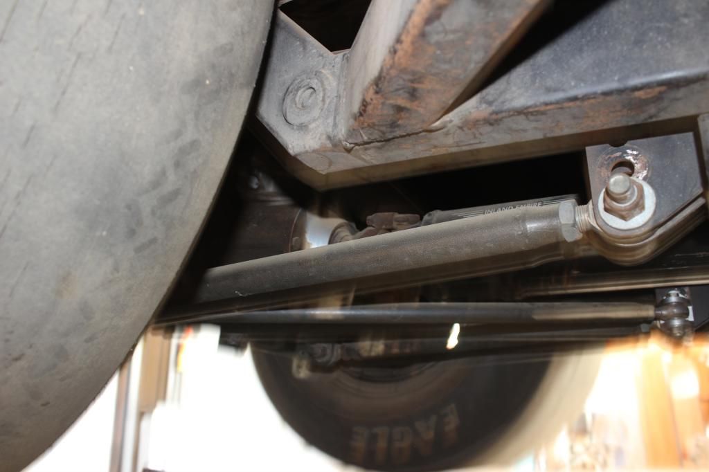

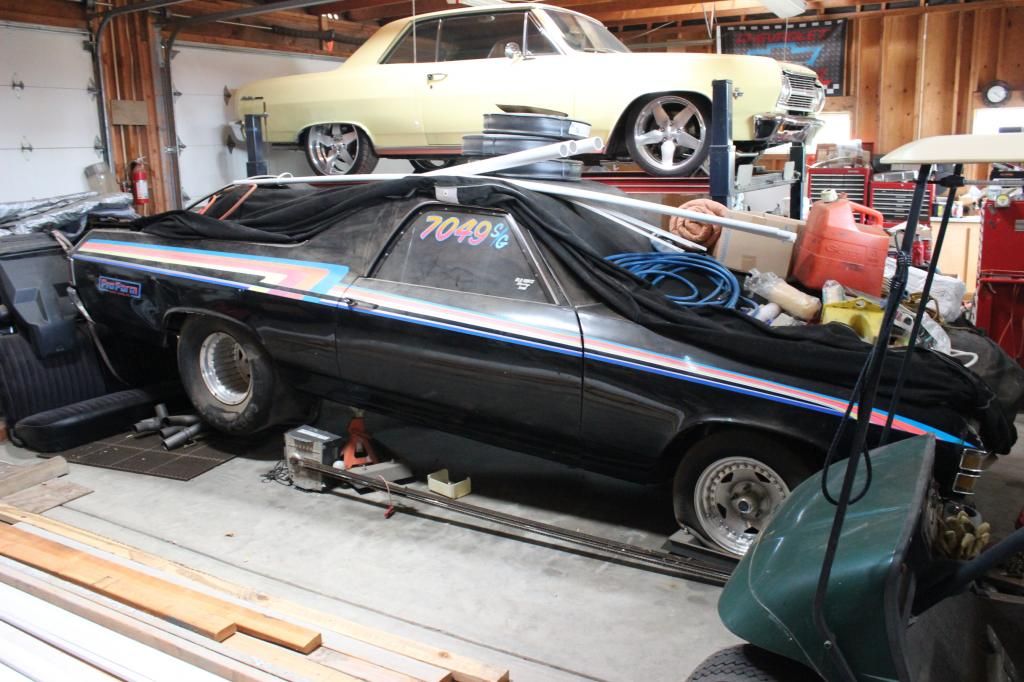

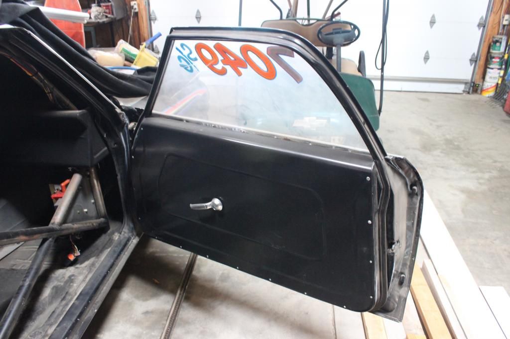

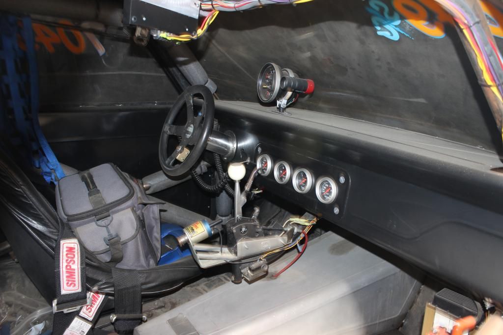

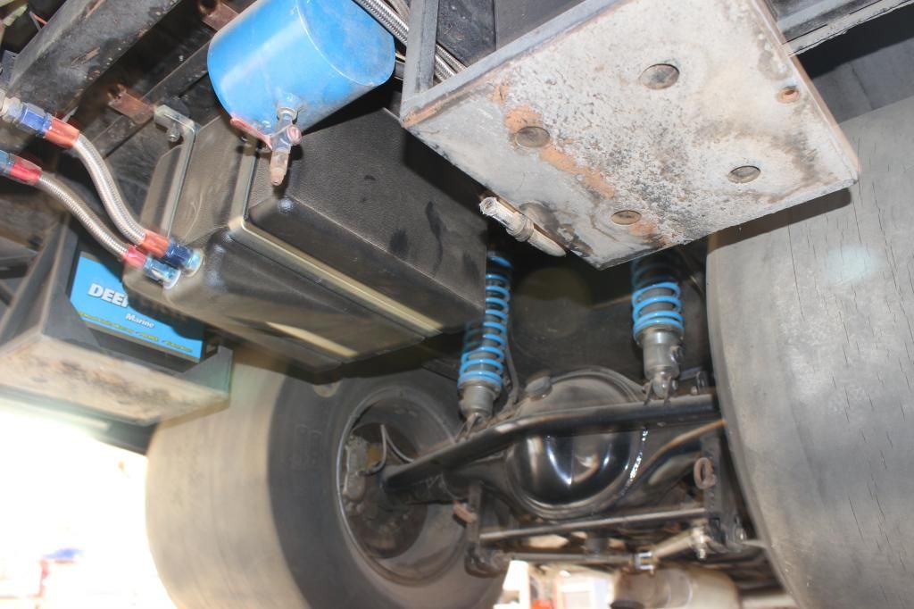

I ran over to his house this morning and snapped a few pictures of this Elky. You can see all the junk on top of it, so I wasn't able to get a good picture. And the lighting was horrible, so excuse these really bad pictures.

Not too bad, trans tunnel done, cage looks good, back halved, clearanced for big tires , your more than half way there.
700hp LS and a Mag T56 and ford 9 in the rear will be the way to go. You should be able to use the rear lower link mounts.

Looking at the pictures...would I be able to use that rearend? Just thinking the rear rims would have a ton of offset on them.
The cage actually continues all the way into the engine bay too....so the chassis has to be stiff as hell already.

Pick ups and "Elkys" do NOT make good track cars.... Check out any of the times on USCA -- or Good-Guys and you'll see the trucks just aren't competitive, despite having some pretty good drivers. They just don't hook up.
I used to have a 69 El Camino SS with a 396... was the worst driving car ever. All it ever did was light up the tires.
If you want to build a track car - at least start out with something that isn't burdened right out of the box. This stuff is hard enough and costs enough as it is without trying to turn something that doesn't work into something that is now just expensive and doesn't work.

Most of those cars Greg speaks of are still tri 4 bar rears with not a lot of tire. With a clean sheet suspension a lot of improments can be made. Long arm 3 link, cantillever coil overs and watts comes to mind.
Let the rear end go if he wants it. Your probably better off starting fresh. Theres a bunch to change on the current rear end housing.

I know some weight will get added back into the car. For starters, I'd put in a glass front windshield. I'd also put the guts back in the door to have working windows. A bigger fuel cell would add a little weight.
