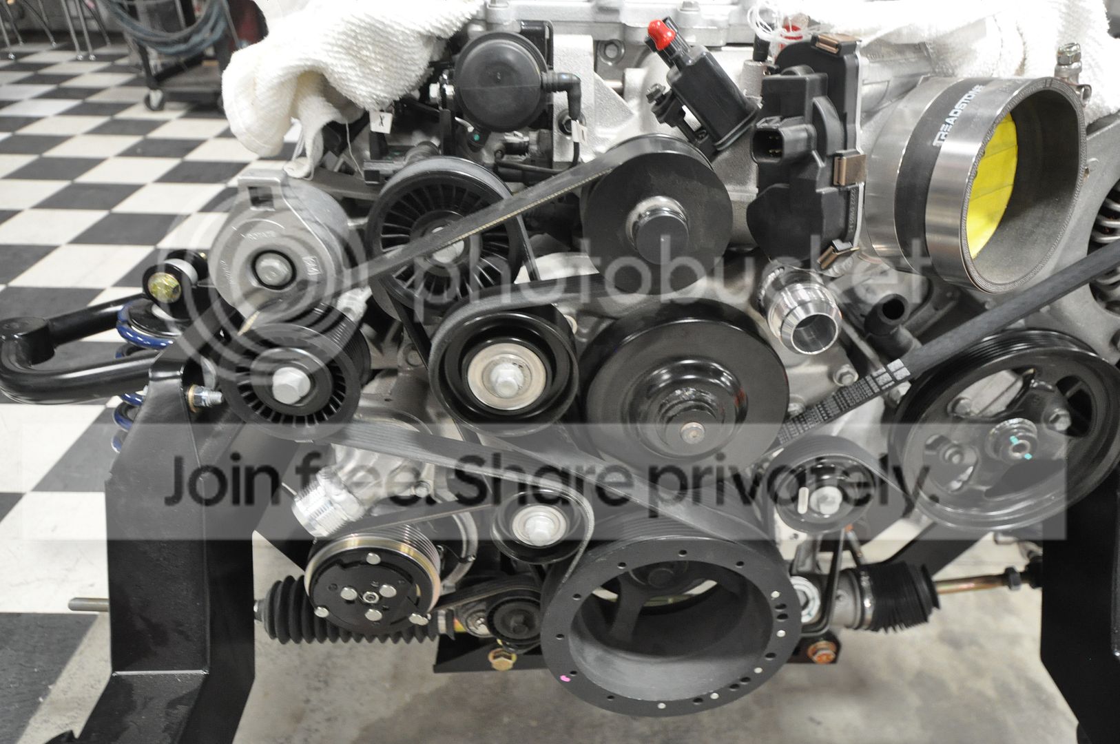

ironworks 05-18-2015 04:12 PM
http://i616.photobucket.com/albums/t...-2013010-1.jpg

jimmythehand 05-21-2015 08:18 AM
Does anyone know anything about the setup from street and performance? It looks like from the picture on bottom left, that the a/c and alt are both relocated up, so notching would not be needed.
http://www.hotrodlane.cc/lsasetups.jpg
ironworks 05-21-2015 10:22 AM
All their stuff I have used is JUNK.
Just use the Vette bracket system for the engine drive. Its a simple swap with proven GM parts.

kwhizz 05-23-2015 03:41 PM
Look at the belt wrap on the supercharger pulley on that Southern Performance set-up versus the GM set-up.........After being at Wegner and seeing how violently the tensioner pulley bounces around under load on the Dyno.........I would say that the SP setup would be good for Idling around town only........Like Rodger said.....It needs to be driven off the crankshaft pulley by itself........Just my $.02
Ken
