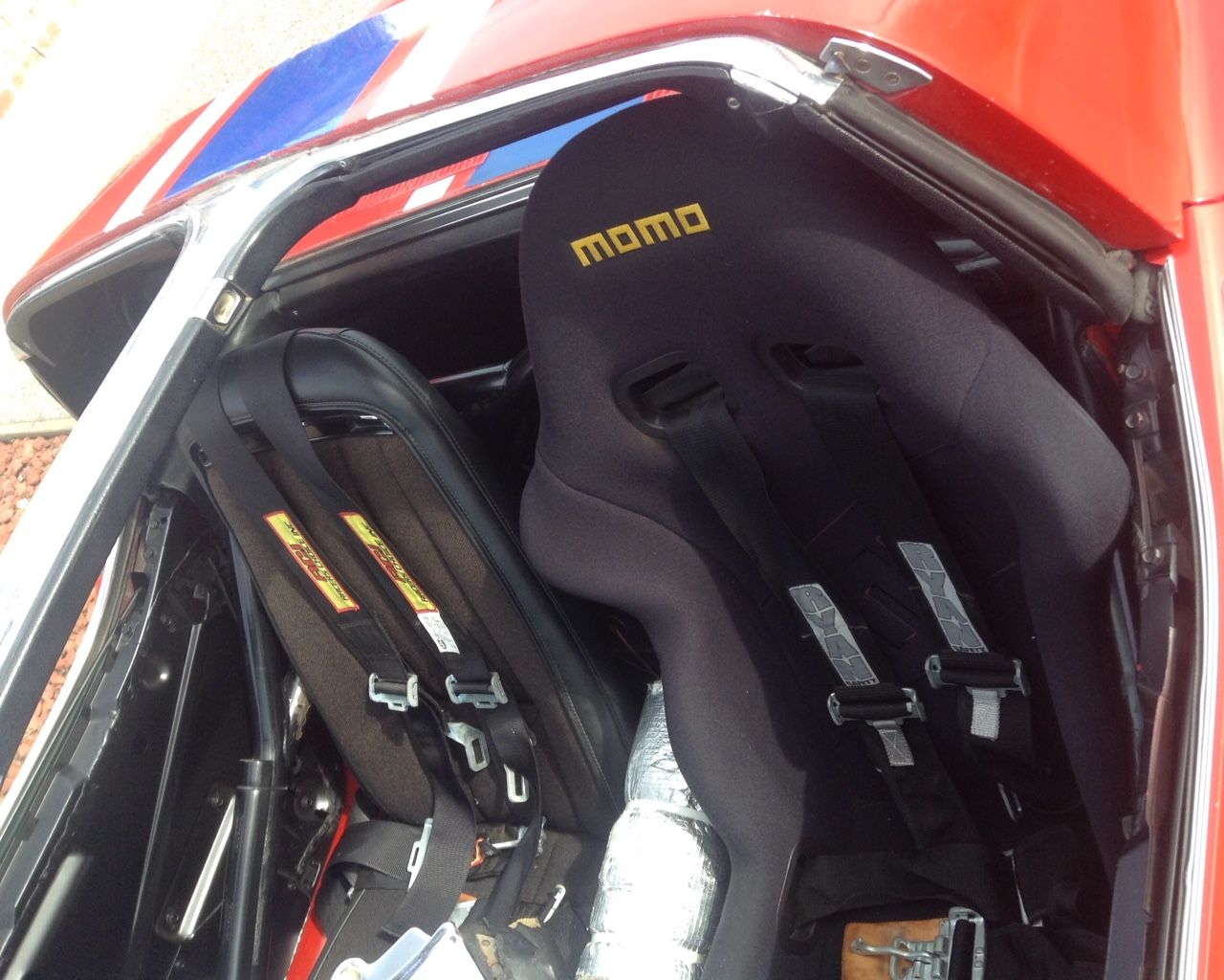

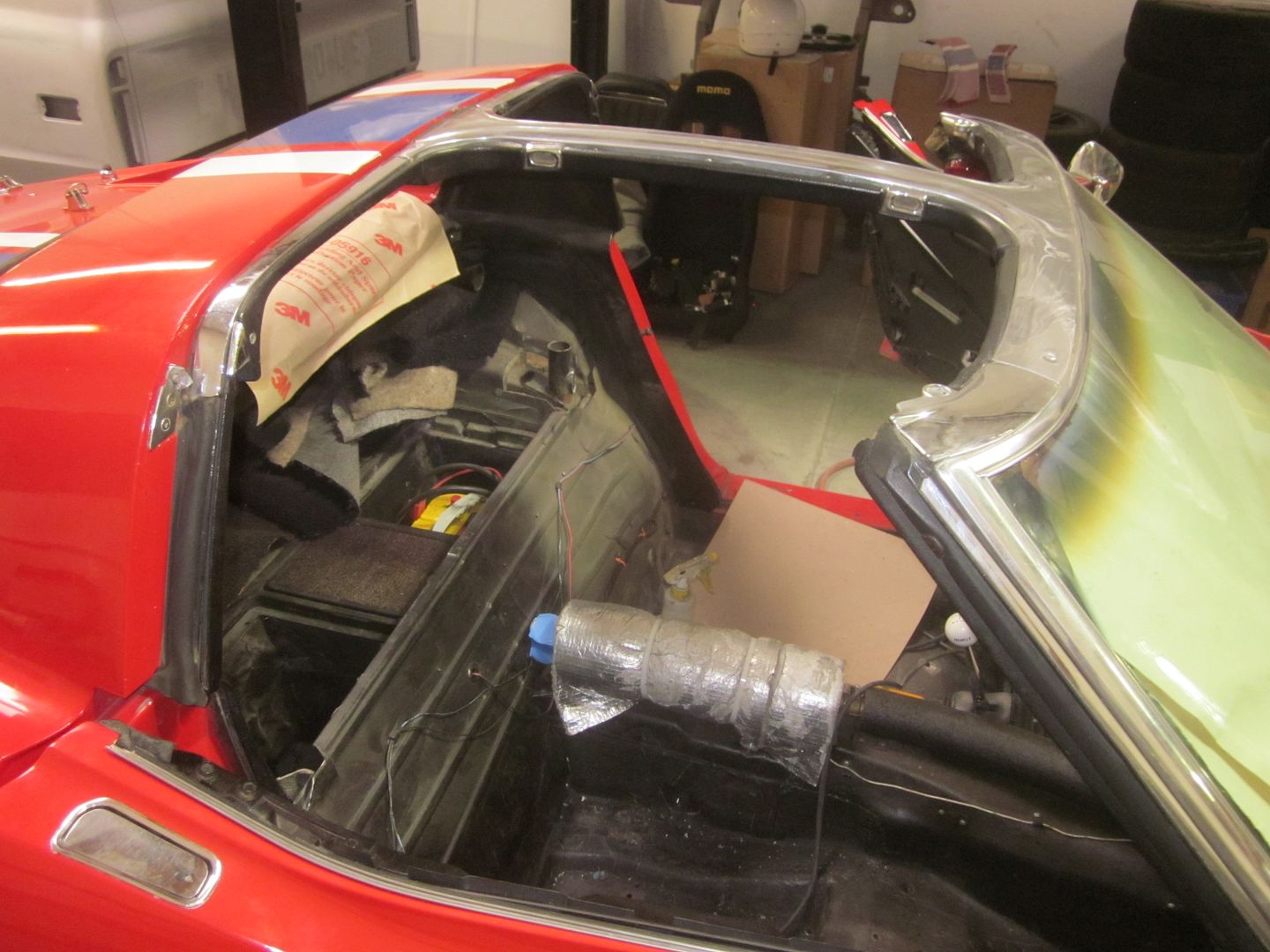

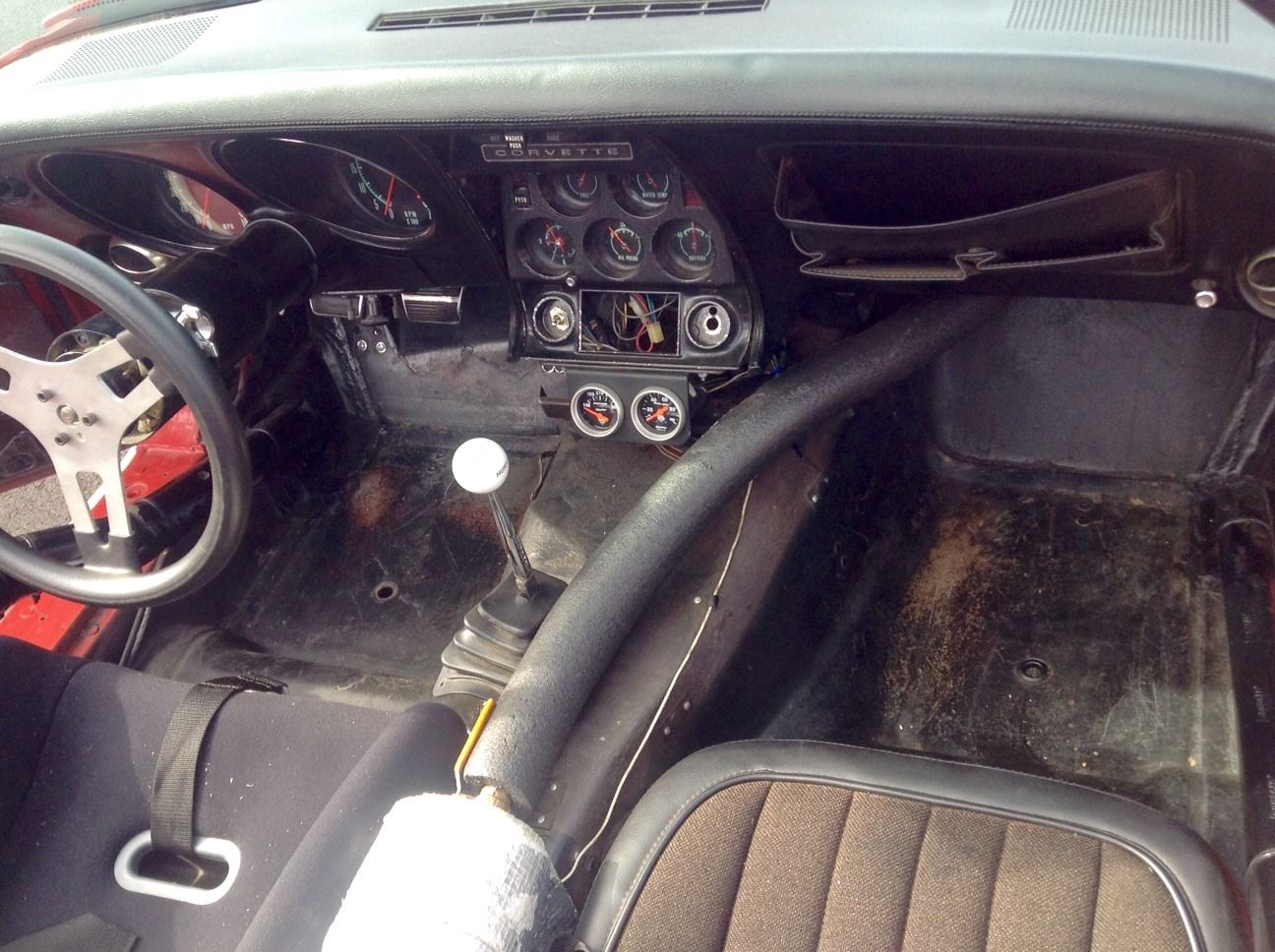

The whole suspension & diff have been completely rebuilt.. I will show that progress later.. Here are some images of what the interior looked like.. Accusump in the car had me a little worried but now has been relocated.. The roll bar that was done by Maier a long time ago was re-done too.. It just was not that easy for to drive.. so the changes are being done to fit me as the primary driver..
http://i1015.photobucket.com/albums/...psvft8at0z.jpg
http://i1015.photobucket.com/albums/...psdj3wkfr7.jpg
http://i1015.photobucket.com/albums/...psertw2lbp.jpg

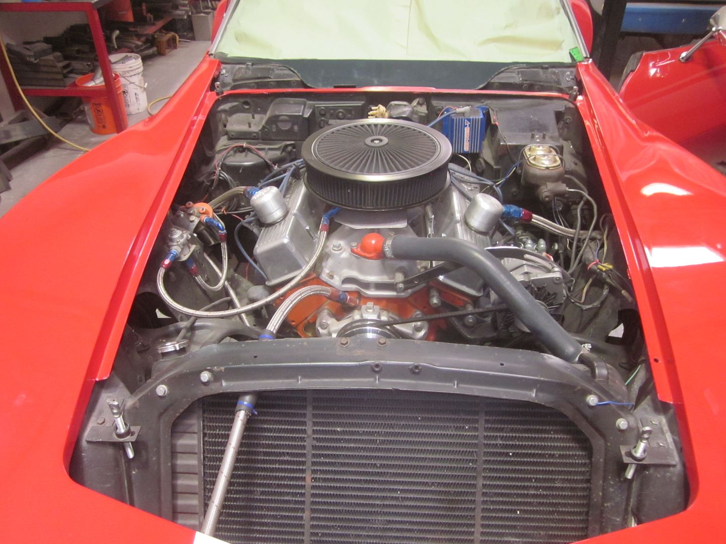

I will admit that the 13:1 SBC does fit the attitude of the car.. But I want to make it easy to drive on the street.. In SoCal we are blessed with pretty much great yearly weather.. plus my daughter luv's it when I pick her up from school in the Old Corvette! Here is what it currently looks like.. Have not changed much here yet..
http://i1015.photobucket.com/albums/...psicr0hu6t.jpg

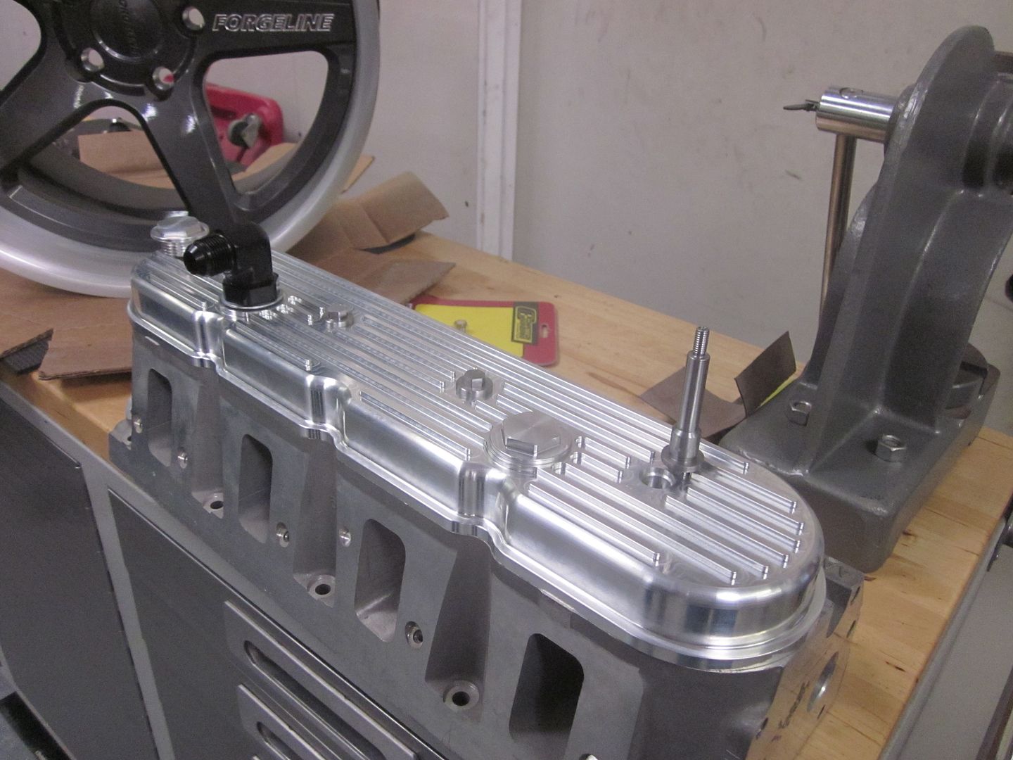

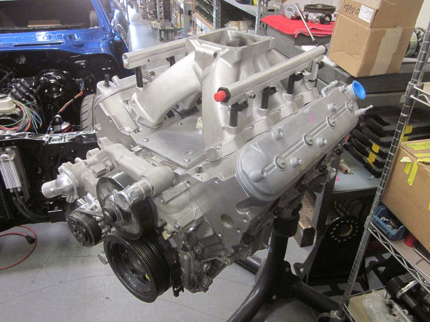

I am only gathering parts right now for the LS Conversion.. But promise I will be doing it in a traditional way.. Here is my set-up motor.. I will be running a single plane intake.. Plus Have these valve covers being made right now so that I can put the GM cross flag logo on it...Plus doing my belt drive system to fight the issue they have on pass side for heater hoses.. I will detail the engine bay.. Goal is to make all the changes & test the car.. then blow it apart for paint & detail!!
http://i1015.photobucket.com/albums/...psocokbbh2.jpg
http://i1015.photobucket.com/albums/...psgnlibgrf.jpg
