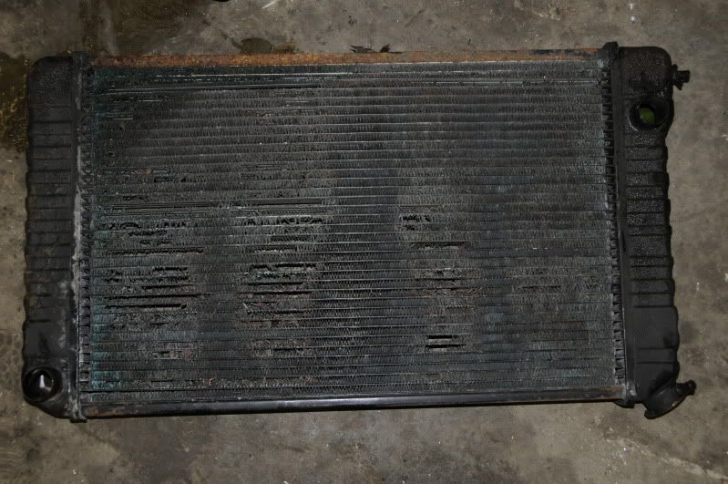

Erik, you are completely right. I changed the rad because the old stock one was cooked,

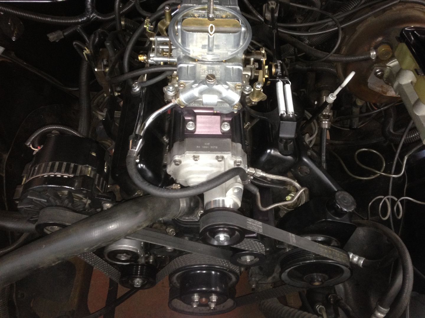

You are right though I was overthinking it. Definitely made a big step today correcting it. Well the big problem was definitely a cant see the forest for the trees moment. The water pump was spinning in reverse. I had modelled my build off of another guy online. I failed to notice the way he and I routed the serp belt was reversing the water pump.
This is the way I originally had it set up
http://i223.photobucket.com/albums/d...912_1024_1.jpg
http://i223.photobucket.com/albums/d...0/DSC03100.jpg
This is the way it should of been
http://i223.photobucket.com/albums/d...1C946D5228.jpg
http://i223.photobucket.com/albums/d...B204CAD237.jpg
I just thought ok smooth side of the belt to the smooth pulley, perfect! Not exactly though, it was definitely spinning backwards.
Sieg you are completely right, the water pump flowing reverse was just simply opening the thermostat all the time and the coolant was constantly flowing.
As you can see above I rerouted the belt so now the pump is flowing in the right direction. That took a few mins to figure out.

I just realized rerouting the belt was a total waste of time in terms of reversing the water pump. It made sense in my head and sounded like it was the fix but in reality the water pump is still spinning the same way.....
http://i223.photobucket.com/albums/d...8FD6917146.jpg
on the plus side with the new routing I get much better wrap on the blower pulley and the tensioner is at a better angle.
I'm still not convinced it's spinning the right way however. I'm going to flip the thermostat over just for ****s and giggles. If I flip it over and it performs properly then I know the water pump is reversed and was just blowing the thermostat open.
