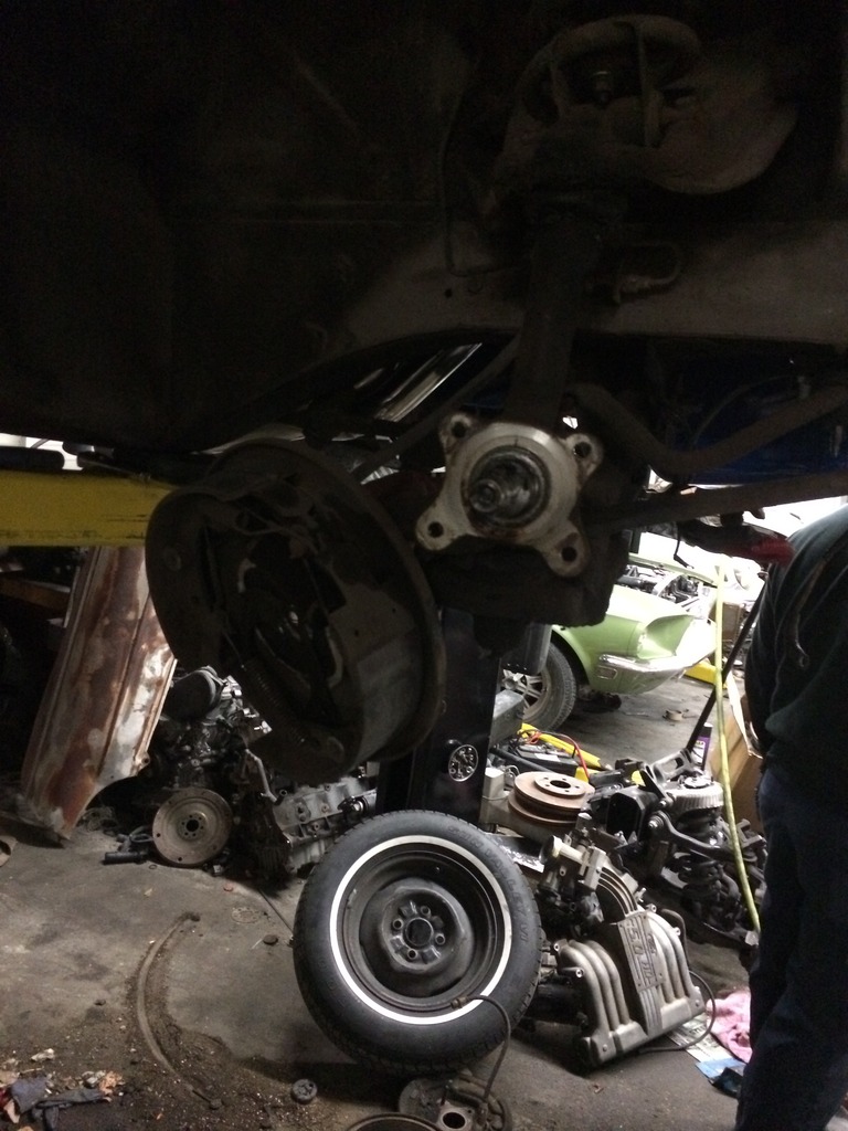

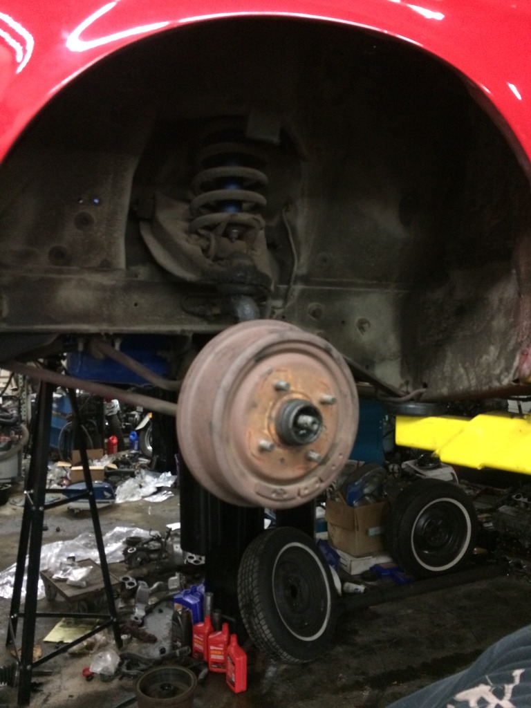

I started out with this:
Attachment 56703
No one wants to stop on drums brakes anymore.. and they're made for the 6 cylinder, so that's probably not going to work, either.
Attachment 56704

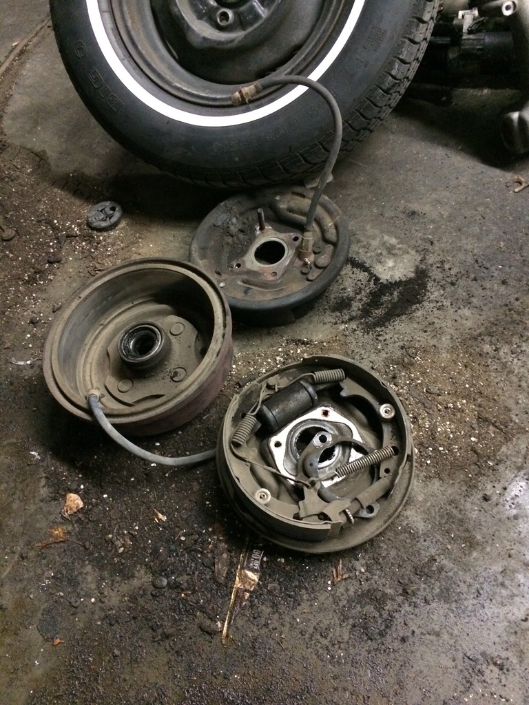

Pulled the drum and here we are. What's cool about a 1966 and up Mustang is that they wear the same spindles for V8 and 6 cylinder.
Attachment 56705
Attachment 56706

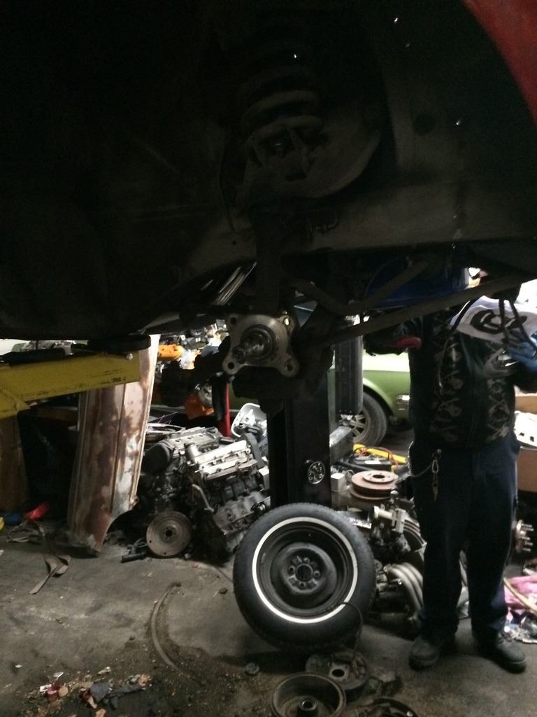

Attachment 56707
So tear all the brakes off, including the lines and you're left with a bare spindle. Ewww. Naked.

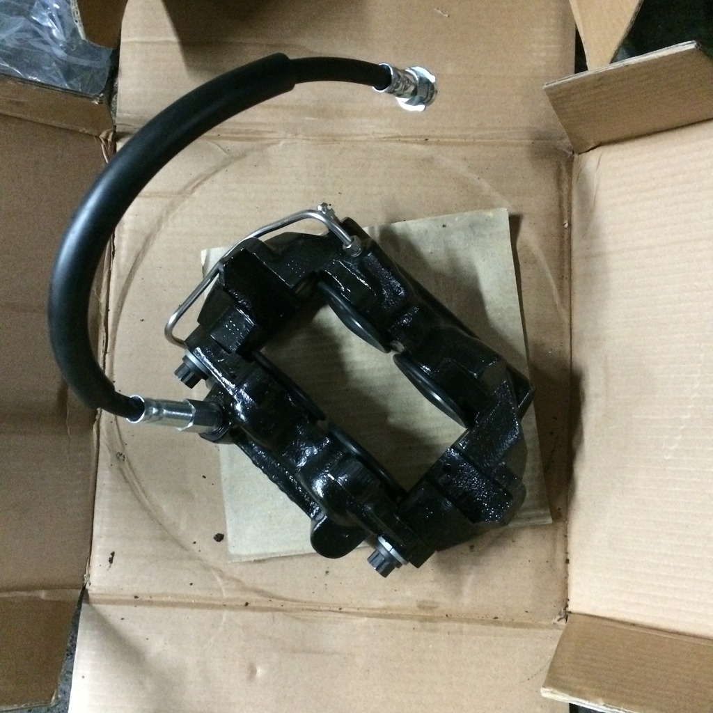

This is the attachment for the new 4 piston calipers. It slips on behind the backing plate.
Attachment 56709

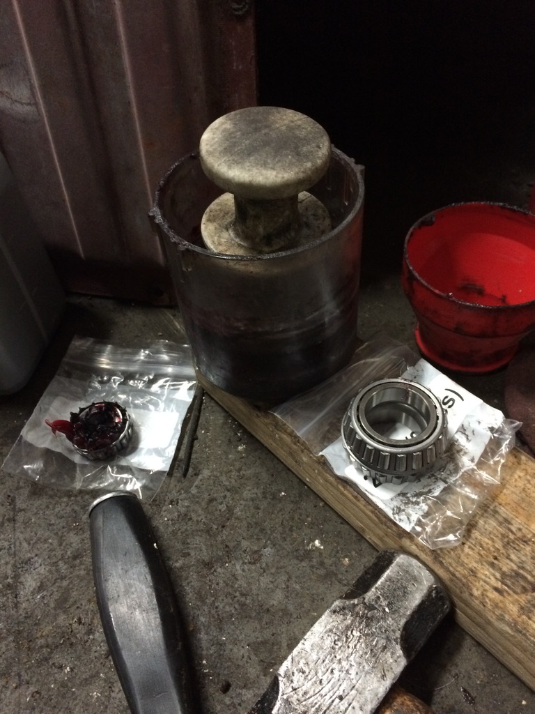

Attachment 56710

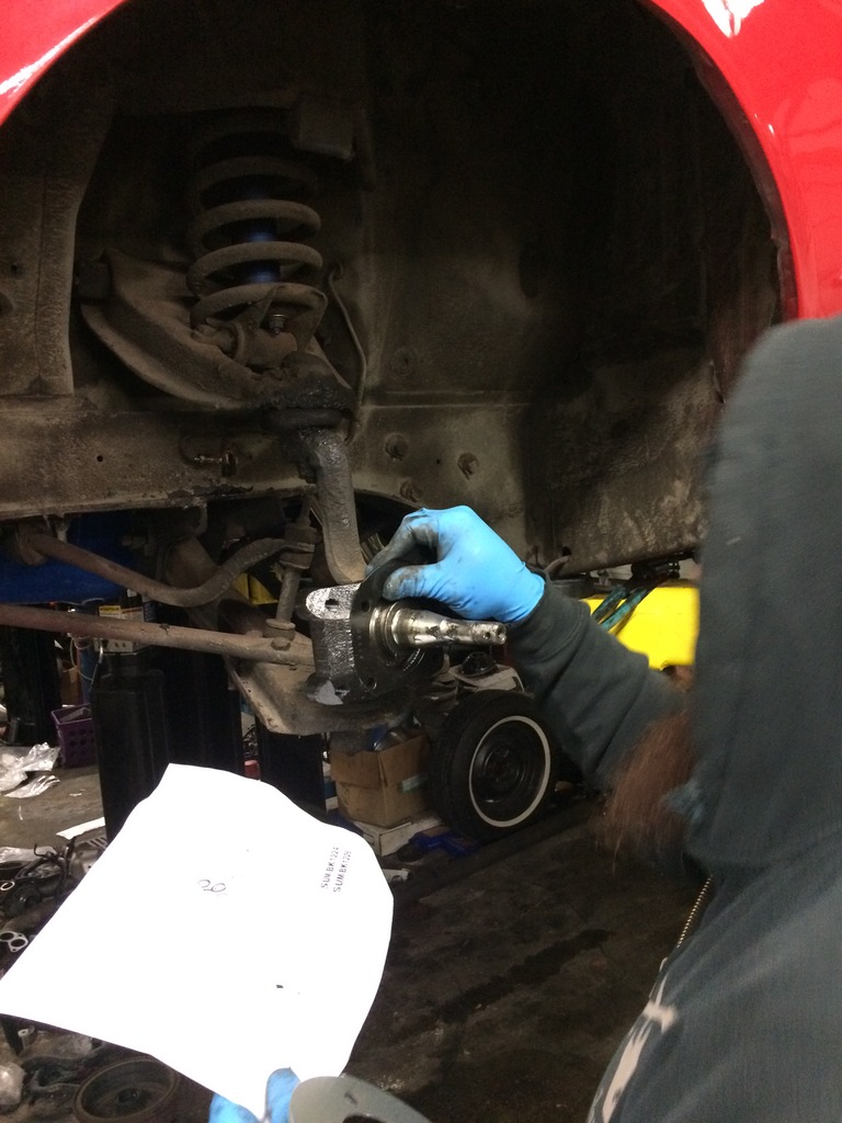

If you haven't bought one of these tools, it will change your life. Not really, but you wont have to pack bearings against your palms and end up looking like a toddler after a bad spaghetti episode.
Attachment 56711
Tap the wheel seal in and install the front bearing, washer, spindle nut and cotter pin after setting bearing lash.

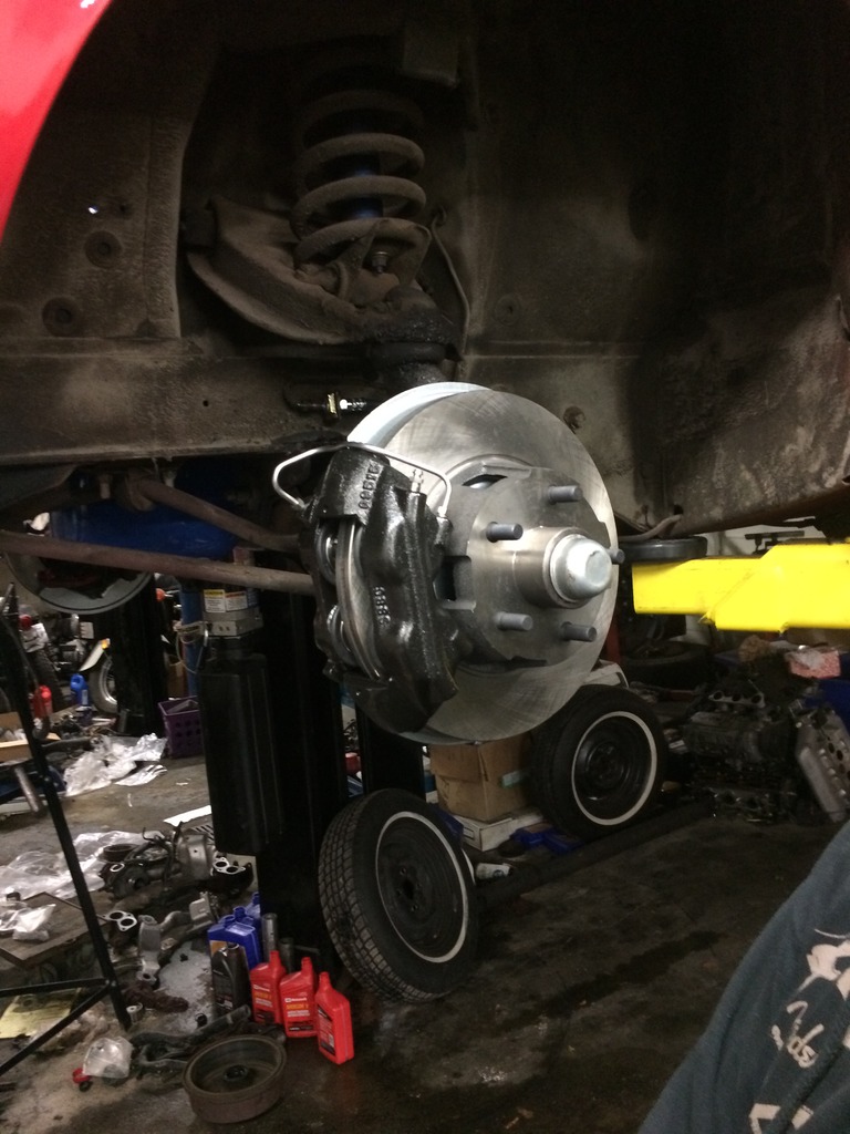

Okay. Rotors on, backing plates on.. calipers.
These Mustangs have weird (to me) caliper attachments. Instead of a banjo bolt, they thread directly into the caliper. One washer.
Attachment 56714
Attachment 56715

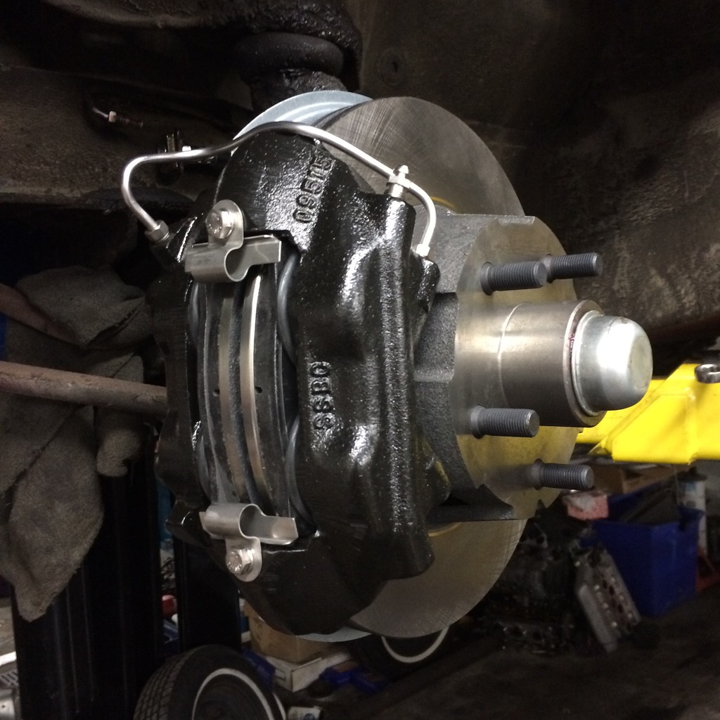

Toss them on there with a little bit of blue Loctite, slip the pads in and install the pad retainers.
Attachment 56716
Pretty good, methinks.
Attachment 56713
