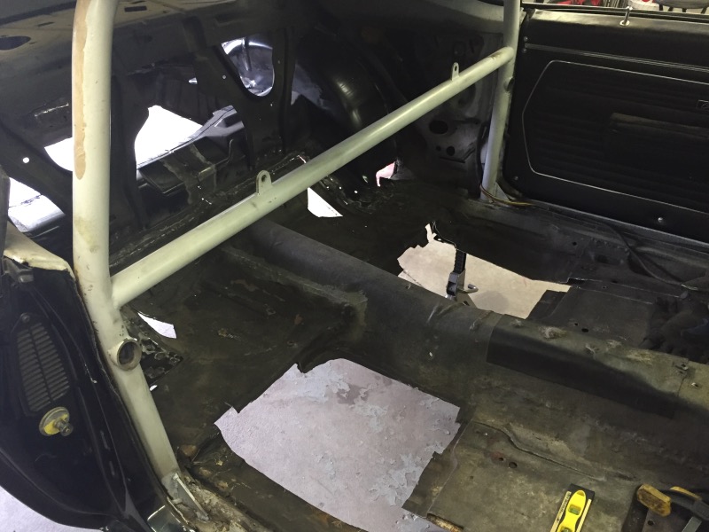

SSlance, we way have met but I'm not sure. Yes the rear of the car will be similar to Al's car other than I'm fabing up most of it from components from the 2nd gen camaro and the nova. The car had all ready been cut up in the rear so it had nothing left stock wise that the kits we are working on would pertain too. The photo of the rear end table was to verify my dimensions and how I'm setting up my rear end, some of the things I will be doing may be of value to the engineering department at a later date. That is why a few things were measured and checked on the jig table. Here is a shot of what I started with when it still had the 12 bolt in it
Attachment 58206
