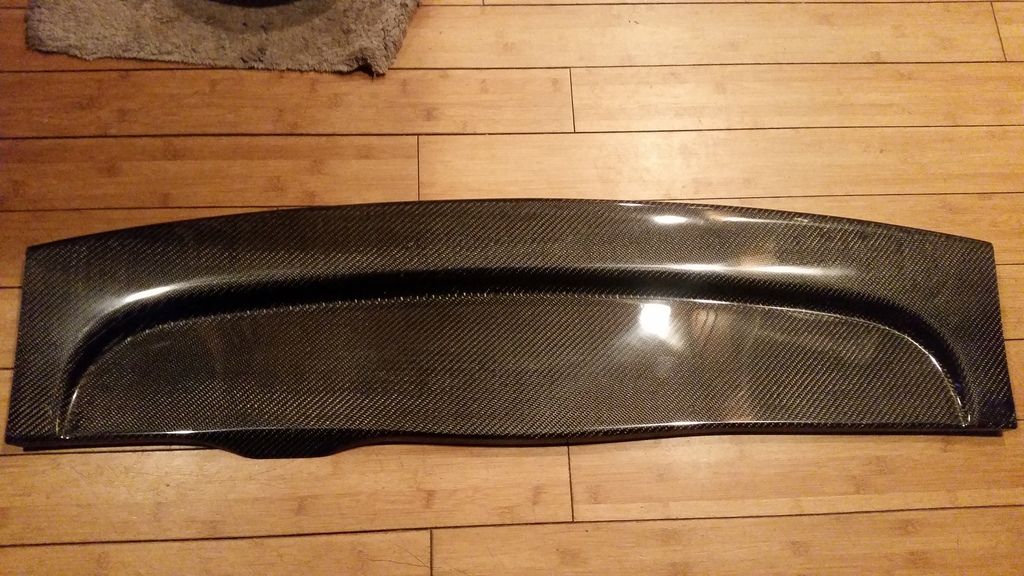

Carbon fiber dash arrived yesterday. Unfortunately not completely satisfied with the product. But once installed, hopefully people wont not notice the flaws

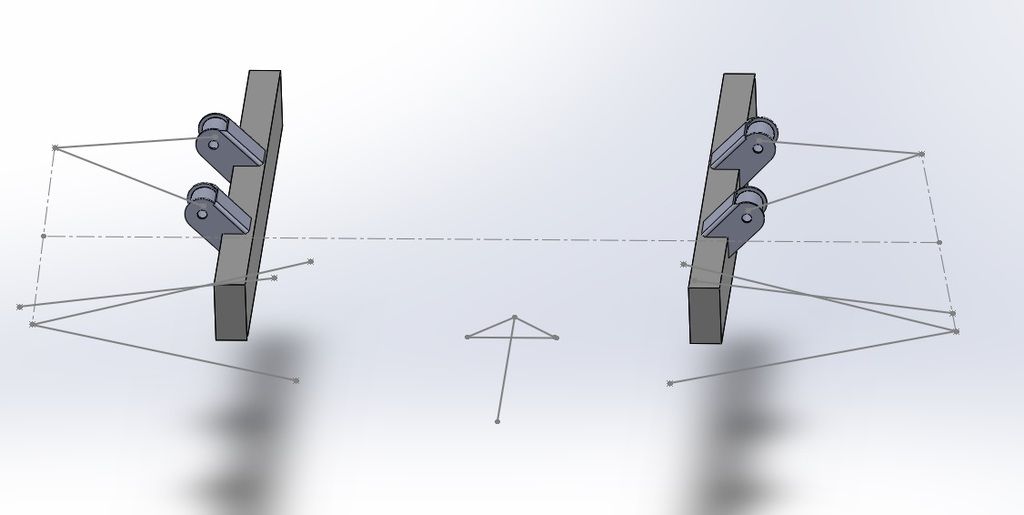

Started on all the rear suspension bracketry but that quickly came to a halt since i havent recieved the zl1 rear diff yet. Need to get that so I can build the rear tube subframe and lay it out in a way i can mount the rear diff and make the brackets for the lower control arms in a clean manner.

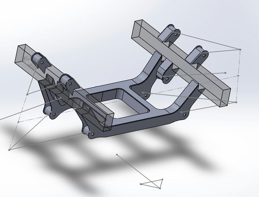

ZL1 rear diff arrived at the end of the week. This thing is stout and lil bigger that I thought it would be. Still trying to figure out if I wanna do a bolt-in tubular rear crossmember which will mount the rear diff and lower control arm brackets. Or do a permanent weld-in sheet metal assembly thats fully boxed in. Hopefully I'll get dimensions of the zl1 rear diff and have something figured out by the end of week so I can get back to making progress on this truck.

But Ive now sourced the entire zr1 brake setup, ive bought a few more parts as well. I machined a small fixture to hold the c6 vette spindles in the mill so i can modify them for the 7deg taper i'll be using. Rear subframe is 100% done and getting laser cut now. Finishing up fixtures in solidworks this weekend so i can start building the control arms.
Trying to figure out what steering rack i want to run on this thing so i can start on the front crossmember and suspension brackets off the frame. But have no idea on what to use. Progress should hopefully pick back up though since ive finished all my small projects that i started the last few months.

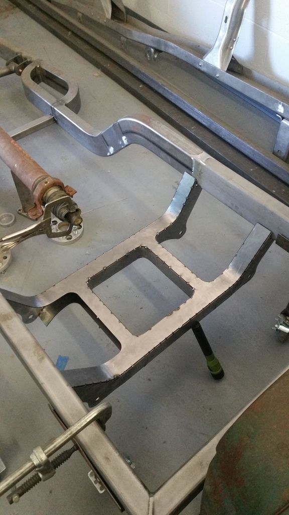

Heres the subframe. Some sheetmetal is missing but its fully boxed in and should do the trick. I also made a jig that will slip over both frame rails and locate all the brackets, etc....

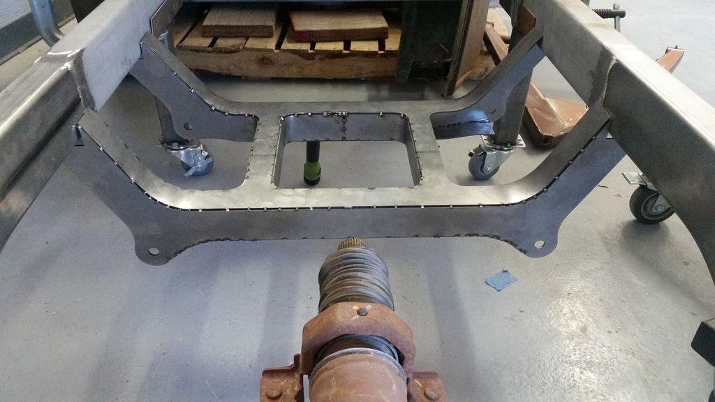

Got my rear crossmember mostly tacked up, still have a few more pieces to add until its complete and fully boxed. Going to weld the assembly with it welded to the frame rails i think to try and keep everything straight.
