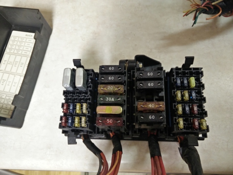

andrewb70 07-18-2016 07:02 PM
Couldn't wait and dragged all that stuff into the house. This is out of the Riv and probably what I will end up using (or a part of it).
http://www.pro-touring.com/~andrewb/cougar/707.jpg
Andrew
