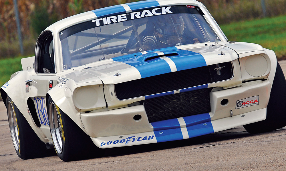

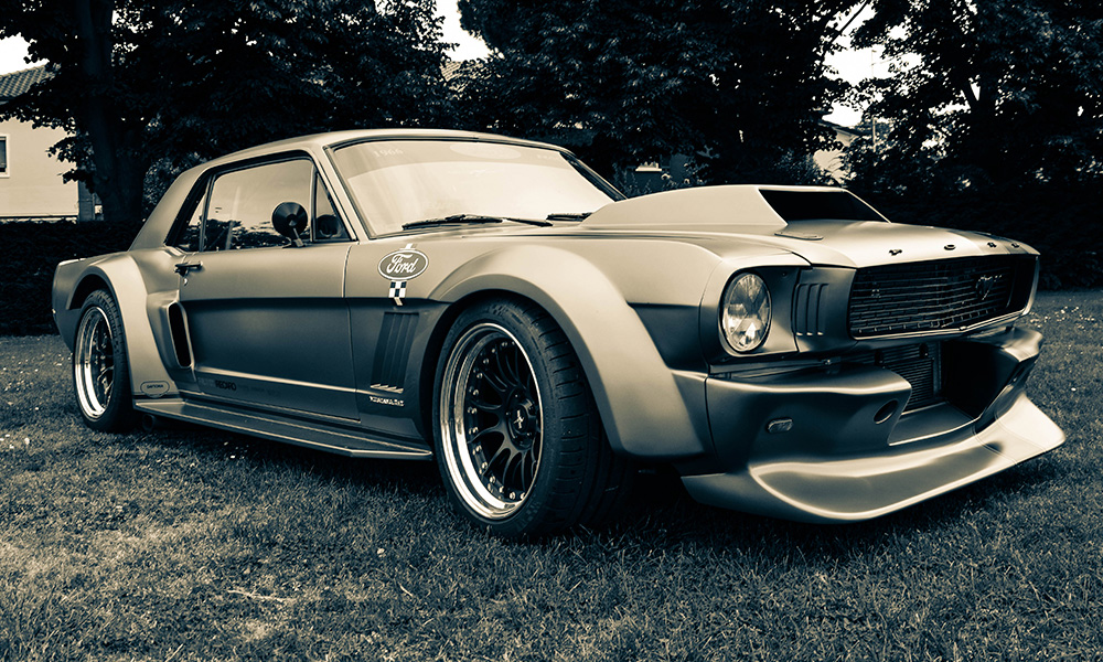

GrabberGT 08-03-2016 08:23 AM
So which direction are you going with this?
http://www.maierracing.com/wp-conten...ter-kit-01.jpg
OR....
http://www.maierracing.com/wp-conten...ace-kit-01.jpg
How are you modding your suspension to get even more drop?
Mike Maier 08-03-2016 01:53 PM
It will resemble Franks 65' Fastback (Lower Image), however with a street tone to it. To lower the car is has been fairly easy. For the rar we used our MOD2 rear suspension and making new lower control arm brackets to account for the reduced ride height. This led into fabbing clearance for rear end and driveshaft. For the front we also used the same MOD2 front suspension that has been in the car and made new control arms and modified spindles
