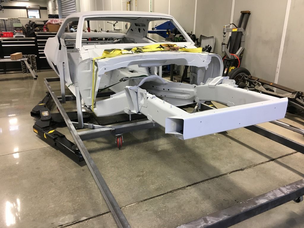

CamaroAJ 05-18-2017 02:09 PM
Originally Posted by glr0212 (Post 659008)
What subframe do you have?
Well, about that, I have a C5 Corvette frame :lol: I am running carbon anvil fenders though so thats an extra 1.5" per side thats helped a ton so far.
http://i25.photobucket.com/albums/c8...o/IMG_1126.jpg
I know its going to be close no matter what I do so I may need to cut into the fenders and get a little more bulge to clear. typical, always lacking in the bulge haha
