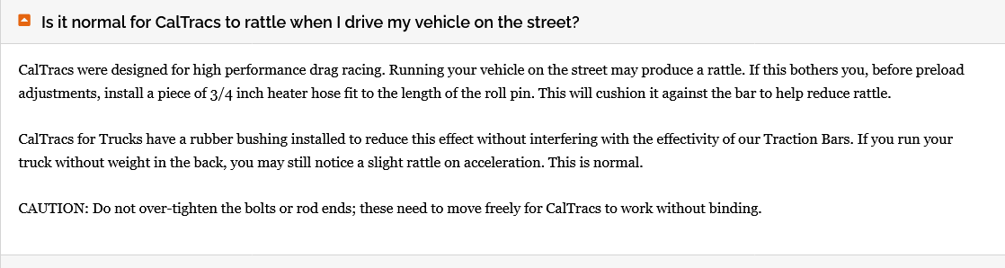

Here is what I did. Just cut the shock mount portion of the Caltracs brackets, and trimmed them to fit inside the DSE plates. Very simple modification, works just fine and has been like this about 2 years now. The only thing I don稚 like about the bars, is the rattle they can create. The slop in the heims and the front bracket annoys me when I知 on rough road. It痴 not bad enough to remove them though. lol

1 Attachment(s)
Here's a possible cure for the rattling taken directly from the Caltrac website.
