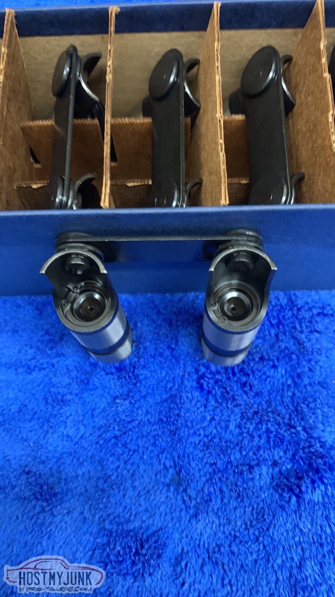

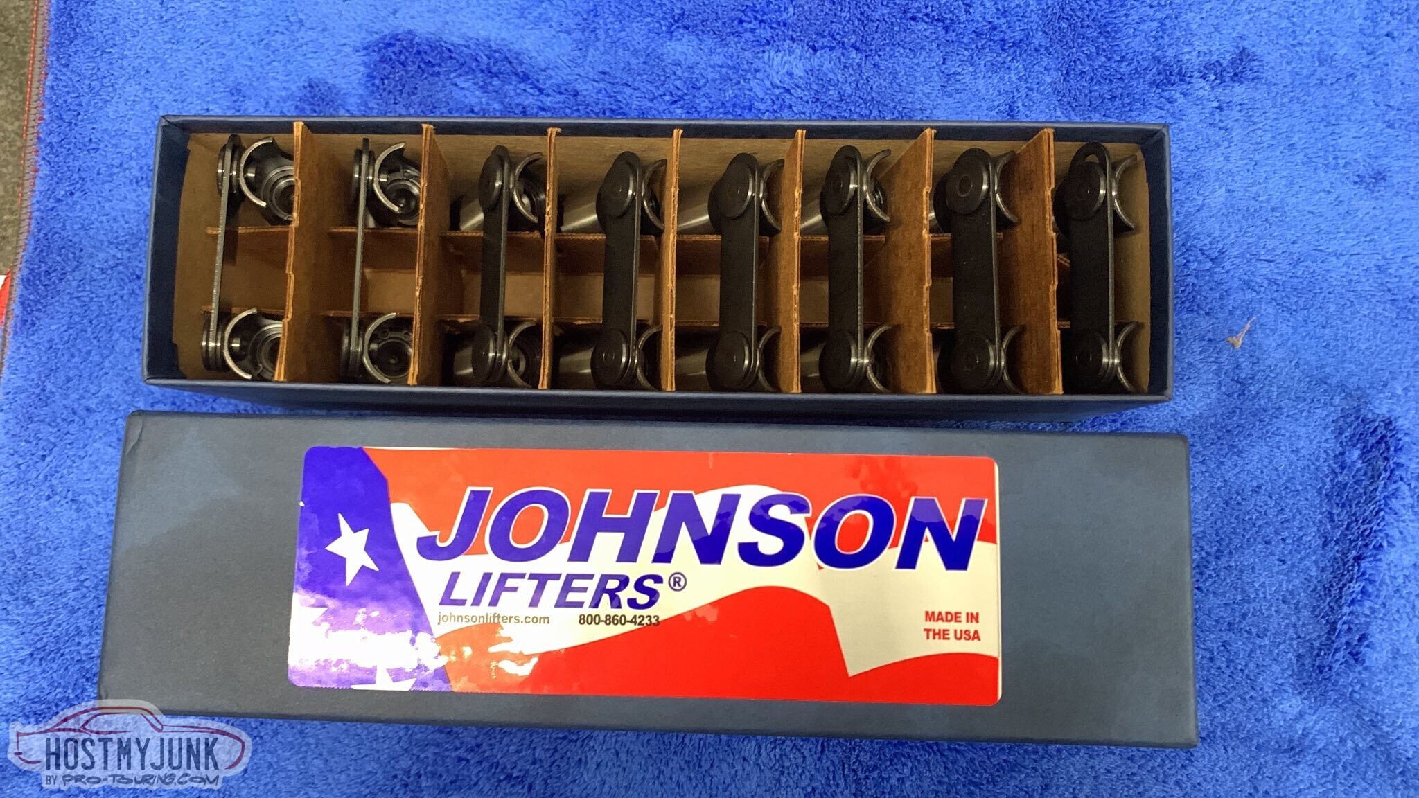

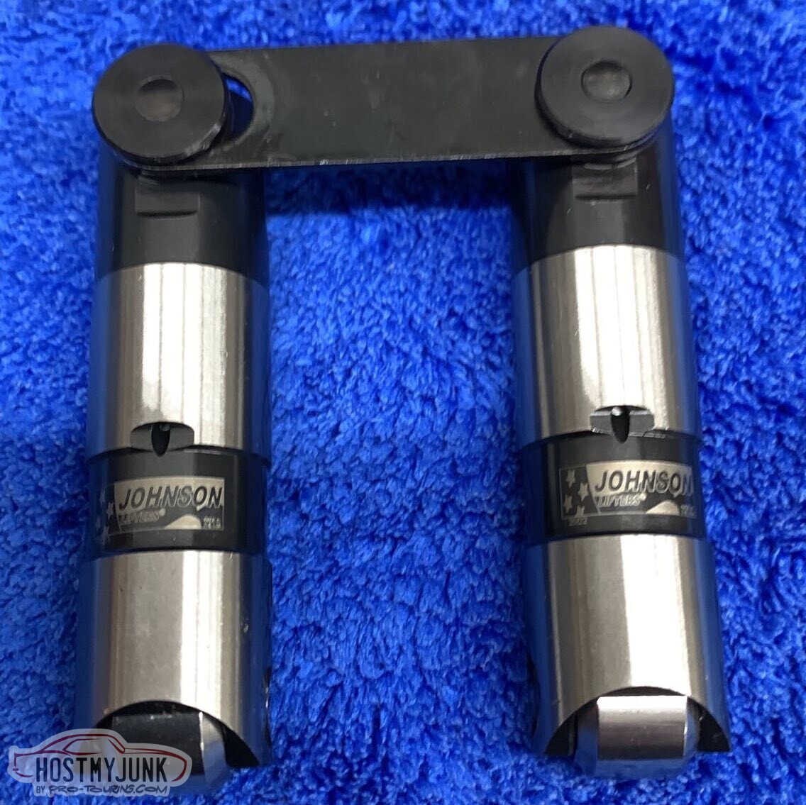

Don't hate me...I guess Ford engineers decided to use readily available parts for the Godzilla engines. The lifters are exactly the same as LS lifters, so I decided to upgrade them to a high quality part.
https://j.hmjimg.com/2024/05/13/CV2-010.jpg
https://j.hmjimg.com/2024/05/13/CV2-007.jpg
https://j.hmjimg.com/2024/05/13/CV2-008.jpg
https://j.hmjimg.com/2024/05/13/CV2-009.jpg
Given that the current LS3 in the Cougar probably had a lifter failure, I did not want to take a chance.

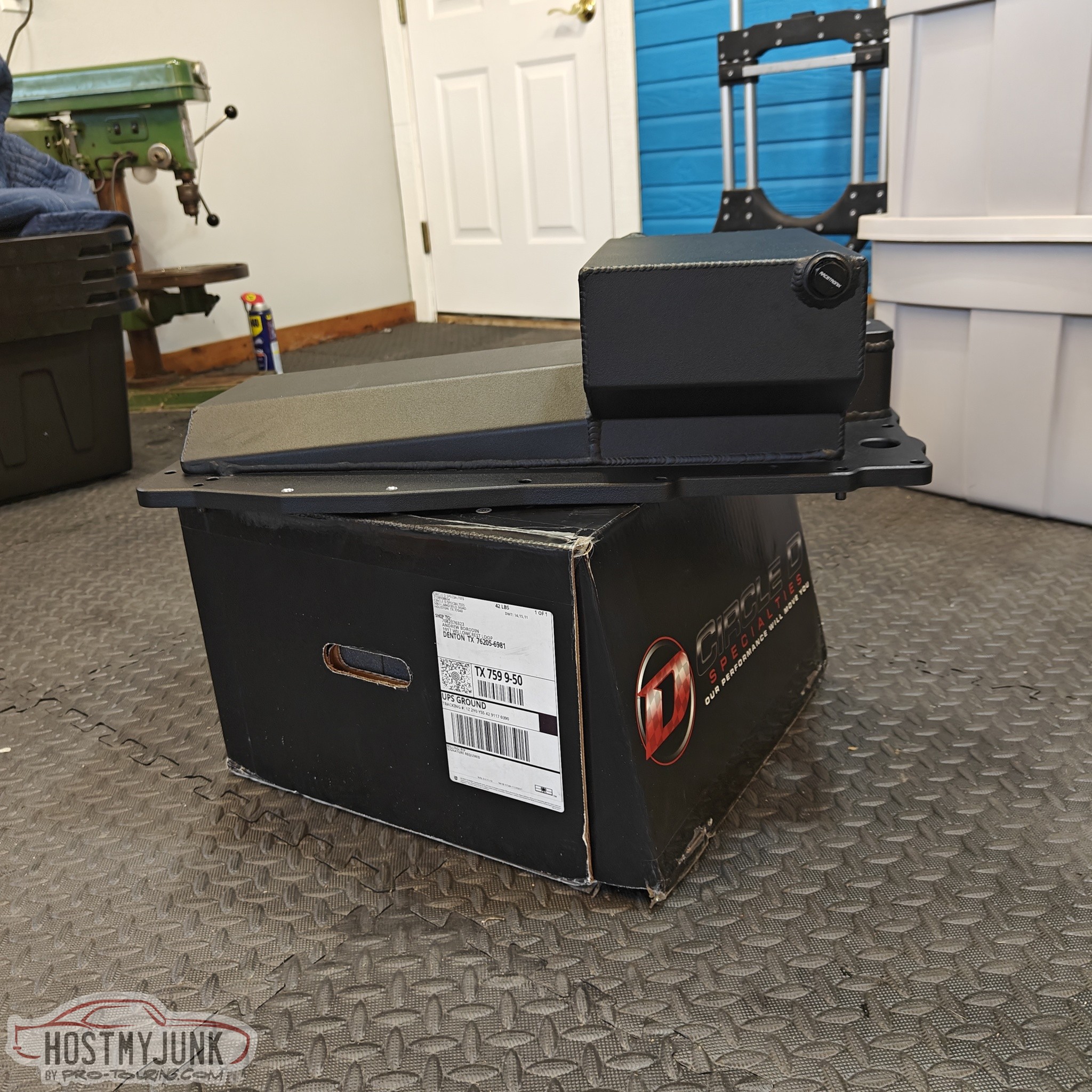

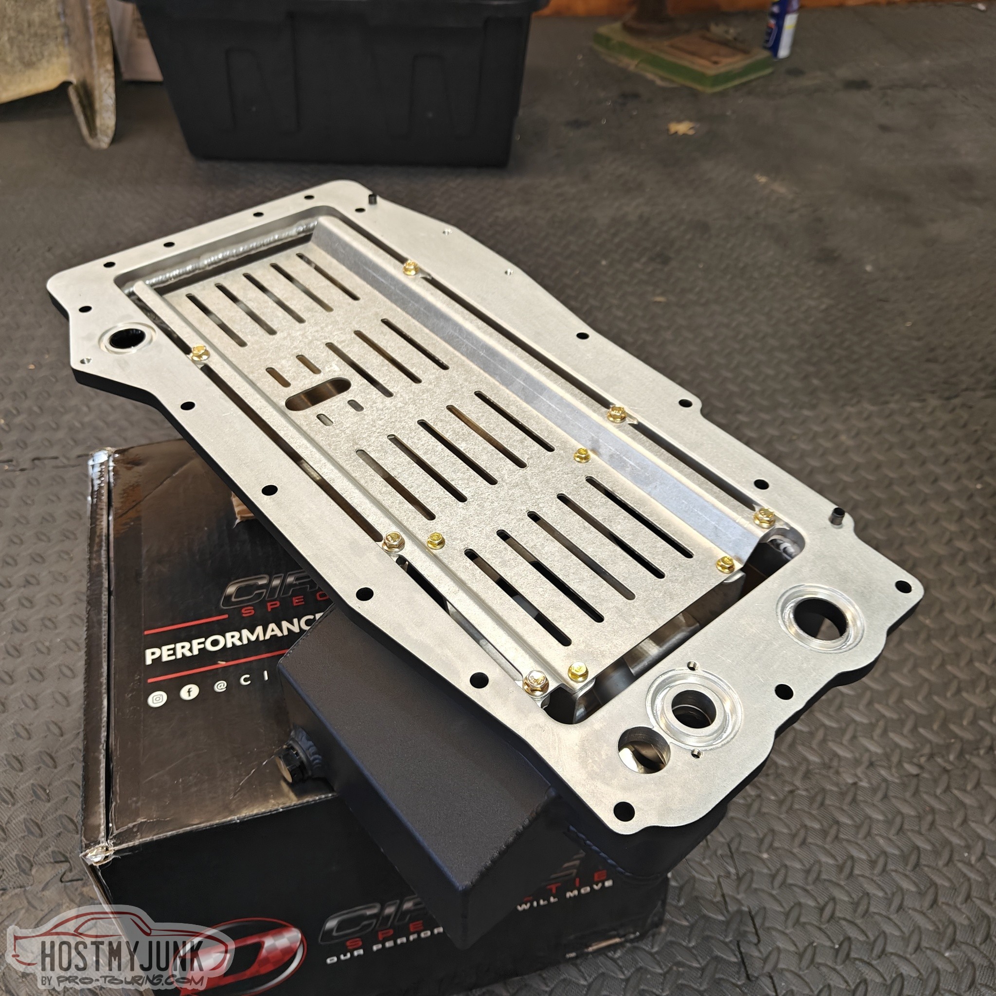

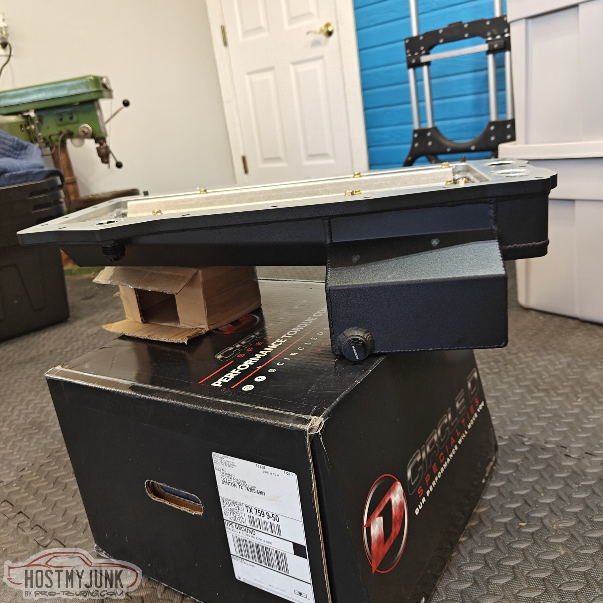

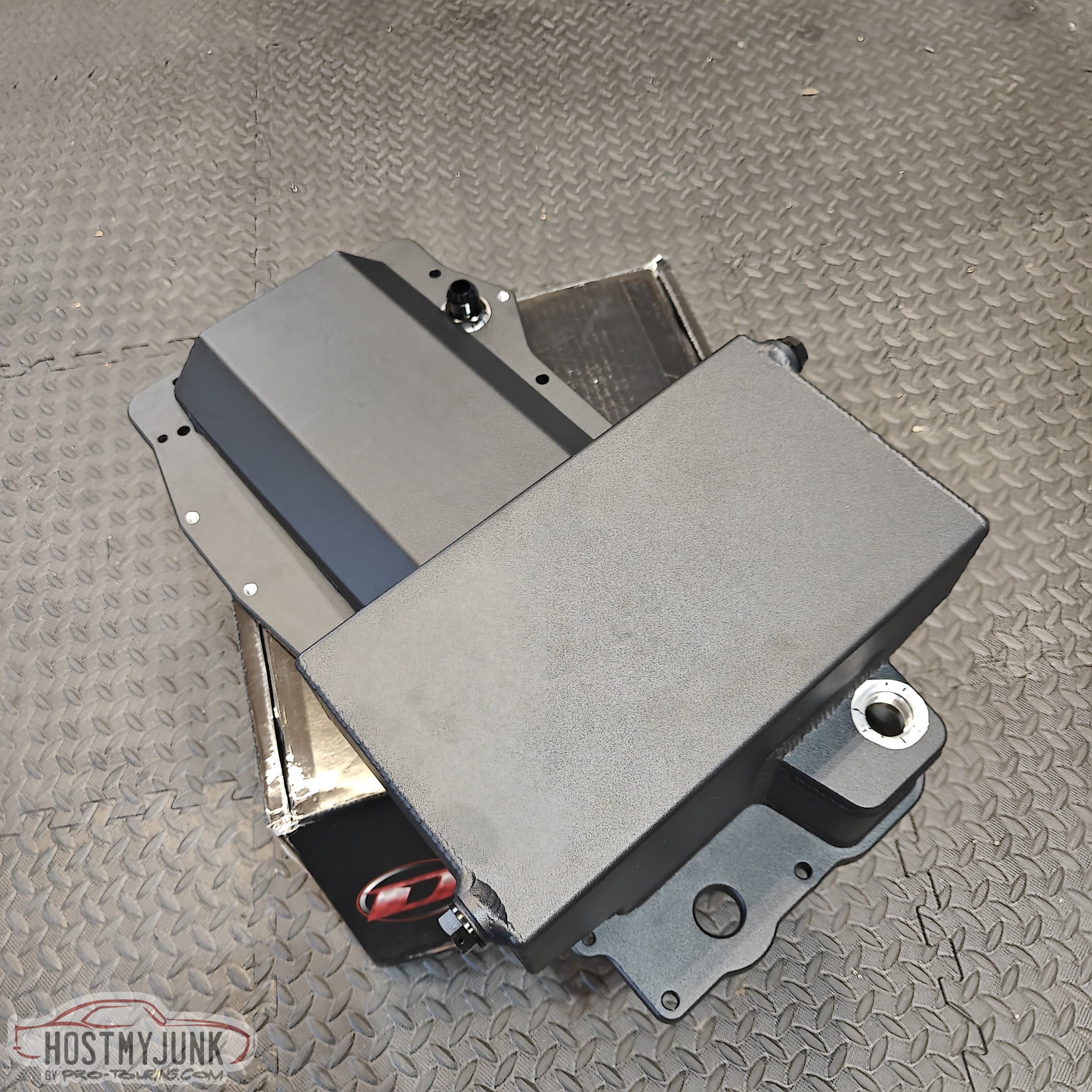

andrewb70 01-03-2025 07:06 PM
There is nothing like a slow moving project, but progress is being made.
Today I received a critical part of the swap, which is a front sump oil pan from Crowbar Customs.
https://www.crowbarcustoms.com/produ...-and-oil-pump/
https://j.hmjimg.com/2025/01/03/CV2-011.jpg
https://j.hmjimg.com/2025/01/03/CV2-012.jpg
https://j.hmjimg.com/2025/01/03/CV2-013.jpg
https://j.hmjimg.com/2025/01/03/CV2-014.jpg
I am pleased with the overall quality and the finish. This pan will require a remote mounted filter and it is designed to be used with the Holley front cover and oil pump arrangement.
Andrew
