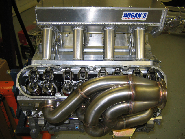

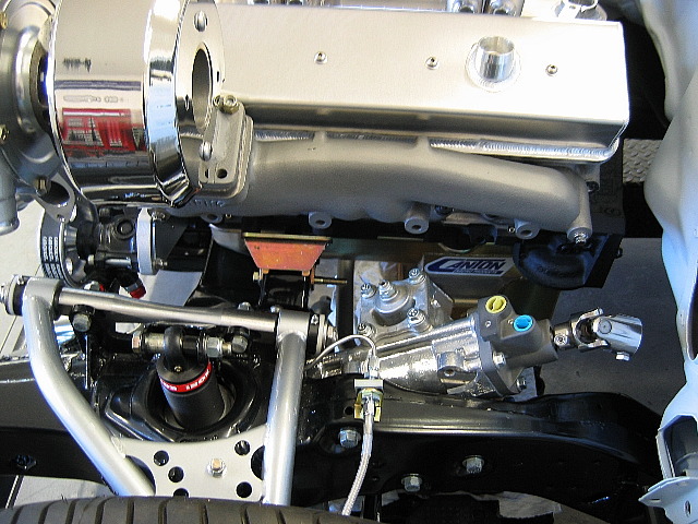

Im just starting the headers on my project. And yes, the streeing shaft is a pain in the a$$! Im trying to make the headers just the opposite of the Nelson ones. The turbos mount facing forward w/ the headers coming up into them. The down pipe will be over them, for what I hope to be a clean look. Right now just waiting for the piping to show up.
My Nelson headers come up into the turbo with the downpipe above the headers and out down the firewall.

TT402LS1 11-20-2006 04:30 PM
Originally Posted by nitrorocket
Like this? What are you making them out of?
No. I didnt want to copy yours, even though its a very nice setup. The inlet(air intake) of my turbos will be facing forward. The exhaust inlet facing down. Headers come from the bottom, and the DP over them.
I was gonna do the pipes in 321 SS, but FI said mild steel is best for the street.(to prevent cracking) Plus, Im going to have everything ceramic coated as well.

camcojb 11-20-2006 05:39 PM
Originally Posted by TT402LS1
Are those cast "log" type manifolds? I want a header type set up, but a "log" type would be much easier.
No, they are 321 stainless headers. This is a pic of the main header, but there's a second piece that mounts the turbos and wastegate, and on mine it sweeps up, turbo inlet facing forward so the downpipe easily goes over the top of the headers and out.
