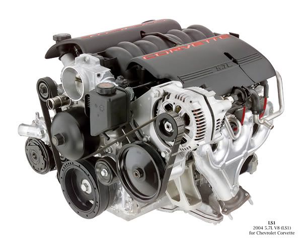

XcYZ 02-21-2007 08:22 AM
I came across this pic, shows the Vette layout nicely:
http://i14.photobucket.com/albums/a3...y/LS1Vette.jpg

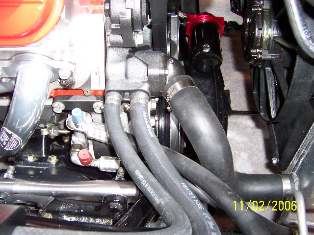

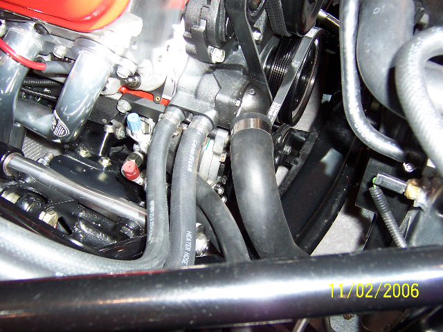

I have and it does not work !!! Way to much to cut out , it will interfear in the motor mount area.
This is why on the Jackson car they made brackets to push the ac out farther and use a ATI balancer with a separate pulley bolted to the front balancer to run the belt .
I have pics of this to confirm. Scott , can you post it ?
camcojb 02-21-2007 08:43 PM
http://www.camcojb.com/sema06098.jpg
http://www.camcojb.com/sema06099.jpg

Assuming everyone is using the ATS, or S&P style mounts the engine sits MUCH farther back than your set up .Also I am assuming we are talking about using a stock subframe here also .
I beleive year one went with this set up in the begining and then later switched to the S&P style for much better front engine room and weight distribution.
In the DSE pic , That is obviously the NEW subframe and would have a much different center section to alow more accomodation for various AC pumps, SD7 or the Big Sanden one.
In the BRP pic that has a very small notch for the AC , but then again with the engine sitting that much farther forward it wouldnt have any issues.
I can assure you that a ATS , S&P style mount on a LS engine with a factory or SD7 ac pump will not work . The section to be cut out goes way back into the motor mount stands , ( bolts closet to the front of the car )
We felt there was to much to be cut out and lose some rigidity in the factory frame to complete this safely.
