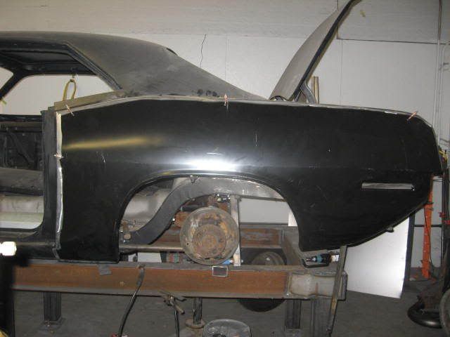

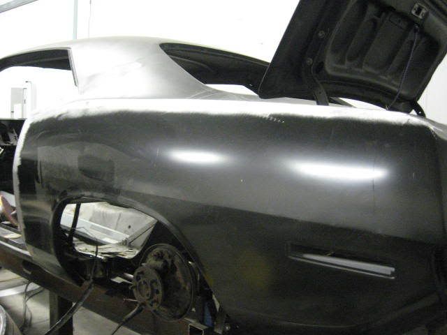

DRJDVM's '69 03-16-2008 09:33 AM
Time for more updates!!

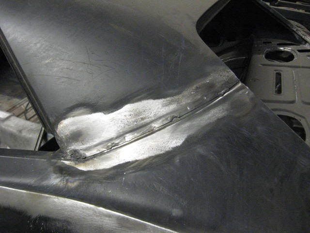

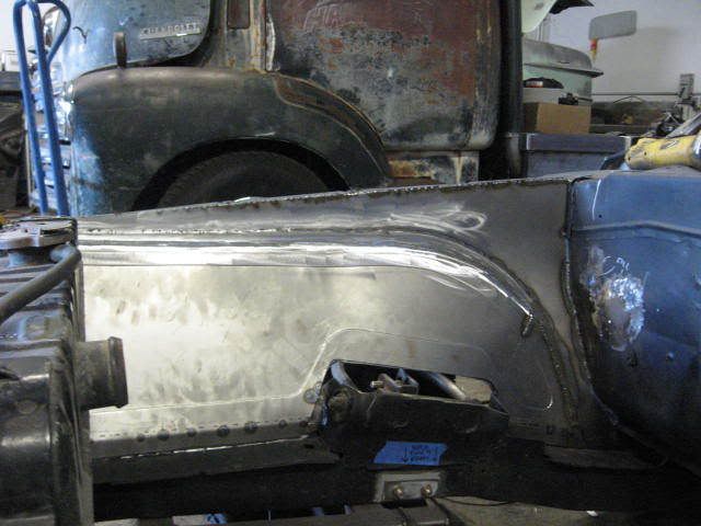

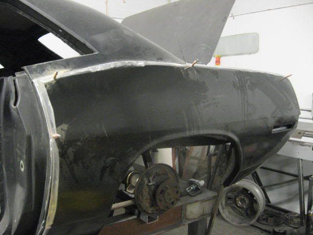

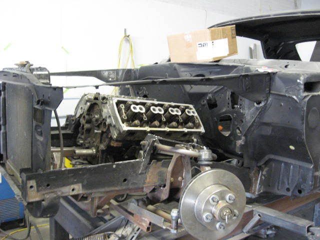

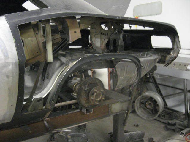

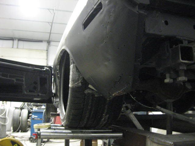

The new quartes are installed now...I elected to do a quarter skin rather than the full quarter to preserve as much of the original sheetmetal as possible. I just dont think the repop stuff has the rigth fit and crispness to the body lines etc. Chris spliced it all in using TIG and hammer/dolley, so the line should be seamless and not "ghost in" over time.
http://i229.photobucket.com/albums/e...5/IMG_0511.jpg
http://i229.photobucket.com/albums/e...5/IMG_0515.jpg
http://i229.photobucket.com/albums/e...5/IMG_0520.jpg
http://i229.photobucket.com/albums/e...5/IMG_0525.jpg

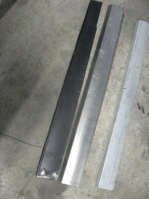

More updates

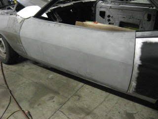

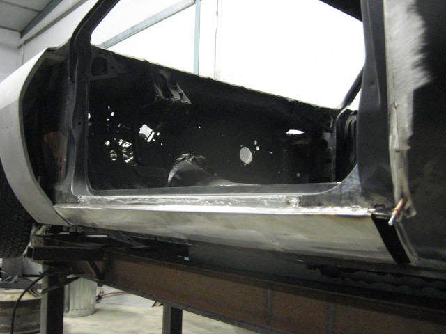

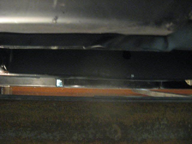

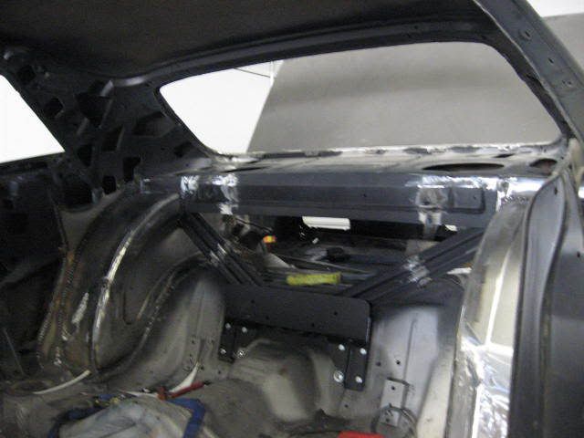

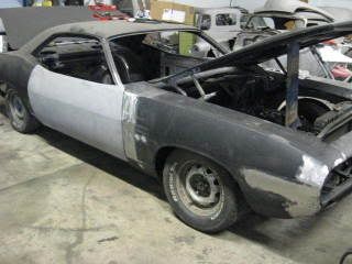

New rocker panels. I bought a repop (goodmark doesnt make them, its some other brand) and after Chris installed it, he didnt like the fit and body lines, so he took it off and made one himself to make sure everything fit perfect and had nice lines and seams.
http://i229.photobucket.com/albums/e...5/IMG_0557.jpg
http://i229.photobucket.com/albums/e...5/IMG_0594.jpg

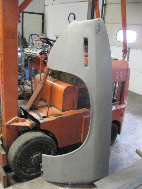

Chris was also able to find another fender in much better shape than what I had for a reasonable price. Should save alot of time and labor as compared to fixing what we had already.
http://i229.photobucket.com/albums/e...5/IMG_0561.jpg
XV Motorsport SFC's getting ready to fit and tack in...Chris is gonna fit them and just tack them in for me while the car is on the chassis table. That way we can be sure its square and level. I'll finnish them up once I get it back and put it on the rotisserie. Should make welding the seams alot easier.
http://i229.photobucket.com/albums/e...5/IMG_0593.jpg

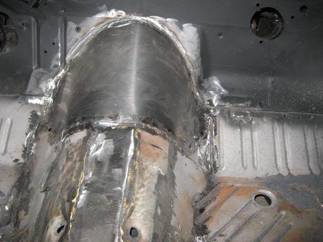

DRJDVM's '69 03-24-2008 02:51 PM
More updates....

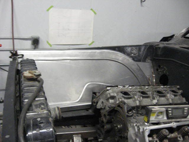

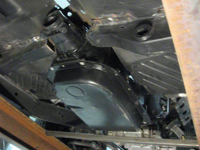

The tubs are 99% done...
http://i229.photobucket.com/albums/e...5/IMG_0608.jpg
http://i229.photobucket.com/albums/e...5/IMG_0609.jpg

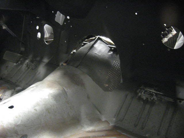

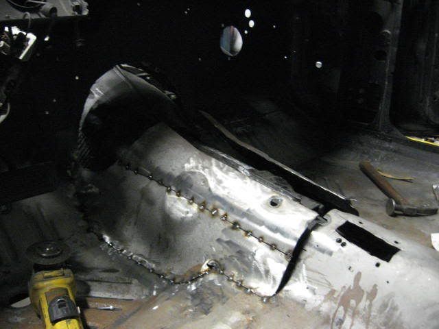

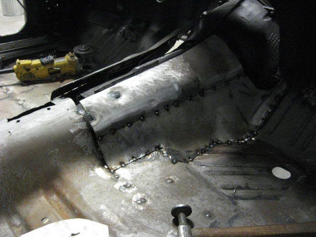

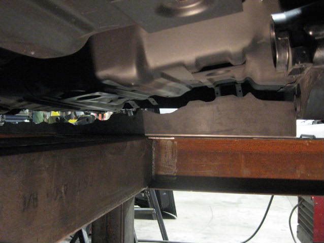

The tunnel mods for the 4L85e...
http://i229.photobucket.com/albums/e...5/IMG_0611.jpg
http://i229.photobucket.com/albums/e...5/IMG_0610.jpg

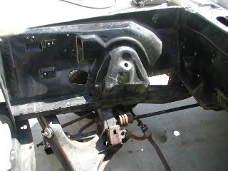

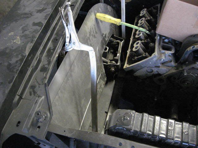

The old inner fenderwells cut out.... Chris did some mock up ones but I wasnt crazy about the design, so he's still working on them. We're trying to open up some space and clean things up without losing some of the look and "feel" to the stock ones..
http://i229.photobucket.com/albums/e...5/IMG_0606.jpg

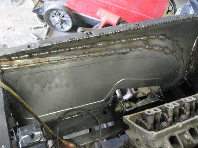

Nothing major to show via pix. Chris has made quite a bit of progress, but nothing exciting to show via pix.
We're still working on the design for the inner fenderwells. Goal is to clean things up, open some room but retain some of the factory look. Heres some of the design so far. We tried a big flat design with no bead roll and it looked wierd. What do you guys think of the beadroll design??
The first one... I though the upper areas was too big, so we scaled that down..
http://i229.photobucket.com/albums/e...5/IMG_0618.jpg
This is the next version where the top section is smaller and the beadroll isnt as deep. This piece will be rolled over and then a "shelf" will be created similar to the stock look....
http://i229.photobucket.com/albums/e...5/IMG_0687.jpg
http://i229.photobucket.com/albums/e...5/IMG_0685.jpg

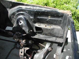

This is stock for reference..
http://i229.photobucket.com/albums/e...5/P1010033.jpg
http://i229.photobucket.com/albums/e...5/P1010032.jpg

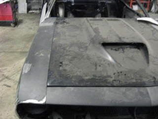

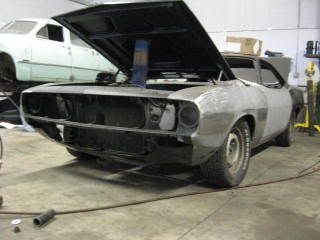

Some more updates. Chris has begun doing the initial fit of the front sheetmetal so he can dial in the gaps etc. All the marker lights and door handles are filled in and he's worked out alot of the dents etc.
So far the fiberglass AAR hood fits "okay" but will need some tweaking....just the nature of fiberglass stuff :)
We should be finalizing the inner fenderwells soon and starting the integrated spoiler and flush mount taillights too.
http://i229.photobucket.com/albums/e...5/IMG_0738.jpg
http://i229.photobucket.com/albums/e...5/IMG_0736.jpg
http://i229.photobucket.com/albums/e...5/IMG_0737.jpg
http://i229.photobucket.com/albums/e...5/IMG_0740.jpg

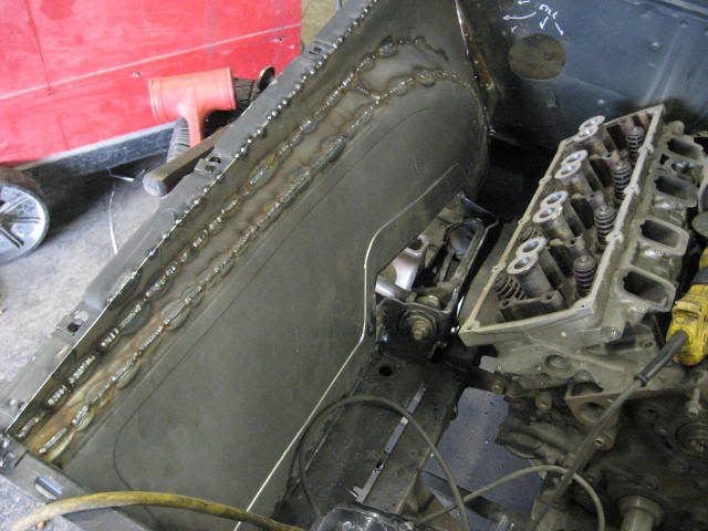

DRJDVM's '69 06-15-2008 03:18 PM
Finally some updates !!

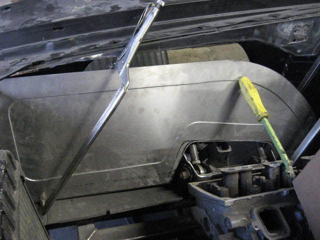

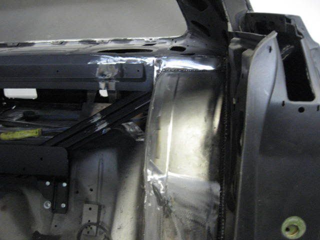

The inner fenders are done....goals was to smooth them out and open some room but keep some of the feel of the original design......lead is out of quarter seams and looks okay under it....no major rot suprises...
http://i229.photobucket.com/albums/e...5/IMG_0766.jpg
http://i229.photobucket.com/albums/e...5/IMG_0762.jpg
http://i229.photobucket.com/albums/e...5/IMG_0763.jpg
http://i229.photobucket.com/albums/e...5/IMG_0757.jpg
Trans tunnel is in and needs finnish grinding etc
http://i229.photobucket.com/albums/e...5/IMG_0754.jpg
