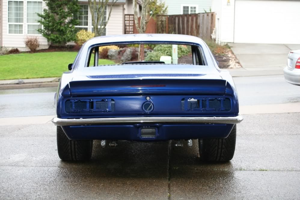

Well it stopped raining for a little while so I rolled it out and hosed off some reamaining polishing compound and spray mask that was on the black surfaces. I must say this is a crazy color to photograph due to all the pearl in it. Looked killer sitting outside...happy days!
Also I want to mention that we used Prodigy's SS fastener kit on the car, it's a very nice and complete kit!
I took more pics yeasterday before I hosed it down and it started raining before I could take more...so these will have to do. http://i235.photobucket.com/albums/e.../IMG_02351.jpg
Ready for assembly!!
http://i235.photobucket.com/albums/e.../IMG_02271.jpg
The deck lid wasn't latched so the spoiler gaps aren't as tight as they really are.
http://i235.photobucket.com/albums/e.../IMG_02421.jpg
Nice work Chris on making everything line up!

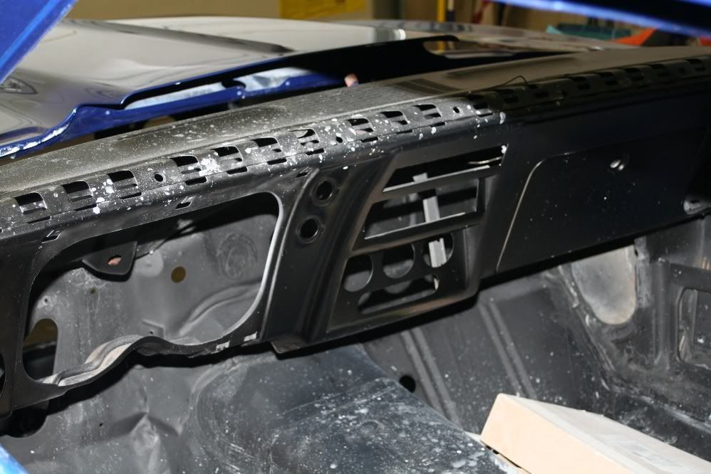

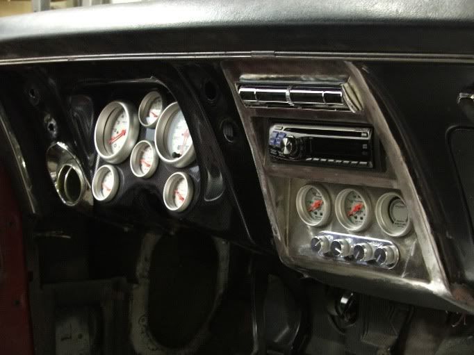

I didn't want to loose the styling of the dash, but had to package more than stock would allow. I cut the whole center out and started over. The unpainted area is all new and hand build...then butt welded in. Notice there isn't an ash tray and I moved the head unit up for an easier reach. It's all painted now of course, but will be a while before I install all the parts for the final time. Here's a close up of the work area. I'm sure a pro could have gotten more creative, but I'm happy with it!! :)
http://i235.photobucket.com/albums/e.../DSCF15401.jpg
I'm thinking the blue on the harnesses will match the body color well! Got to coordinate!!

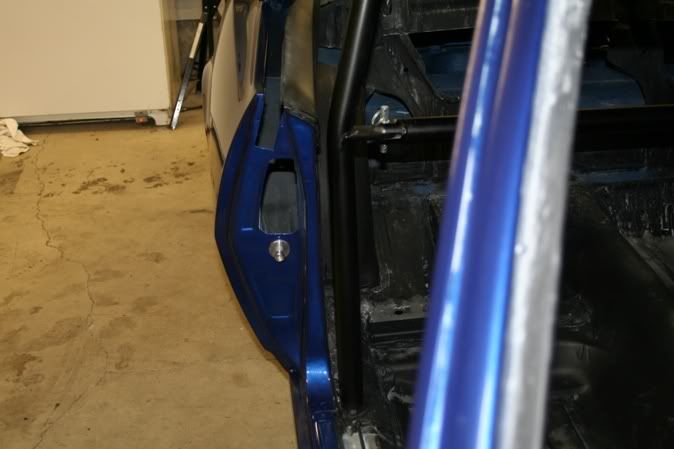

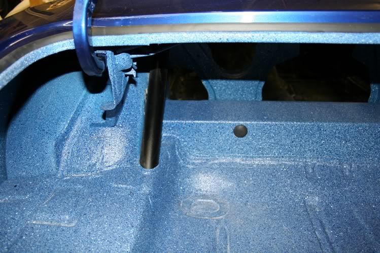

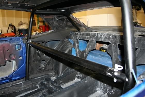

Ok, figured it was just easier to take new pics of the AME roll bar. I opted for the bent down bars and I used a Chris Alston swing-out kit on the harness bar. I actually ordered an 8 point roll bar but decided against using the door bars and tubes that install at the rear passenger's feet...this is a family car after all...got to keep it comfy and usable...yeah right! :_paranoid
http://i235.photobucket.com/albums/e.../IMG_02641.jpg
http://i235.photobucket.com/albums/e.../IMG_02611.jpg
http://i235.photobucket.com/albums/e.../IMG_02621.jpg

Thanks! The main hoop is tilted a little and inline with what would be the 'B' piller and is very hard to see (froma side view) when the quarter window is up...owe that idea to Stielow! And I wanted full use of the trunk so I installed the down bars as far forward as possible.
