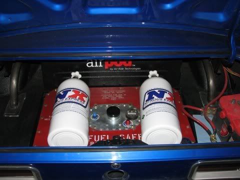

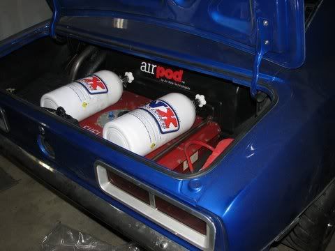

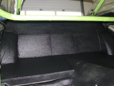

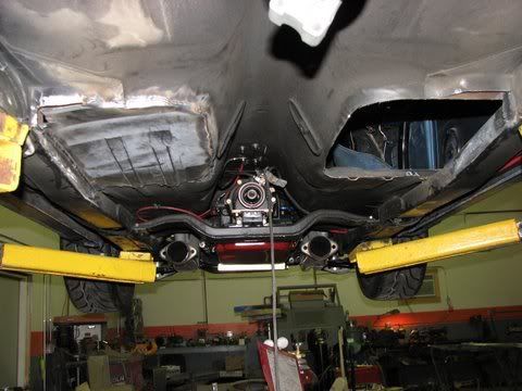

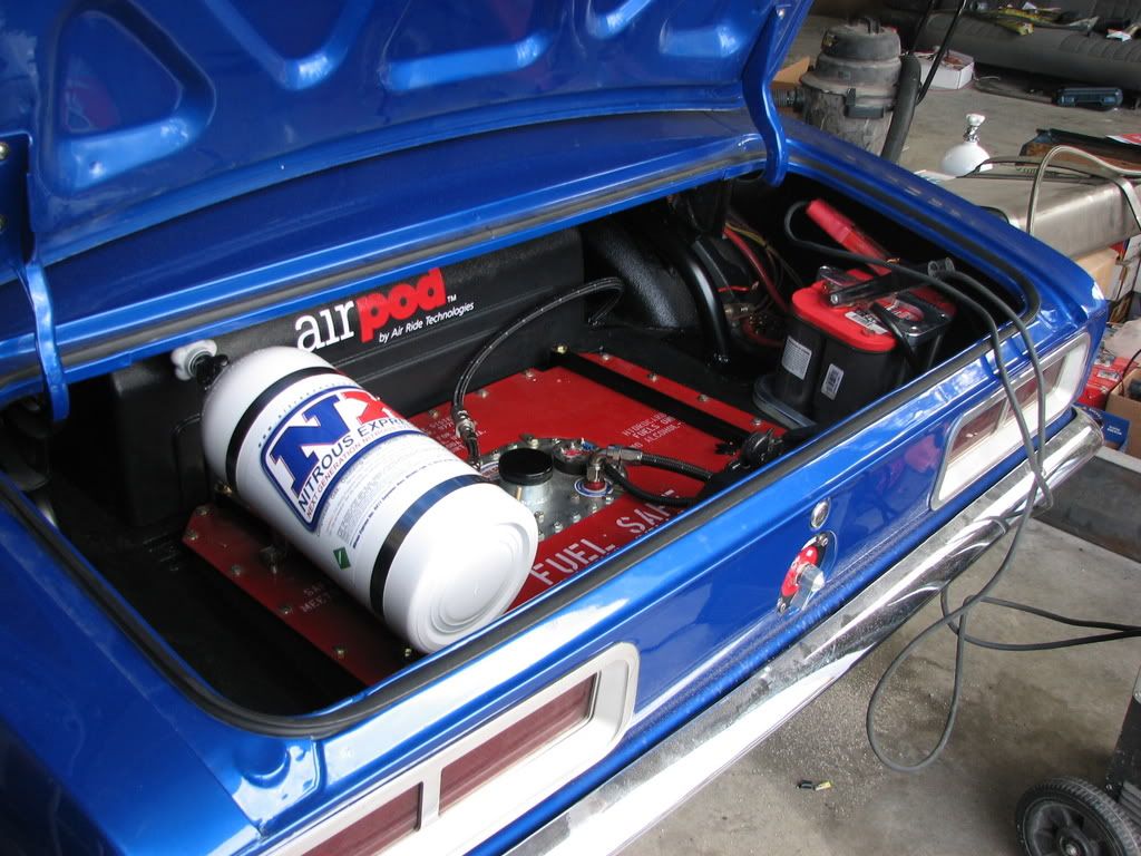

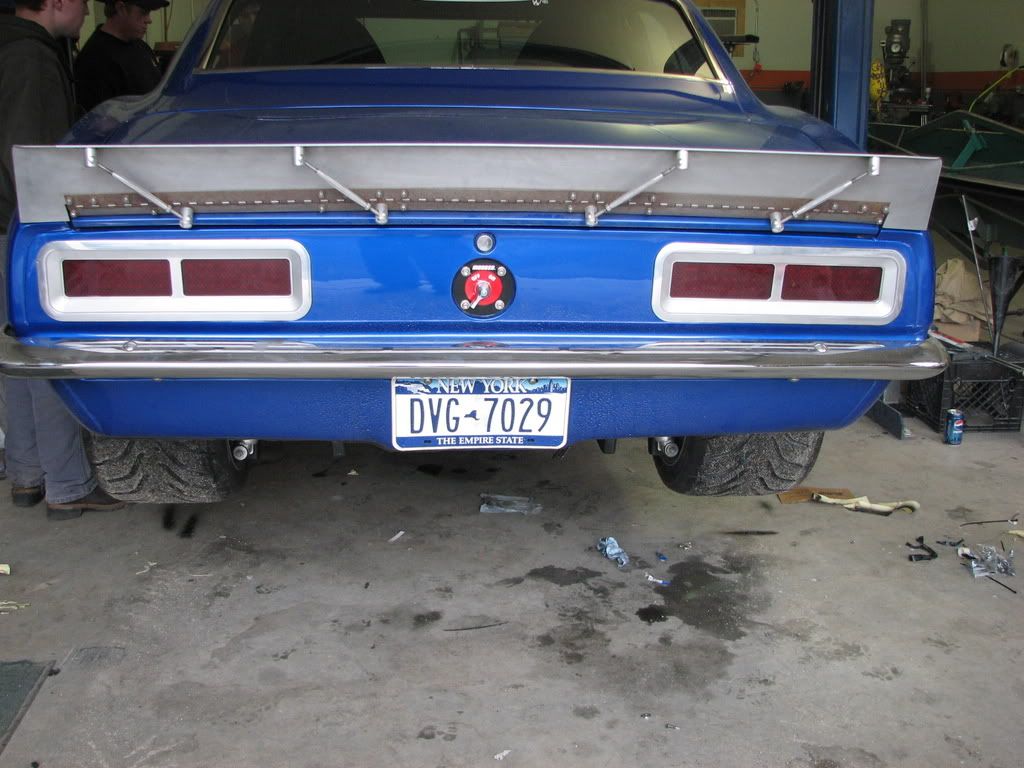

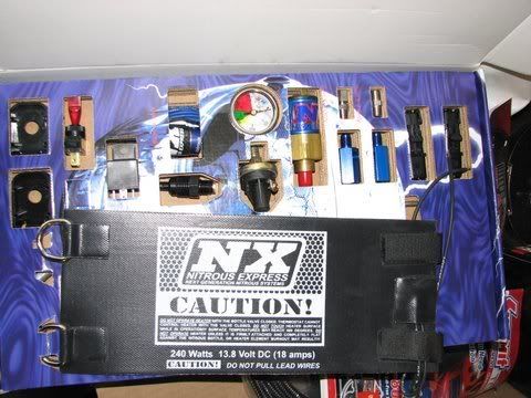

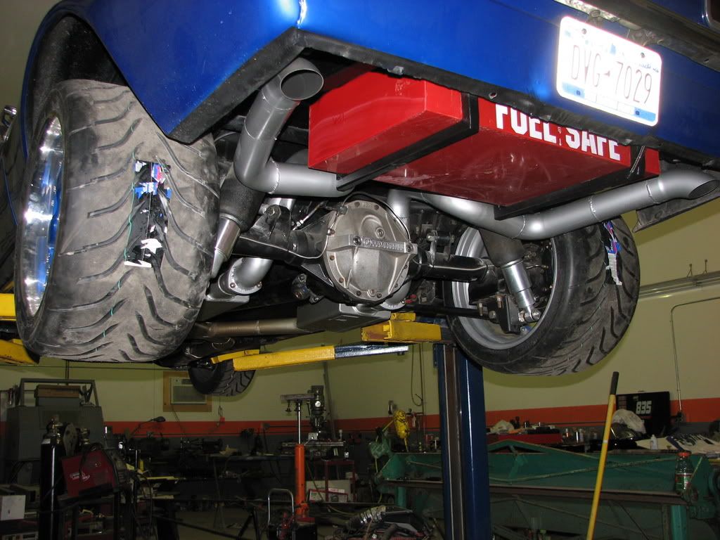

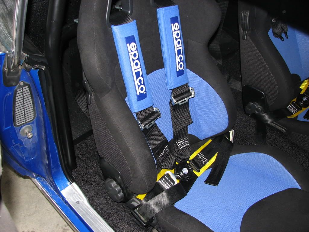

another update we are on the home stretch, got the nitrous from NX, and it is awesome stuff, will provide detail pics later but brian havins there really set us up with the right stuff the first time.Got the rear passenger floor pans raised and new panels made, got rear firewall sealed and coated, and interior is all in and doing final nitrous install, vinny will be drag racing next monday, he also got slicks and skinnys for it, should run a very low 10 on a 100 shot.
it ran a 7.63 100 8th with 265 18 inch rear tires peddling it the whole way. should be good for high 10;s on motor.
http://i239.photobucket.com/albums/f...p/IMG_0877.jpg
http://i239.photobucket.com/albums/f...p/IMG_0910.jpg
http://i239.photobucket.com/albums/f...p/IMG_0878.jpg
http://i239.photobucket.com/albums/f...p/IMG_0858.jpg
http://i239.photobucket.com/albums/f...p/IMG_0920.jpg
the door in the firewall is access to the air pod connections.

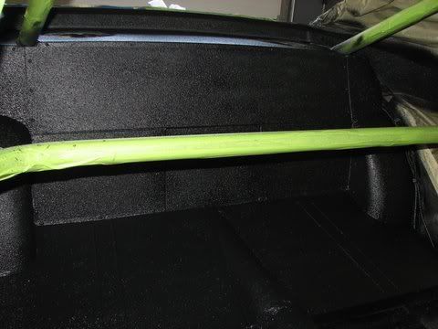

http://i239.photobucket.com/albums/f...p/IMG_0946.jpg
crappy pic showing difference from carpet to raptor liner rear firewall texture
will have better pics

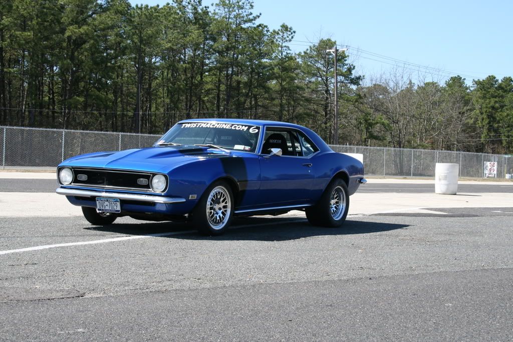

thanks pete, heres a few shots from atco
10.60 @ 131 n/a next time out we throw 150 and 200 hp at it along with turning it to 7200 rpm not 6800.
