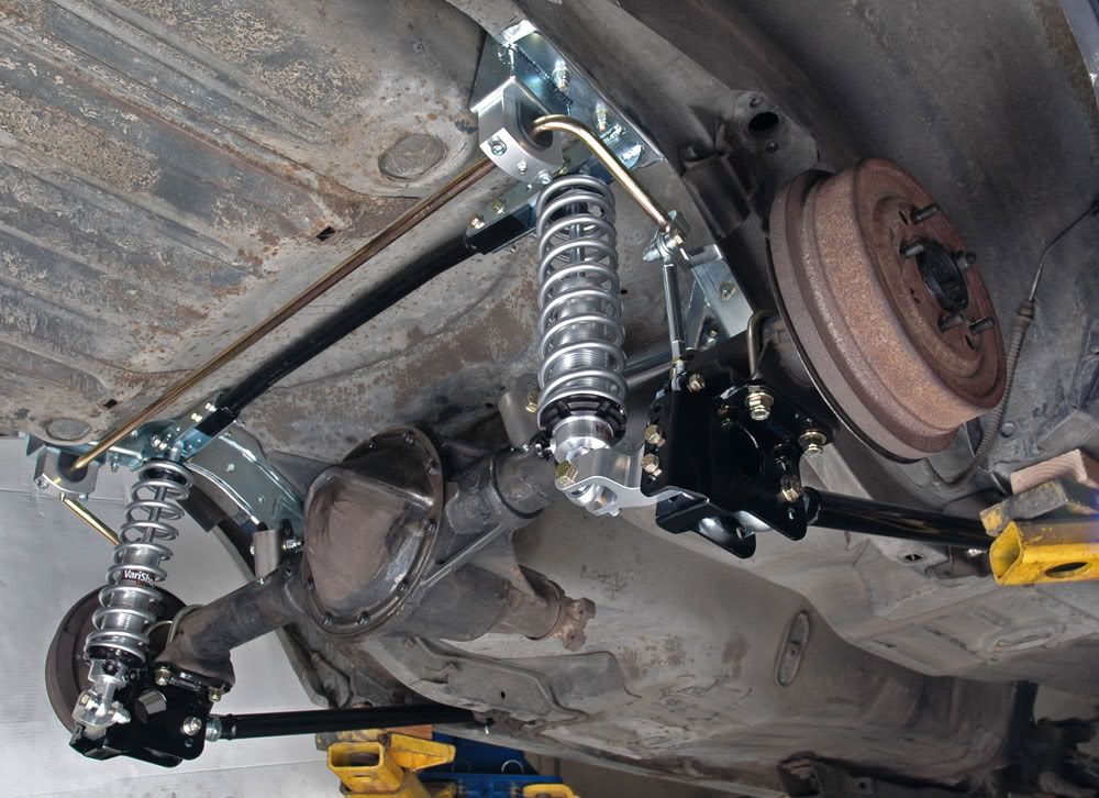

Marcus SC&C 11-28-2008 09:59 AM
I finally have soem installed pics of the new Chassisworks G-Link for you guys to take a gander at. They`re not great pics and these are pre production parts so the final welding and surface finishe aren`t done but it gives you a good idea of where they`ve made changes and improvements. Check out how roomy it is now, exhaust should be a piece of cake. TrueCenter greasable delrin pivots at all 8 points. Note all the adj. holes to tune anti squat, IC location and roll steer. The LCA mounts even incorperate integral trailer tie down loops. I think that`s a really neat touch. They saved additional weight by eliminating a lot of the old tubular upper structure. The new upper mounting structure directly reinforces the unibody rails.The adj. rate swaybar is frame mounted,making it sprung weight and it`s geometry allows it to generate high rates with a small OD and less mass. It`s all very clean engineering and extremely lightweight. Note that there is still NO cutting involved at all. We`ll have better pics in a week or so. The G-Link will also be shipping by then so the pre-order pricing will be over. There`s still a little time to save a few hundred bucks. Mark SC&C
http://i158.photobucket.com/albums/t...o_g-Bar_01.jpg
http://i158.photobucket.com/albums/t...o_g-Bar_03.jpg
FreddieCougar 11-28-2008 01:25 PM
Actually, that is a production Chassisworks piece...those are the production finishes.
Tim
ProdigyCustoms 11-28-2008 06:33 PM
Also there are weld on lower brackets option available for a cleaner / non adapted look.
We have a few one order and will be putting one in my personal car in the next couple weeks. Cannot wait.

Marcus SC&C 11-29-2008 10:35 AM
Thanks Tim, straight from the horses mouth. Poor wording on my part, I meant to say that the welding and surface finishes of the install (including the car ie. rusty parts) weren`t done yet. ;)
The weld on brackets are a great option for a cleaner look. They`re almost elegant.
You can also get the swaybar mounts (either style) for $50 without the bar if you want to leave your options open but don`t want to cough up the extra for the whole bar now. Personally I love that adj. rate bar! The axle mounted bar with its billet arms is really pretty and functional too but tuning options make me all warm and fuzzy. :yes:

Marcus SC&C 12-13-2008 11:22 AM
Just a quick update on the G-Link. They`re shipping which is very cool! We also just became aware of a clearance issue when using the bolt on G-Link LCA brackets in mini tubbed applications. Some big mini tubb only wheel dia. and backspace combinations may not clear the lower coil over mounting bracket. The arms and brackets are much more beefy and they added additional adjustment holes so the brackets are a bit larger than the original G-Bar. If you want to run minitubbs just select the weld on lower arm mounts. They can be installed further inboard for clearance and Chassisworks is already working on instructions and an offset bushing kit for the front of the lower arms to preserve the correct geometry. The upper coilover mounts have plenty of holes for adjustment so no changes will be required there at all. CW will be doing at least one narrowed rear swaybar for minitubb applications and the adj. rate Hellwig rear bars should work as well. Thanks to Frank at Prodigy who`s helping Chassisworks with the fittment details on his mini tubbed cars. Mark SC&C
