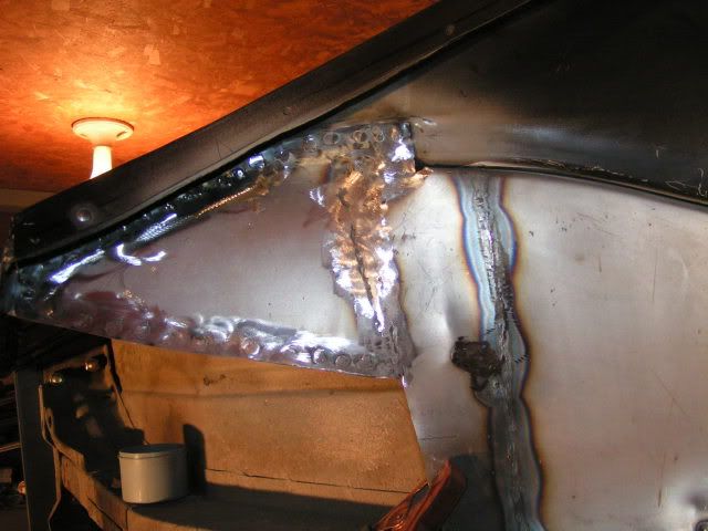

Made some progress on the car today. The driver's side outer wheel house and deep tub are in.
http://i222.photobucket.com/albums/d...9/PICT0063.jpg http://i222.photobucket.com/albums/d.../PICT00612.jpg It was easier just to cut the old bracket out so I just made new brackets where the wheel house supports the rear deck lid. http://i222.photobucket.com/albums/d...9/PICT0065.jpg http://i222.photobucket.com/albums/d...9/PICT0067.jpg I'm hoping to spend a couple hours in the shop tomorrow when my wife and daughter go to Kelowna, although I told her I would do some yard work also so we'll see. I should have the driver's side quarter panel on by the next update. Once the quarter panel is on, I will be replacing the driver's side cowel panel. I already have the old one off. It looked like someone had been in an accident as the old one was crushed in. I tried to straighten it the best I could. http://i222.photobucket.com/albums/d...9/PICT0004.jpg Once I get the cowel panel done, I will probably cut out the firewall and put a smooth one in. Right now I'm leaning towards the Mike's Custom Cars inserts. I was going to make them myself, but after looking at several different pics, I think I do like it with the factory seam reproduced. I find it beind completely smooth almost too much and the seam adds just enough. I'm going to replace the driver's side also and then hide the wiper motor under the driver's side fender. Here's a link to the firewall panels I'm looking at. $145 for both. http://www.mikescustomcars.com/proje...album=1&pic=10 http://www.mikescustomcars.com/proje...&album=1&pic=6 |

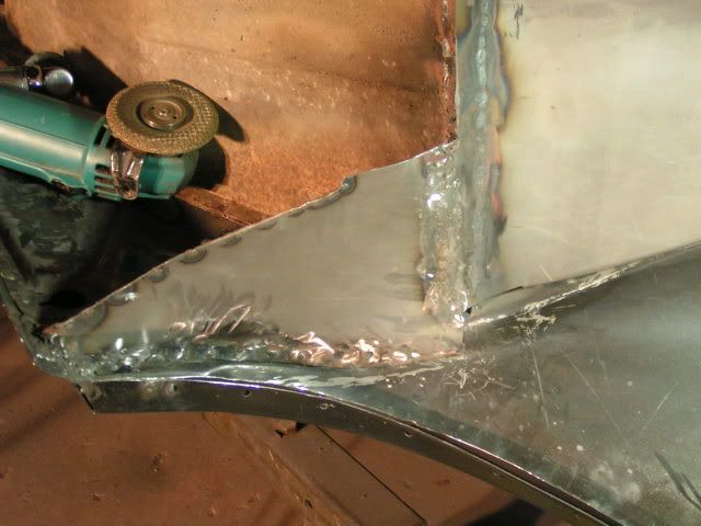

She took the daughter to Kelowna for a girls trip so that left me some time in the shop. I got the driver's side quarter on and am about half way done welding it on. The next chance I'll get to finish it will be next Monday. Here's a pic: http://i222.photobucket.com/albums/d...9/PICT0072.jpg I also put both rear tires on to see how it looks. It looks awesome with the 285's, but I can't wait to get the rims widened and get some 315's, it will look sick :devil: Here's the 285's: http://i222.photobucket.com/albums/d...9/PICT0074.jpg http://i222.photobucket.com/albums/d...9/PICT0075.jpg http://i222.photobucket.com/albums/d...9/PICT0081.jpg |
Nice job. You are doing some serious metal work :thumbsup:

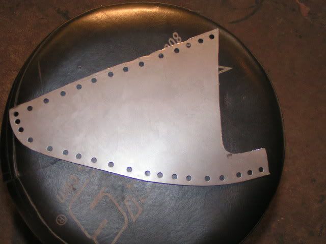

Here's a couple more pics from today. I'm going to weld in some plug welds to add some strength to the smooth firewall. I'm using 16 guage sheetmetal so I'm not as worried about it warping. I was also able to smooth out the infamous area where most cars with an HEI distrubutor get the hammer treatment. It's not perfect, but it's better. I'll probably spend a bit more time cleaning it up before I weld everything into place. Here's the pics:
Smooth firewall with plug weld holes and held in place with cleckos http://i222.photobucket.com/albums/d.../PICT00165.jpg Smoothing out the hammer beating, will be easier to clean up with filler now http://i222.photobucket.com/albums/d.../PICT00185.jpg The next area to be smoothed http://i222.photobucket.com/albums/d.../PICT00176.jpg |

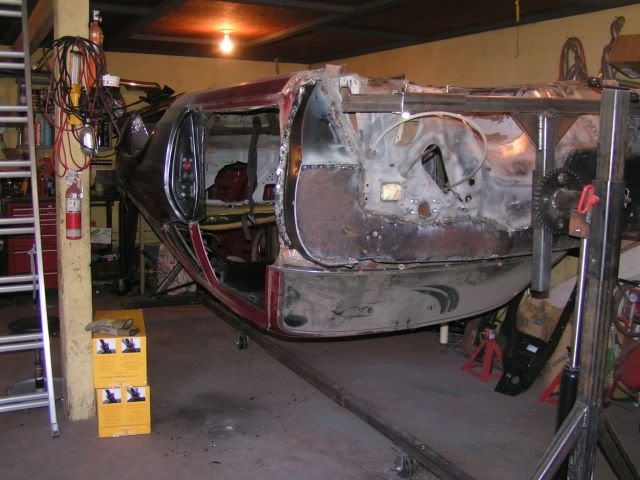

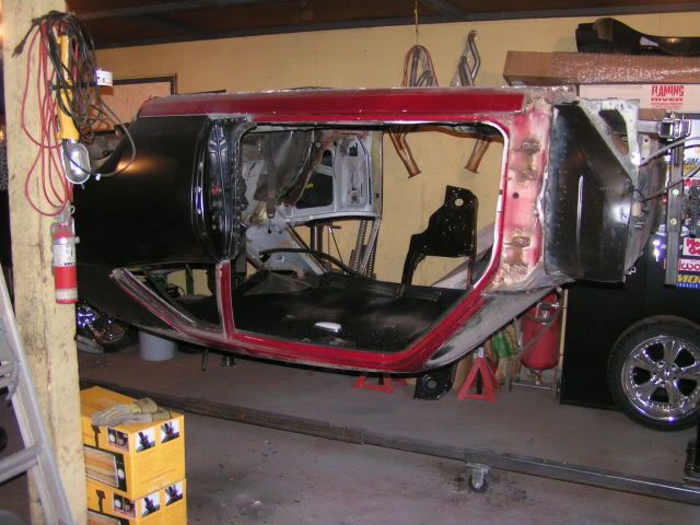

I did get some work done on the car (sort of). The way things were going I thought I'd never see the day when I would get it on the rotisserie, but here it is. I hope to get everything welded up tomorrow and hope to get a coat of POR15 on by Friday. Here's some pics: http://i222.photobucket.com/albums/d.../PICT00106.jpg http://i222.photobucket.com/albums/d.../PICT00115.jpg http://i222.photobucket.com/albums/d.../PICT00125.jpg http://i222.photobucket.com/albums/d.../PICT00137.jpg http://i222.photobucket.com/albums/d.../PICT00146.jpg |
Nice work! Talk about memories!! I was right there just over a year ago!!

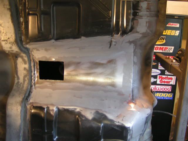

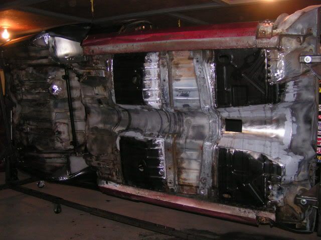

I spent about 8 hours in the shop today. I was hoping to have it ready for under coating by tomorrow, but when I realized that's not going to happen, I figured I might as well call it a day. Only so much grinding and welding one can do in a day. I'm not trying to get a 10 point car or anything, I'm just trying to clean things up. I ended up getting the welding on the floor boards and tranny tunnel finished. The air bar is welded in place now also. I did come across one issue. Both the driver's side and passenger side front eye mount brackets were welded to the body (some of you may have seen my thread about this) so I had to grind them off. Once I had them off though, the metal underneath wasn't that bad. I was debating about cutting a new piece and welding it in, but after cleaning up the metal some, I think I'm just going to fill the little holes in with the welder. Here's some pics: Driver's side http://i222.photobucket.com/albums/d.../PICT00242.jpg http://i222.photobucket.com/albums/d.../PICT00272.jpg Passenger side http://i222.photobucket.com/albums/d.../PICT00217.jpg http://i222.photobucket.com/albums/d.../PICT00224.jpg |
I also decided to clean up the front where the new floor boards were welded in. I wanted it to look smooth and not see where the metal overlaps. I'm using Metal to Metal to fill it in. It's not done yet though.
Driver's side http://i222.photobucket.com/albums/d.../PICT00343.jpg Passenger side http://i222.photobucket.com/albums/d.../PICT00353.jpg The next picture, hopefully someone can help me. I'm going to have to fab up something to fill in this gap. If you've followed my build thread, you'll know that I replaced the quarter panels, trunk drop offs, outer wheels houses and put in deep tubs. I just noticed today that I have a big gap on both sides between the quarter panel and the trunk drop off. It's right below the deep tub. Is this common to have this gap when you replace everything??? Here's some pics: This is with the car sideways on the rotisserie. It's the passenger side. http://i222.photobucket.com/albums/d.../PICT00443.jpg |

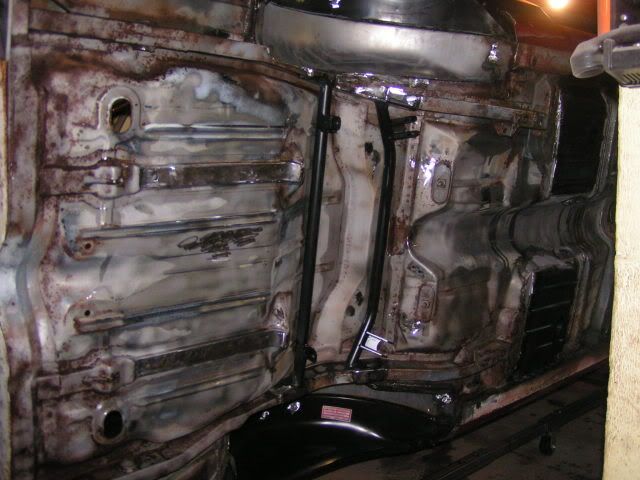

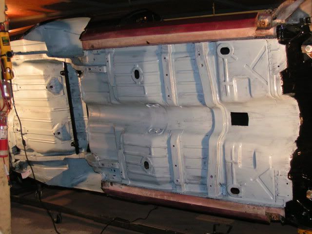

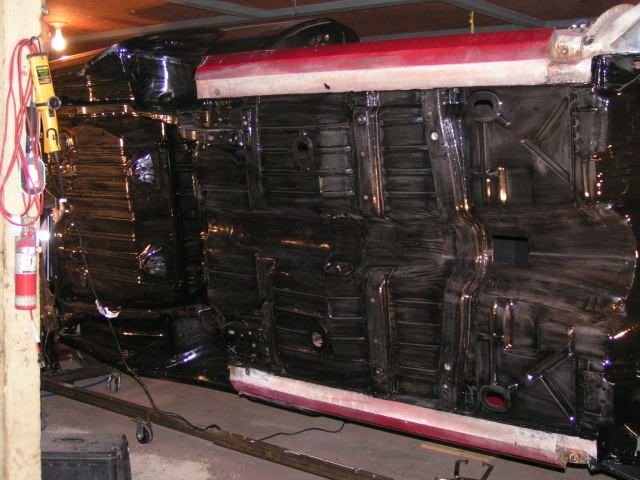

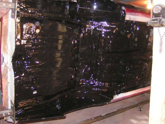

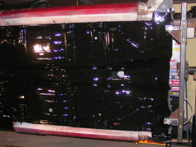

I was playing around the other day and thought I'd take some pics of the car upside down. I hope to never see the car like this again :D
http://i222.photobucket.com/albums/d...9/PICT0086.jpg http://i222.photobucket.com/albums/d...9/PICT0085.jpg http://i222.photobucket.com/albums/d...9/PICT0087.jpg |

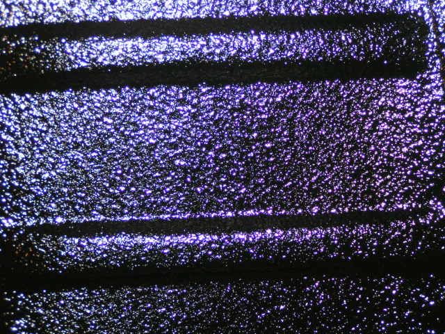

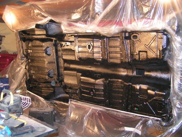

It feels like it took me forever to get to this point, but I actually started undercoating the car. I decided to go with two coats of POR15 first to stop any rust. I was going to use POR15's new bed liner until I saw the price. It's $255 US or if I get it in Canada it will cost me $350. I was hoping to use it to save a step, but I think I'll have to do that step anyways. With the POR product on top of POR15, you don't have to use a primer. Now I'll likely end up having to use their primer, then put another brand of bed liner to finish the undercoating. For those that wonder why I chose to use POR15, I wanted to use something that will stop any rust from coming back. The other nice thing is since I replaced the floor pans, POR15 helps hide my ugly welds as it's quite thick.
My next step is to get the bed liner done. Once that's done, I found a powder coating place in Kelowna that will do my subframe for $175. They will sandblast, prime and then powder coat. He'll do the rear end housing for about $75. I'm just waiting for a rear sway bar to be shipped to me and once I get that I can drill the holes in the back brace and get the brackets mounted, then off to powder coating. Enough of that and onto the pictures. I had to pull the car out of the shop to rinse of the POR degreaser and oxidizer. http://i222.photobucket.com/albums/d...9/PICT0088.jpg After it was cleaned with degreaser http://i222.photobucket.com/albums/d...9/PICT0091.jpg http://i222.photobucket.com/albums/d...9/PICT0092.jpg Finally some progress!! This is after 2 coats of POR15. The white dots all over are because the lens on my camera was dirty. http://i222.photobucket.com/albums/d...9/PICT0093.jpg http://i222.photobucket.com/albums/d...9/PICT0094.jpg |
Here's the tranny tunnel after using metal to metal to clean it up. Can't even tell there's new floor pans. It's not that grey in color. I tried not using the flash to get better detail and that's how it turned out.

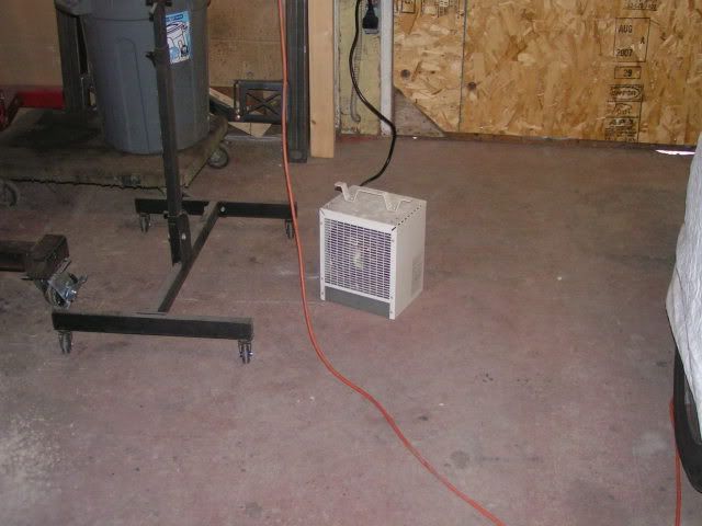

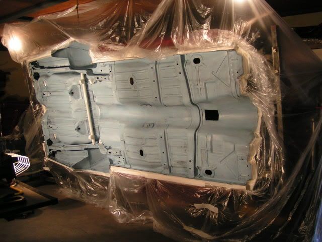

I finally got around to getting the POR15 tie coat primer on today. They recommend it when you are putting a non POR product on top of the POR15. The annoying thing is, the stuff cures with heat and not moisture so I had to get my shop nice and toasty. Those that are in cold climates will appreciate what I'm talking about. I had to get my shop to a minimum 12 degrees celcius. With the help of two 240v construction heaters and two halogen work lights, it got quite warm in there. I even put a cheap thermometer in the shop to make sure. Next week I hope to get the undercoating on. I'm going to use U-Pol's Raptor bed liner. Once that's done, I hope to get the subframe done and mounted to the car so I can actually start putting parts on.
Construction heater #1 http://i222.photobucket.com/albums/d.../PICT00024.jpg Construction heater #2 http://i222.photobucket.com/albums/d.../PICT00049.jpg After a couple hours, it was at 18 degrees celcius, by the time I was done it had gone up to about 24. My wife is going to be so mad when we get the hydro bill :devil: http://i222.photobucket.com/albums/d.../PICT00058.jpg I had to sand the entire underside before applying the primer http://i222.photobucket.com/albums/d.../PICT00016.jpg With the POR tie coat primer on it. The nice thing about the POR products is they can be applied with a brush. http://i222.photobucket.com/albums/d.../PICT00076.jpg |

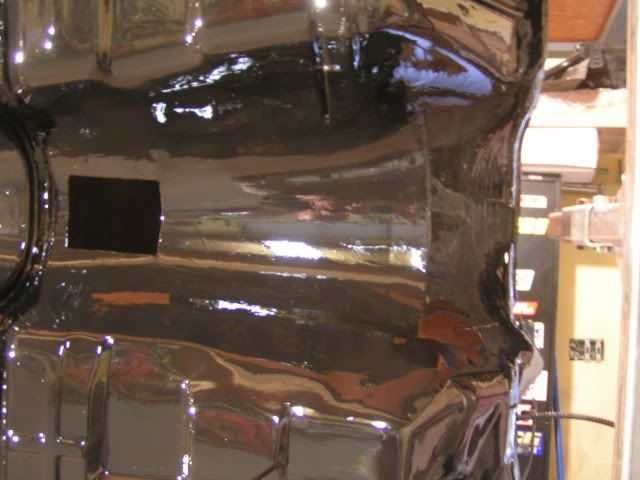

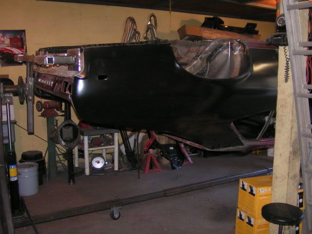

I finished up the undercoating today. I ended up using Hippo bed liner instead of Rhino. It's a two part urethane caoting so it should be pretty good. I know some guys will say to stay away from do it yourself liners, but the paint guy at the shop I bought it from (which I go to a lot) swore by it. He said their store alone sold over 120 kits last year and he didn't have a single complaint about it. The only time he's ever seen an issue with the stuff is when the surface area wasn't prepped properly. The other nice thing was that it usually sells for about $105 a case and you need 2 cases to finish the whole underside. They were having a trade show and I ended up getting them for about 1/2 price. Now hopefully I had it prepped right.
I was going to roll the liner on, but I figured for $25 bucks for a gun, I couldn't go wrong in spraying it. So far I'm pretty happy with the outcome. Next week I'm going to start prepping the subframe so I can get it painted and bolt it back on (finally and hopefully for the last time). I was going to use the Eastwood ceramic paint, then I decided I was going to have it powder coated. Well what a shock, I've changed my mind again. When I went to put the POR15 on the underside of the car, I opened the can I had and found it was hard as a rock so I ended up buying another gallon of it. I barely used 1/2 the gallon to put 2 coats on the underside so I have over 1/2 gallon left. I liked the way the stock subframe turned out with the POR15 so I'm going to do the new subframe the same way. I'll put 2 coats of POR15 and then a coat of the POR chassis coat to help with UV rays. Car masked off http://i222.photobucket.com/albums/d.../PICT00096.jpg Liner is on http://i222.photobucket.com/albums/d.../PICT00107.jpg http://i222.photobucket.com/albums/d.../PICT00138.jpg Close up of the texture http://i222.photobucket.com/albums/d.../PICT00126.jpg |

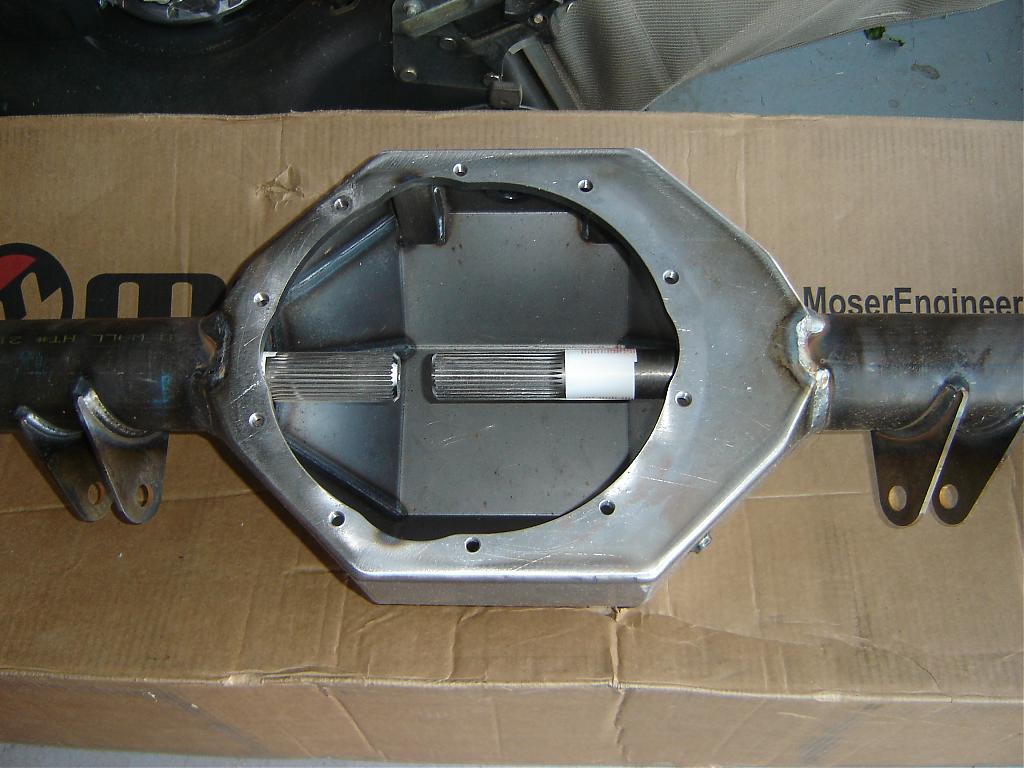

I picked up the subframe and rear end housing from the powder coaters today. It cost me more than they originally quoted me a few months ago, but it included sandblasting, priming and coating so I guess I can't complain. It ended up costing me $480 to get the subframe, rear end housing, motor mounts, trans cross member and c-clips done. I love the way it turned out with one exception, which is my fault. This is the first time I've had anything powder coated and I got so used to how thick POR15 is. POR15 fills in a lot of blemishes and small dents and such. There are a couple small areas where I assumed the powder coating would have filled in, but it wasn't as thick as I thought it was. I wish I would have spent a little more time doing body work on the frame so I wouldn't have the few little spots. But on the other hand, if anyone sees the spots that I'm referring to, I better be at the car too cause they're way too close. Anyways, here's some pics. Hope to start putting some of it back on Friday.
Rear end housing http://i222.photobucket.com/albums/d...9/PICT0073.jpg Close up http://i222.photobucket.com/albums/d.../PICT00742.jpg Subframe http://i222.photobucket.com/albums/d.../PICT00772.jpg Motor mounts, trans cross member and c-clips http://i222.photobucket.com/albums/d.../PICT00752.jpg |
