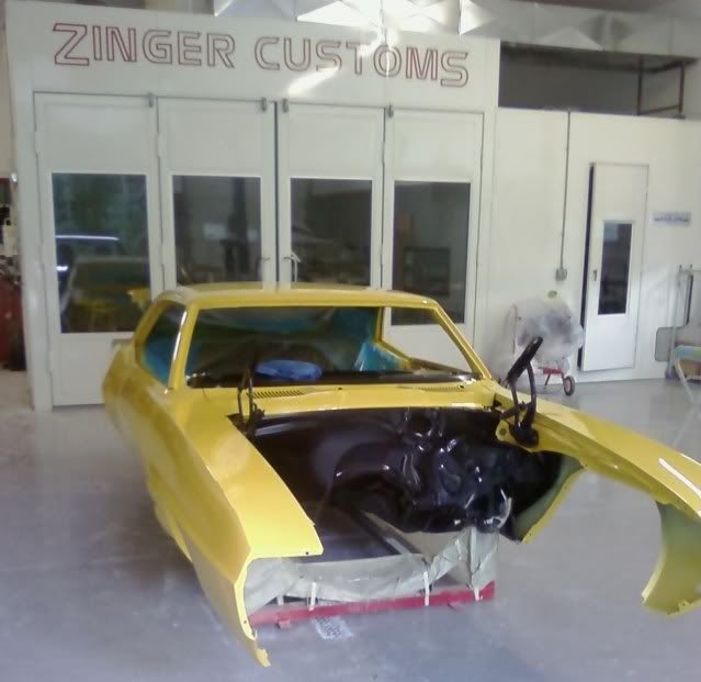

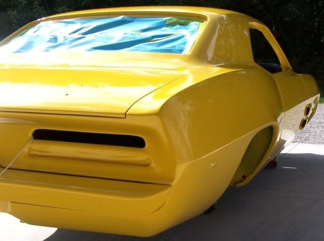

zingercustoms 10-05-2009 04:22 PM
More pics of paint

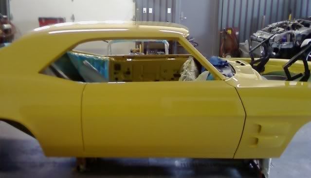

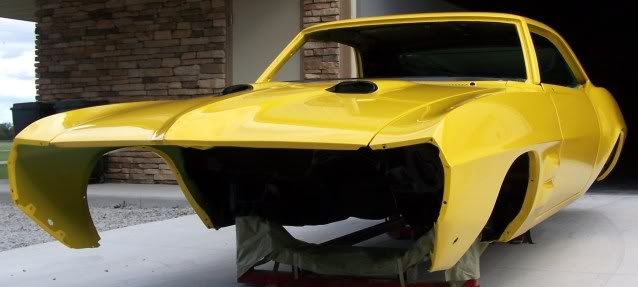

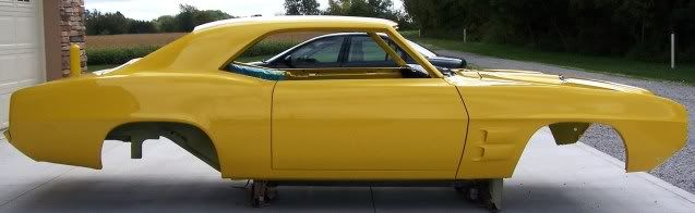

Here is what I did today, tomorrow I will get some help with the hood. I am a one man shop now and hanging doors and fenders with fresh paint by yourself is nerve racking to say the least! Everything looks consistant and line up well so the hood should go good too. I am still messing with the rendering of the design for the stripes on the hood, decklid and hood. I will post more later, thanks for your comments so far. I took these with my phone so they aren't the best quality.
http://i267.photobucket.com/albums/i...1005091759.jpg
http://i267.photobucket.com/albums/i...005091759a.jpg
http://i267.photobucket.com/albums/i...1005091800.jpg
http://i267.photobucket.com/albums/i...005091800c.jpg
http://i267.photobucket.com/albums/i...1005091801.jpg
waynieZ 10-05-2009 05:55 PM
Looks like a good fit.
tones2SS 10-06-2009 05:22 AM
Looking good. Paint still looks wet.:thumbsup:

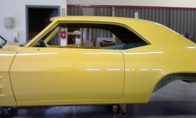

zingercustoms 10-07-2009 07:01 PM

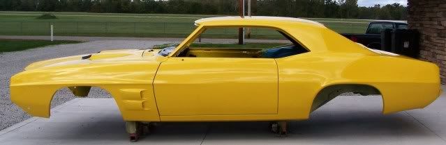

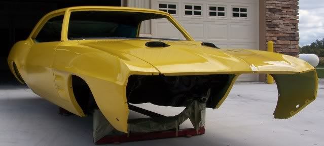

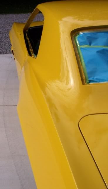

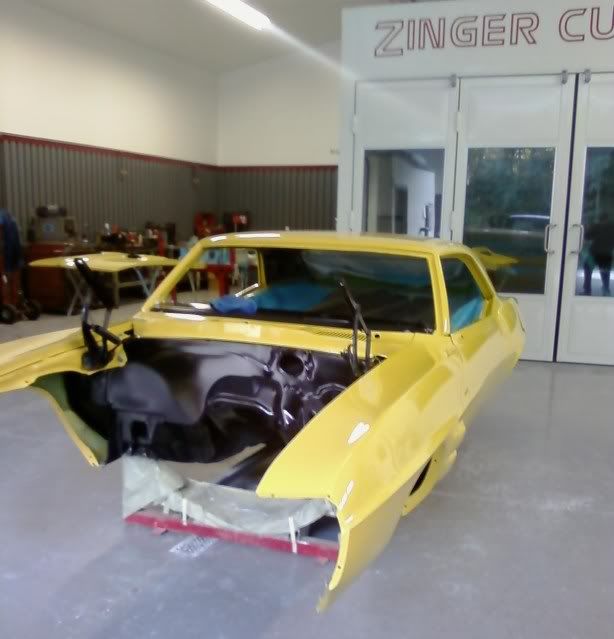

Here are some better pics witht he hood and trunk lid.
http://i267.photobucket.com/albums/i...rcustoms46.jpg
http://i267.photobucket.com/albums/i...rcustoms91.jpg
http://i267.photobucket.com/albums/i...rcustoms35.jpg
http://i267.photobucket.com/albums/i...rcustoms36.jpg
http://i267.photobucket.com/albums/i...rcustoms47.jpg
http://i267.photobucket.com/albums/i...rcustoms82.jpg
http://i267.photobucket.com/albums/i...rcustoms93.jpg
http://i267.photobucket.com/albums/i...rcustoms83.jpg
http://i267.photobucket.com/albums/i...rcustoms87.jpg
awr68 10-07-2009 08:51 PM
Looks great as is! Nice fit, I can tell a lot when into the body work! I TRUELY don't think it needs stripes.........
Will you paint the back side of the fenders and other panels black?

tones2SS 10-08-2009 10:18 AM
That does look really good.
The body of that car looks great.:thumbsup:
zingercustoms 10-08-2009 02:55 PM
Thanks for the compliments, and yes I am going to be painting the inside of fenders and such black with a liner. The car will be a driver so it needs some good protection. As far as the alignment issues with the frame, yes it does affect the alignment after you get your subframe bolted up and especially after you get it on the ground with the engine in it. The gaps are close so I am only assembling it to make sure everthing is cool for now and to see it together for the stripes and for a little inspiration. It makes me see the project coming together. I have had this apart and back together at least 4 times. I will get the front frame mocked up with the front end parts on it in a couple weeks and then I will get it rolling with the front and rear wheels in there final destinations. Then I will break it down and do the scuff, stripes, and more clear. I will have a better idea of the alignment but until we acturally drive it I won't be opening the doors very quickly with out watching the front edge!:_paranoid
One thing I can say is to have the fenders bolted up and have them tight every where so you can do the blockin. Other wise it may have some weird waves and things when you bolt them on and they move in shape. I got that advice from a local pro.
Here is the next evolution of the pic for the stripes.....a little crooked but just for brain storming.
the scoop openings will not be black, obnoxious!
The darker metalic on the hood isn't finished just sill trying to get it the way I want.
The light part is staying that way.

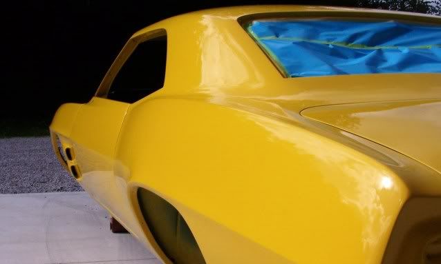

zingercustoms 08-26-2010 08:49 PM
"wild Turkey"

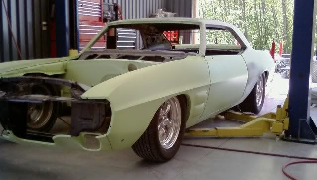

Well, I am back to work on the bird. Haven't touched it for months and now I am in full swing since I have no other jobs. Kinda nice, would like to get this done. I decided on the name "WILD TURKEY" for the build. I know it sounds like many bird related names, fire chicken etc.. But this really fits. Me and my brother are probably the biggest private costumer for Wild Turkey 101 proof. In fact this car was concieved with wild turkey in our hands, on the rocks with water of course...
Seriously tho, my brother buys it buy the case. sips on it every night and has a ward robe of Wild Turkey t-shirts. We even toured the distillery.

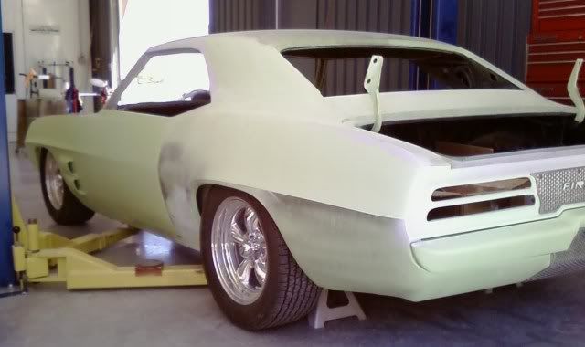

So here is where I left off, mocking up the tires...
http://i267.photobucket.com/albums/i...customsllc.jpg
I know some of this build seems backwards but the ebb and flow of money have caused many mind changes in what we can and can't do, not my decisions.

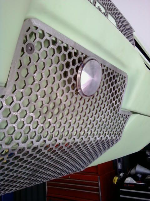

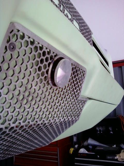

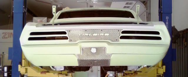

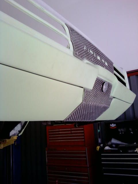

I have started to shape the front end to what I have envisioned. I have always hated the stupid rubber gaskets for the front and the endless adjustments to make it fit, I am building a one piece front now. I will pull a mold off this and make a piece that is part carbon fiber (original bumper) and the rest fiberglass, painted body color. I have some halo/projector headlights and fog lamps to install. I do plan on making more parts off this to sell. Here is the pics so far....
http://i267.photobucket.com/albums/i...g/DSC01273.jpg
http://i267.photobucket.com/albums/i...g/DSC01266.jpg
http://i267.photobucket.com/albums/i...g/DSC01268.jpg
http://i267.photobucket.com/albums/i...g/DSC01272.jpg
http://i267.photobucket.com/albums/i...g/DSC01257.jpg
http://i267.photobucket.com/albums/i...g/DSC01258.jpg

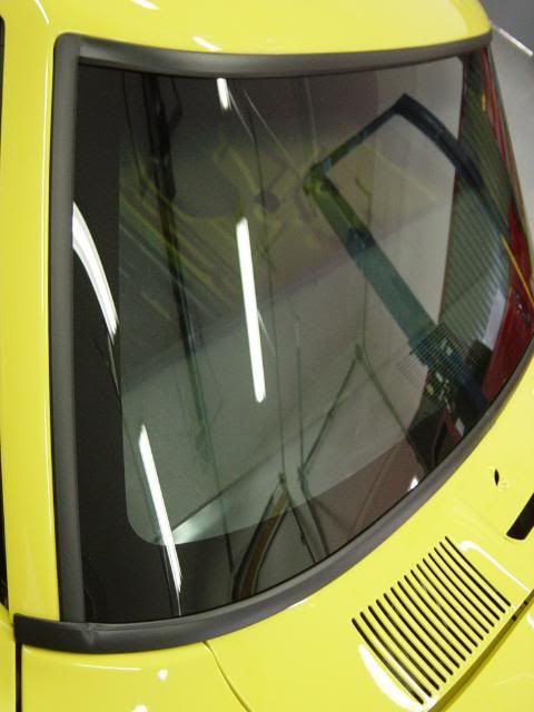

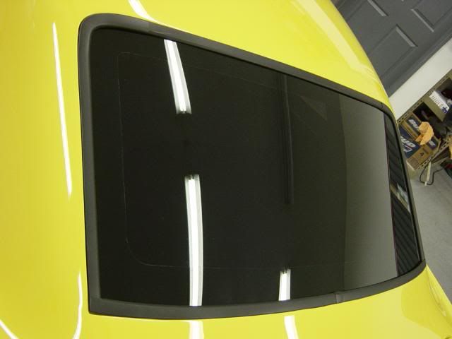

Also I found a way to make the glass have a more modern look. I plan on making all the chrome trim satin black but wanted the windows to be dark on the edges like new cars so the trim doesn't look so stark. I tried and failed to make the black glass primer stick (came of with the tape on the edges) then I remembered something from art class, Etching cream. It gives the glass just enough texture to make the black primer stick better. I did a step by step for any who are interested. I will just illustrate the back window. I went off a new Camaro for reference.
Start by cleaning the glass.
http://i267.photobucket.com/albums/i...g/DSC01275.jpg
Tape off the front side of the glass (part that faces out)
http://i267.photobucket.com/albums/i...g/DSC01276.jpg
Flip window over and start the mask.
I laid out tape starting from the edges to keep the same contours as the glass
http://i267.photobucket.com/albums/i...g/DSC01277.jpg
You can use various sized round objects to get the radius you want....
I went tighter at the top.
http://i267.photobucket.com/albums/i...g/DSC01280.jpg
http://i267.photobucket.com/albums/i...g/DSC01282.jpg
Fine line up against the tape and around the lines you mark
http://i267.photobucket.com/albums/i...g/DSC01283.jpg
http://i267.photobucket.com/albums/i...g/DSC01284.jpg
http://i267.photobucket.com/albums/i...g/DSC01285.jpg
Come inside with wider and wider tape and eventually cover the whole center with tape and paper. I taped over the paper since it would get wet later.
http://i267.photobucket.com/albums/i...g/DSC01286.jpg
Next: pull off the original tape and you have the center nicely masked.
http://i267.photobucket.com/albums/i...g/DSC01287.jpg
You need to use a glass cleaner without ammonia in it, and clean it good, make sure you get the residue the blue fine line tape left behind. Good lighting helps.
http://i267.photobucket.com/albums/i...g/DSC01290.jpg
Etching Creme or paste. I got this at a craft supply store, there are probably other brands out there..
http://i267.photobucket.com/albums/i...g/DSC01291.jpg
Brush on and let set per directions. I brushed it in one direction and went back around and brushed opposite direction. Try not to brush into or under the tape. The radius edges will want to come up, so make sure they are all pressed down good!
http://i267.photobucket.com/albums/i...g/DSC01292.jpg
Wipe off with water and wet rag and clean again with glass cleaner really well.
http://i267.photobucket.com/albums/i...g/DSC01294.jpg
zingercustoms 08-26-2010 09:32 PM
leaves a nice dull coat with some tooth..
http://i267.photobucket.com/albums/i...g/DSC01295.jpg
Here is the primer I used....You can call any auto glass installer and ask for black primer.
http://i267.photobucket.com/albums/i...g/DSC01296.jpg
Mixed 1/1 with acetone.
http://i267.photobucket.com/albums/i...g/DSC01297.jpg
Go back and make sure your corners are down, one came up and I had to fix it. You can see the difference in the clean and etched areas.
http://i267.photobucket.com/albums/i...g/DSC01298.jpg
Tack off
http://i267.photobucket.com/albums/i...g/DSC01299.jpg
Spray on in 2-3 coats with a couple minutes in between.
http://i267.photobucket.com/albums/i...g/DSC01300.jpg
Use heat gun to dry last coat.
http://i267.photobucket.com/albums/i...g/DSC01301.jpg
Peel off tape. Make sure you don't have any rogue etch creme on the stand or on any rags when you take off the back paper. Wipe edges good first and clean back side right away with water just to make sure. I highly recommend having a second stand that is clean and use that to set the window on after you take the tape off, just to be safe.
http://i267.photobucket.com/albums/i...g/DSC01302.jpg
here is the finished product...
http://i267.photobucket.com/albums/i...g/DSC01304.jpg
http://i267.photobucket.com/albums/i...g/DSC01305.jpg
http://i267.photobucket.com/albums/i...g/DSC01306.jpg
killer67 08-26-2010 11:42 PM
Love the OEM glass work - neatness and detail are very apparent :thumbsup: Project name is perfect. :cool:
DOOM 08-27-2010 05:49 AM
Looks good guys!!!! You could of used the WILD TURKEY etch the glass:lol:
tones2SS 08-27-2010 09:12 AM
Nice looking build. I'm digging the glass idea. Very cool.:thumbsup:
waynieZ 08-27-2010 12:03 PM
Great idea and nice work doing it. Thats a good write up.

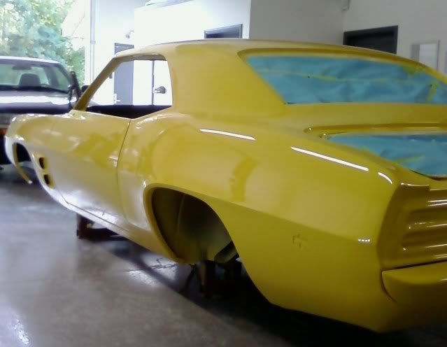

windows in
Well this is what I did today, plus broke the car down and wet sanded with 800 to prep for 4 more coats of clear. Then the star treatment begins on the finish. I tinted the rear window also.
http://i267.photobucket.com/albums/i...s/DSC01311.jpg
http://i267.photobucket.com/albums/i...s/DSC01307.jpg
http://i267.photobucket.com/albums/i...s/DSC01308.jpg
http://i267.photobucket.com/albums/i...s/DSC01310.jpg
http://i267.photobucket.com/albums/i...s/DSC01309.jpg

Great build. I really like the shade of yellow you are using. The attention to detail is nice to see. Awesome work!
tones2SS 08-28-2010 08:01 AM
Very nice.:thumbsup:
Ron Fox 08-28-2010 07:37 PM
Nice work. Killer front end and back bumper. Can't wait to see it complete.
waynieZ 08-28-2010 08:45 PM
Wow nice and dark against the yellow. Nice!

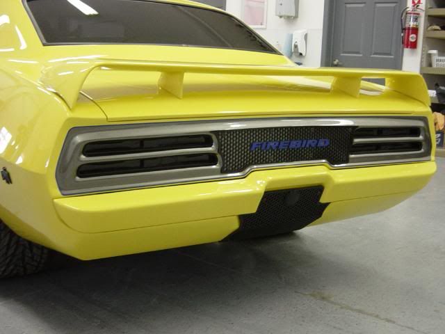

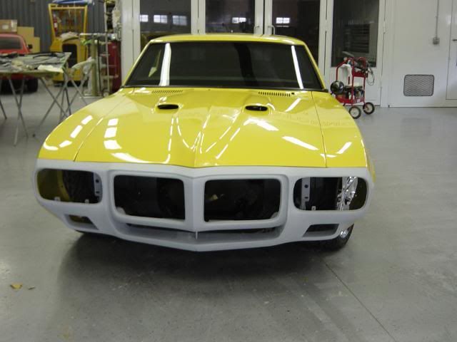

zingercustoms 09-03-2010 03:54 PM
here are the updates, been working around the clock to get done for show, very tired. not as complete as wanted......
http://i267.photobucket.com/albums/i...s/DSC01312.jpg
http://i267.photobucket.com/albums/i...s/DSC01315.jpg
http://i267.photobucket.com/albums/i...s/DSC01316.jpg
http://i267.photobucket.com/albums/i...s/DSC01317.jpg
http://i267.photobucket.com/albums/i...s/DSC01321.jpg
http://i267.photobucket.com/albums/i...s/DSC01322.jpg
http://i267.photobucket.com/albums/i...s/DSC01323.jpg
I will use these headlights but make my own buckets
http://i267.photobucket.com/albums/i...s/DSC01324.jpg
fog lamp down low
http://i267.photobucket.com/albums/i...s/DSC01325.jpg
blacked out all lighs with black candy and clear.
http://i267.photobucket.com/albums/i...s/DSC01327.jpg
http://i267.photobucket.com/albums/i...s/DSC01331.jpg
http://i267.photobucket.com/albums/i...s/DSC01333.jpg

98ssnova 09-03-2010 04:19 PM
liking the detail curious about the headlights do you have a rendering of the final product??:cheers:
zingercustoms 09-03-2010 04:25 PM
I have a rendering in my head....also i have only finished the doghouse and doors, the front of the car has not been touched with sandpaper or buff. Oh yeah, we got our engine, i will post on monday. LS2 2005 GTO, auto tranny....er...paddle shift in the plans..... Also axle is moser 35 spline with detroit locker and 389? gears, I am a body guy not a mechanic.

It's looking really good, how did you paint the flat black window trim/what materials?
Thanks.
Vince@Meanstreets 09-03-2010 11:03 PM
Thanks.
starts at post 57
looks great
tones2SS 09-04-2010 08:51 AM
Car looks great man! Nice job.:thumbsup:
I'm not sure how I'm feeling about those headlights yet?? I may change my mind once it's complete?:_paranoid
zingercustoms 09-04-2010 12:55 PM
blacked out trim
Scuff with red scotch brite pad. Then I shot with ppg Dp90 black epoxy primer and then look over after dried for dust nibs and such. If it sat for more than 24 hours I scuffed with grey scotch brite and then tacked off. I used SEM trim black. You can get this in spray cans but it will not look as good. I got it in a quart from my paint supply store and mixed it with centari reducer. Any good quality laquer thinner will also work or you can hunt down the SEM reducer recommended on the can. I also wanted to say that soon the plug will be finished for the front and we will be making the mold. I say we cause I have help in the final stages of this from a very experienced fiber glass mold maker, Terry Delong. Google him and you will see his work all over. He has built multiple sema vehicles and even made the body kit that is on Sammy Hagars red rocket mustang. He helped me get ready for the show this weekend, was there until 3 am friday morning, awesome guy. So I know this front end will turn out just right.
