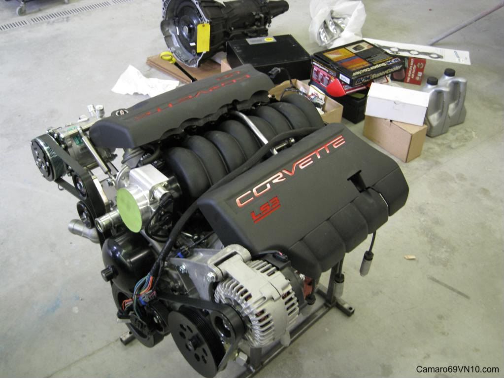

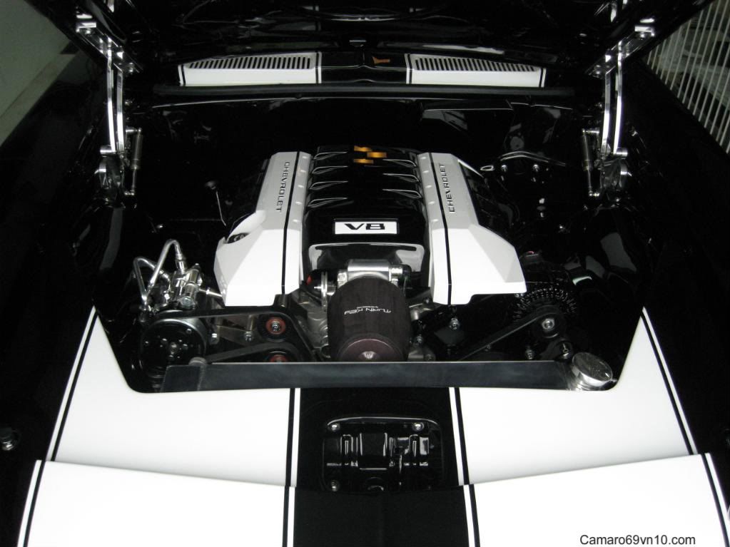

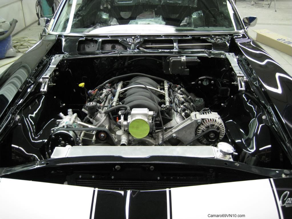

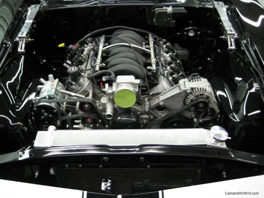

markd 03-24-2010 05:48 PM
Originally Posted by Wayne S (Post 277480)
So what engine did you decide on?
I went with an LS3 (565hp) from Turnkey Engine Supply. I posted a few pictures below. I will be shipping the car to Prodigy Customs next week to have Frank and crew finish the electrical, plumbing and interior.
http://i254.photobucket.com/albums/h...0/STF_2419.jpg
http://i254.photobucket.com/albums/h...0/STA_2538.jpg
http://i254.photobucket.com/albums/h...0/STC_2540.jpg
http://i254.photobucket.com/albums/h...0/IMG_2696.jpg
