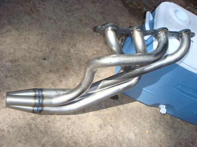

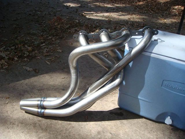

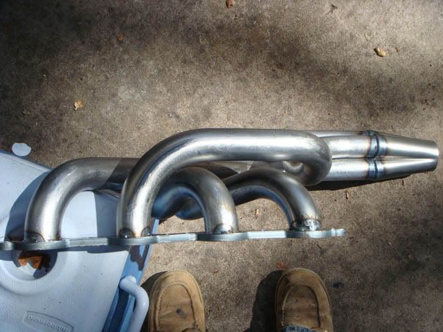

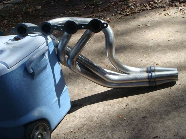

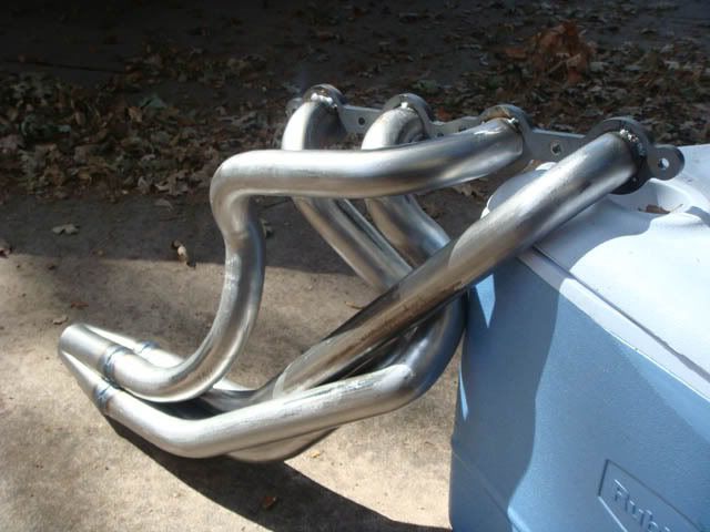

Finally got the passenger side header done. It has a slightly different design than the drivers side header. The reason for that is because there is less room on the passenger side because of the starter. It made it more difficult to design but a little easier to build. I still have to finish welding the primaries to the flanges but needed a little brake first. Anyways here is some pics and hopefully tonight or tomorrow i can get the rest of the exhaust built underneath the cab.

awr68 10-04-2008 03:46 PM
They look great! You will be very happy you decided to build them!
Chad-1stGen 10-04-2008 05:15 PM
Sick headers! Those things are sexy

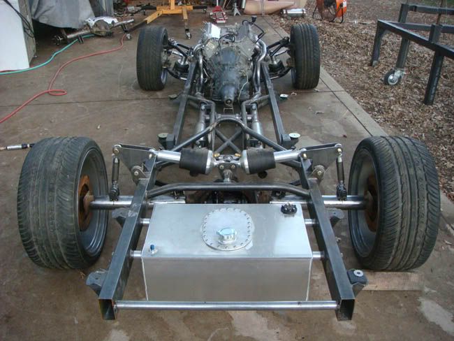

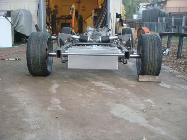

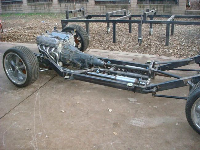

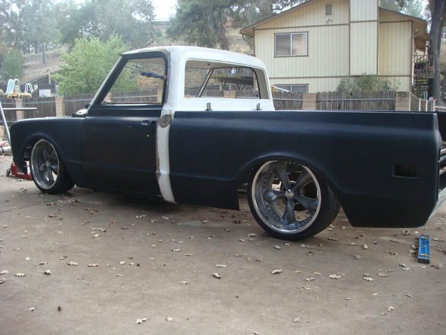

Well i finally got time to take the frame off the frame jig and get it outside. I wanted to see how everything looked and I had to replace the rear end with a pre 69 so my wheels would fit in the bed. Everything lined up perfect. Wheels are centered in both front and rear fenders, all of my bed mounts were really easy to line up and bolt together. I am stoked. Now i was going to figure out how i am going to run the rest of the exhaust. I am hoping to make a custom exhaust fitting that matches the contour of the rear roll pan. I also remade the gas tank and this time i ran the solid alluminum bracing all the way from side to side. Much stronger overall. I still have to weld the top cover part to the gas tank but left it unwelded until I figure out a clean way to run the electrical into the tank for the pump.

fesler 11-24-2008 09:07 AM
Looking sick, nice stance I think you nailed the look and nice work as well.

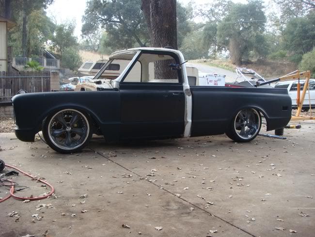

Well i couldn't resist, I grabbed some nitrogen and aired up the truck to about ride height. Man i can't wait to drive it!!!!!!

Garage Dog 65 11-24-2008 03:49 PM
Perfect !!

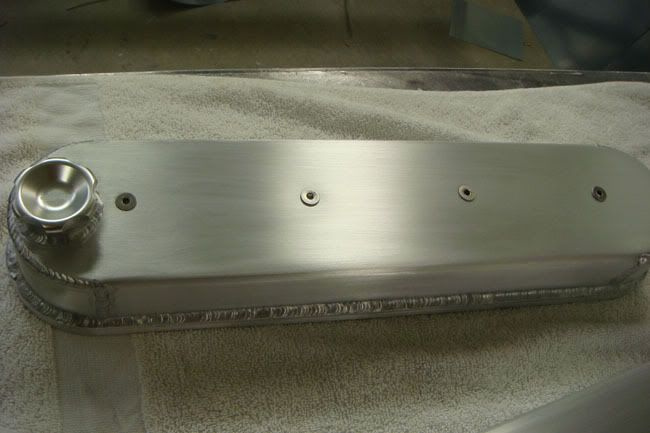

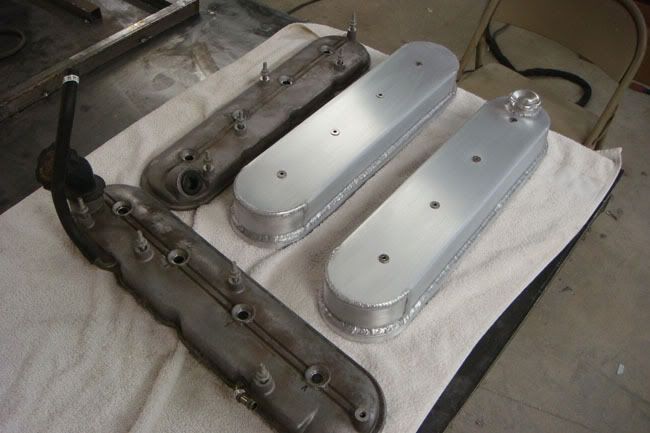

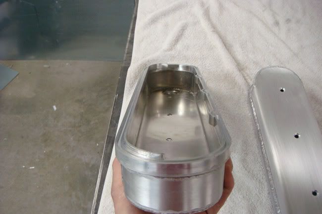

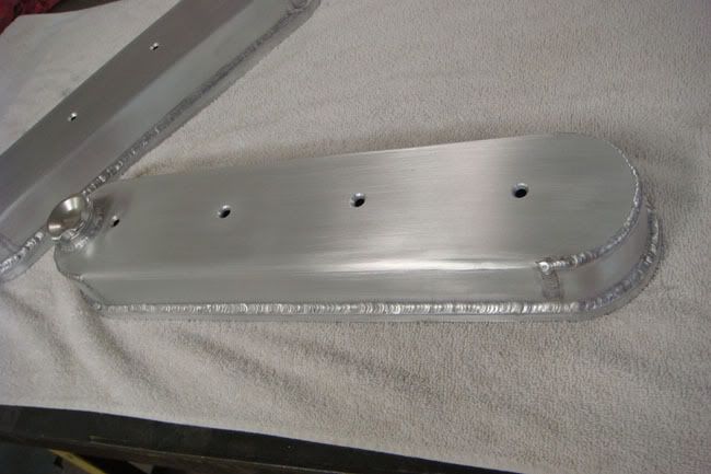

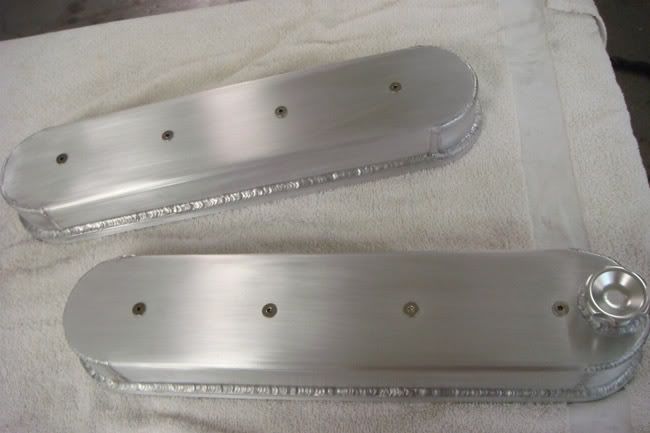

Well i finally got something done on my truck. I was hoping to move the truck to the shop but because of the weather i couldn't do it. So i built some alluminum valve covers for the truck. I am pretty happy with the overall turnout. I do wish that i had a little more steady of a hand because those long straights were a litte tough to get a consistant looking weld. I had a lot of fun building them. I still have to build the splash gaurds for the PCV and weld on the bungs for the PCV. I read that alot of people use an-10 for the pcv but was curious if it would be bad to us an-8 instead. I am going to buy a 1/2" tubing bender for all my fuel lines and would be nice not have to buy a 5/8 just for the PCV. Anyways here are some pics

G-Body 01-27-2009 04:08 PM
Auto Jewelry!:thumbsup:
way niceeee and the all this on my favoraite year of truck rock on brother!
