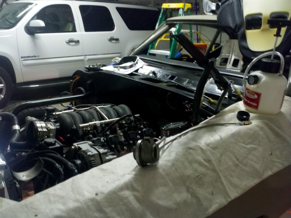

When I went to bleed the clutch I noticed the braided line leaking inside the bell housing. I am using a RAM hydraulic bearing and I was not aware I needed to use teflon tape on the bearing side. The whole hydraulic clutch is new to me so live and learn. I was also concerned that clutch was rock hard.
If I opened the bleeder the pedal would sink down to the floor. I am thinking the spacing was off but checked that tonight and I think I am good. I will check more tomorrow.

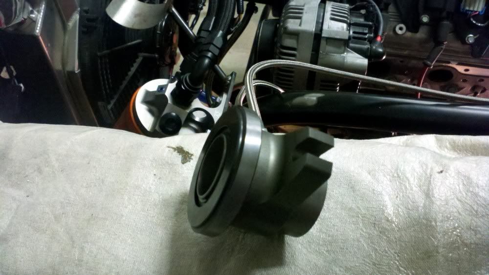

Here is a pciture of the bearing relaxed
http://i186.photobucket.com/albums/x...perf/20114.jpg
So since pulling this thing is a big PITA I hooked up the bearing and bleed it with the Motive pressure bleeder
http://i186.photobucket.com/albums/x...perf/20112.jpg

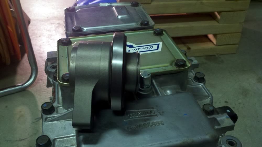

After bleeding I pressed the clutch in to be sure it was moving. I am also concered of over extending so I may need to add a spot on the pedal.
It moved out:
http://i186.photobucket.com/albums/x...perf/20113.jpg
I figure I can also check for more leaks.
*Here is where I am confused. I pumped the pedal and it extended till the pedal got hard. Any additional pressure by my foot would likely damage the bearing. Should the pedal remain hard at this stage?? Does the pressure plate help return the pedal all the way up thus reliefeing the had pedal?
I must be missing something so any feedback would be helpful.

ironworks 01-02-2011 08:30 AM
If im understanding your story. Your master sounds too small.
Tom.A 01-02-2011 10:08 AM

Roger, I did not explain very well. When I had the trans in the car and bleed the clutch the braid line leak was very little (bigger puddle over night) so the pedal still became hard after I pumped it however never would release. Now trying it with the trans out it seems to be doing the same thing. Assuming the spacing on the bearing is correct would the pressure plate return the pedal when I release the pedal? I think I have the correct master as it came from the Hurst/Classic 5 speed kit. I will try and call them tomorrow but was hoping to put it back in Today.
Thanks

ironworks 01-02-2011 12:47 PM
So when the pedal became hard, was the clutch fully disengaged. I had to pull the trans in my camaro race ca few times to get the spacing just right. Then you have to set a stop so you don't over extend the throwout bearing. Sometimes I wonder how exact those after market bellhousings are. Just a bit more depth can change everything.
GregWeld 01-02-2011 07:45 PM
I've installed two of these. They are very specific about spacing. If you've ever driven a new car with a hydraulic clutch... The description would be "silky smooth" or "like butter".... But you'd never hear "rock hard".
My guess is that you have "something" wrong. So don't button it up until you're certain of the operation.
ironworks 01-02-2011 07:51 PM
That's why I thought he ran out of master cylinder travel. If the cylinder is too small you may not move enough fluid to get the bearing to release the clutch. Just because they said it would work does not mean that you were talking to a sales person who knew what they were talking about. Plus having to pump it up leads me to believe it is too small also.
But I'm wrong alot, So who knows. When they work right they great. But sometimes getting it there takes some work. I love the clutch release smoothness and the height now. I hate low release clutches.

Rodger/Greg, thanks for the feedback. I think it must be in the spacing. I just did not have time to measure Today. I still think I am not good at putting the problem into words. I did not have to pump the pedal to get movement. I was speaking about pedal being hard and if I open the bleeder I could pump the pedal then. I believe the bearing never fully engagded the clutch fingers.
With the bearing out I was able to get the movement of the bearing with one step on the pedal and was wondering if the pressure plate overcomes the bearing thus returning the pedal from the floor because it remained hard. It seems logical that the pressure plate should return the pedal linkage? I will report back when I get info.
Thanks,
GregWeld 01-03-2011 08:05 AM
Tom
Since there is ZERO resistance on the hydraulic bearing with it being "out" of the car - there should be ZERO effort on the clutch pedal.
There is something going on there and my thoughts are it isn't the bearing -- I'd be looking at the pedal etc.
Try disconnecting the bearing -- or have someone hold a pan under your bleeder and then depress the clutch pedal - check for binding etc. Better yet - disconnect the pedal from the M/C and actuate the M/C by hand to see what it feels like. I'm betting your pushrod is too long and you're bottoming out the M/C giving you a "hard" clutch pedal feel. Sounds to me like there's a problem that is not really bearing related but in the pedal / M/C area.

So I pulled the transmission out and measured for the TOB again.
I came up with 3.08" from face of bell to high point of the clutch fingers.
The TOB on the spline compressed measured 2.47" from the bearing face to the mounting face on TKO so that left a delta of .610". I originally had only three concial spacers which are .100". I added another one which gave me a total of .400" or a .210" gap. The Classic Motorsports instructions indicate it must be a min of .125" gap to max of .225". Put the trans back. I now have a clutch feel. I pulled it out under it's own power which was cool, but the thing does not go into any gear easy running or not running. I did some searches and seems Tremec had some issues a few years back with shifter lug tolerances. I don't know if that is the issue or not or not but IIRC I bought mine back in 07. I was thinking clutch engagement is still off but don't know yet. I seem to recall trying to shifting it on the floor out the car a long time back and thinking it was harsh and not defined.
