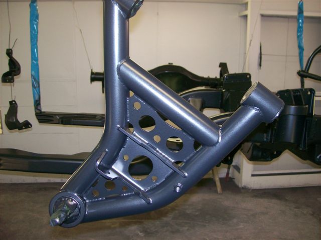

that doesnt look mig welded... is that some sort of mig "brazing" no splatter and golden shine to weld??? perhaps i just need to get my eyes checked..

The shock crossmember is mig welded, everything else is tig welded with sil bronze
Just a question about the silicon bronze. I've seen this used before and have done a little research. Are you just using this on the parts that you don't deem structural? It sure makes pretty looking welds. I thought I had read somewhere that it makes a weaker weld and shouldn't be used on structural joints.
I'm just curious - trying to learn.

Correct. Non structural- sheetmetal. Like you would not want to use it for welding the subframe to the subframe conectors or welding together a roll cage
